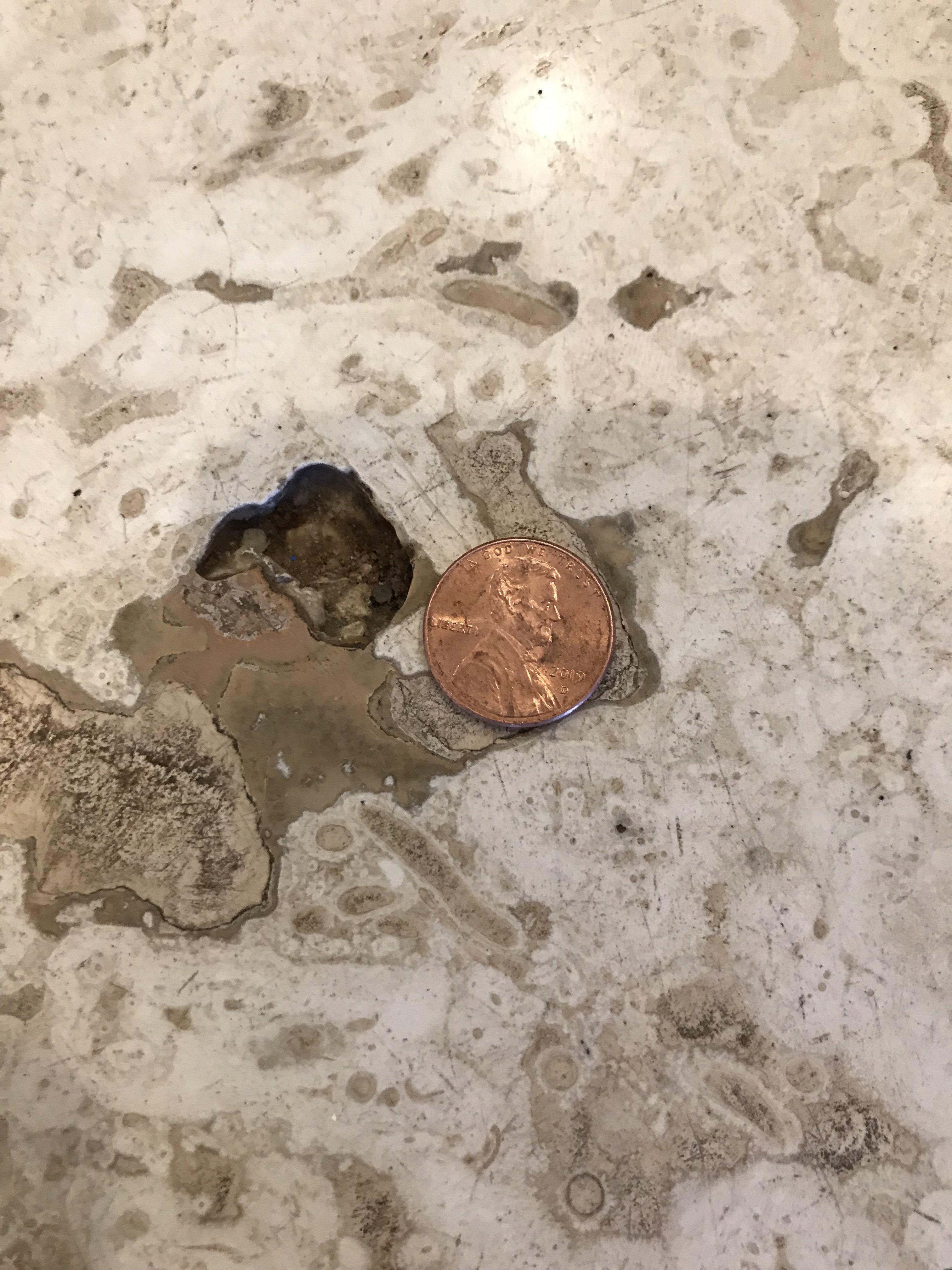

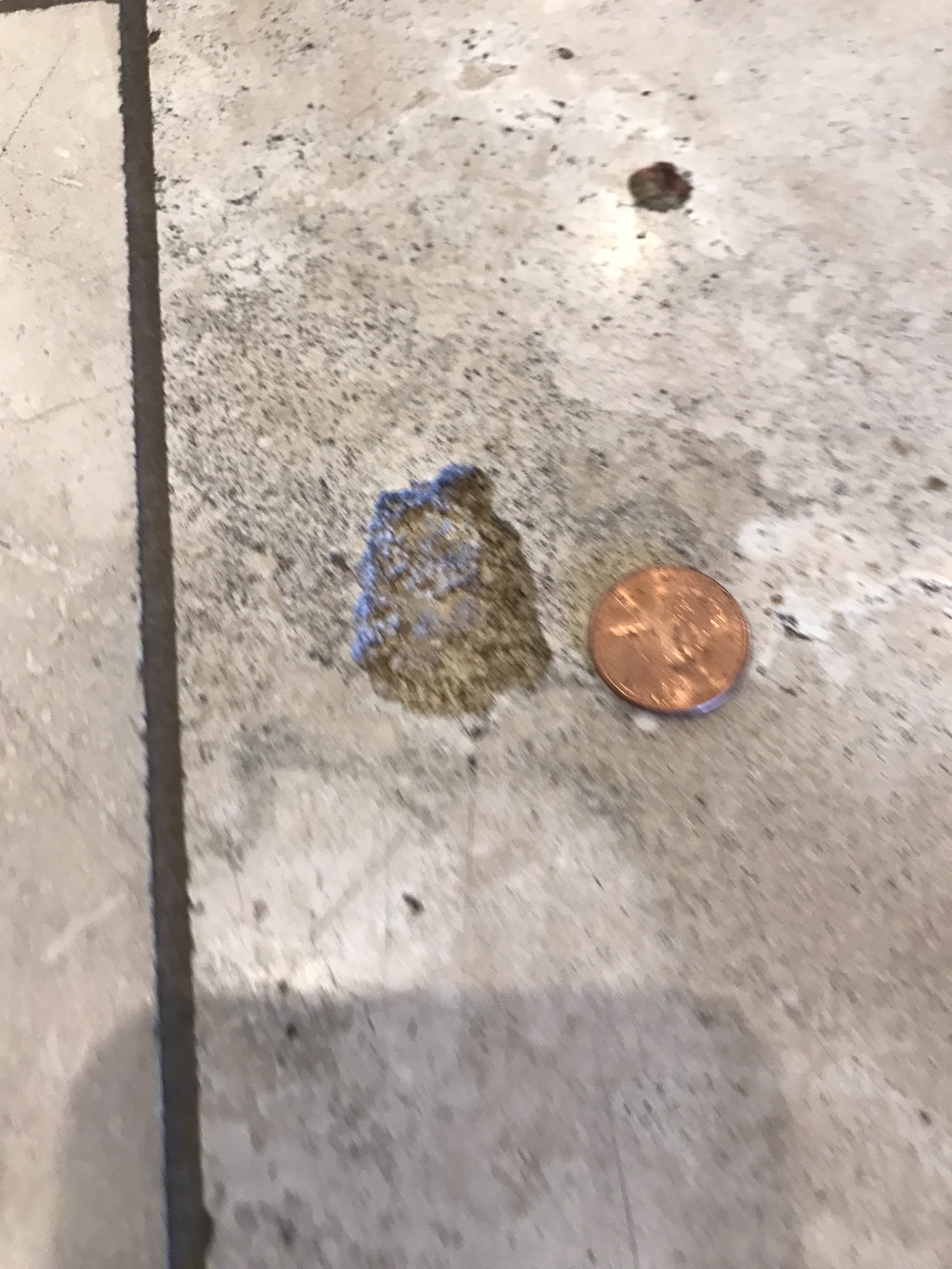

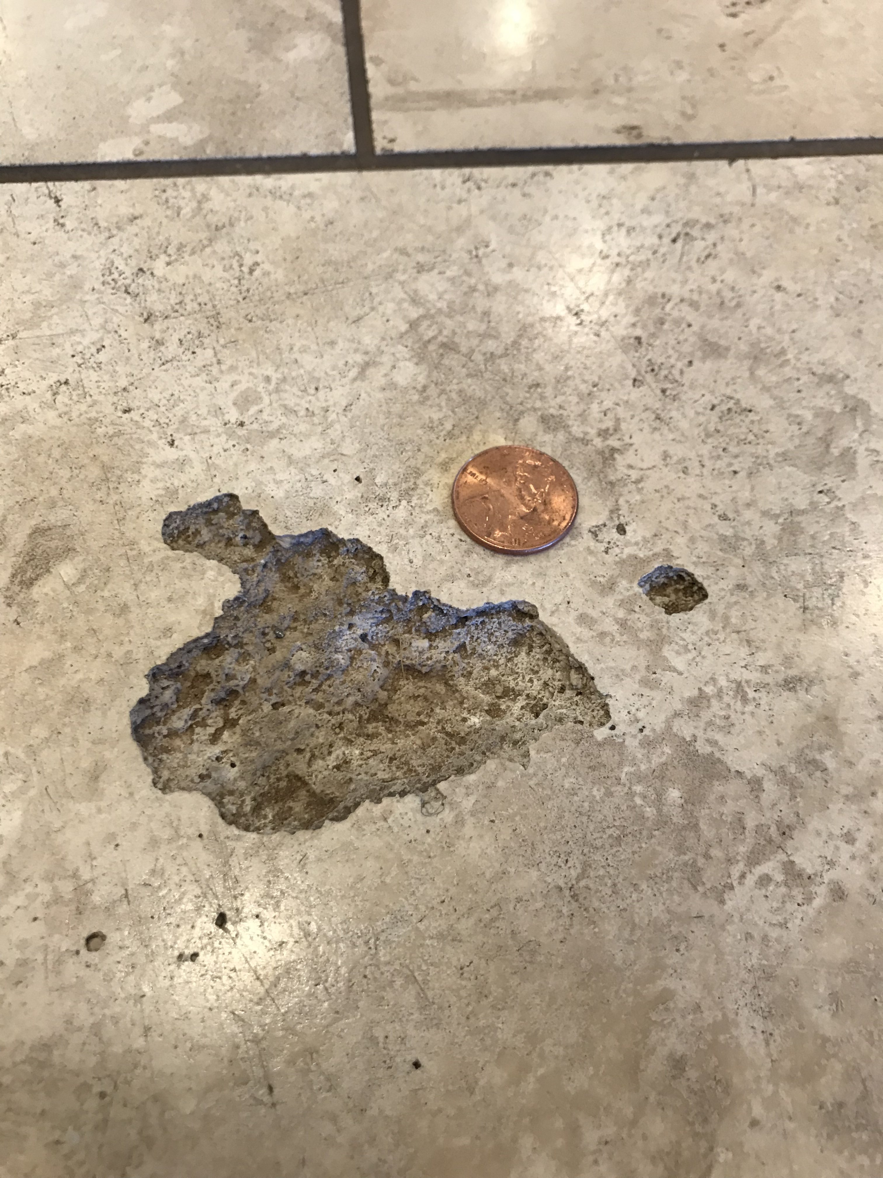

Oct 17, 2019 #1 Zion Carpet Cleaning Member Joined Aug 3, 2016 Messages 191 Location Salt Lake City, UT Name Eric I’m going to be cleaning this travertine soon and there are several decent sized chips in it from things falling down the stairs. Are there any good products that can fill them somewhat easily and be durable?
Oct 17, 2019 #2 Mikey P Administrator Joined Oct 6, 2006 Messages 115,977 Location The High Chapperal Two choices, unsanded grout or color matched epoxy
Oct 17, 2019 #3 Mikey P Administrator Joined Oct 6, 2006 Messages 115,977 Location The High Chapperal Stone Pro Traverfill - Travertine Hole and Void Repair - 3 Pound - Light Amazon product
Oct 17, 2019 #4 clean image Member Joined Oct 5, 2012 Messages 970 Location Orlando Name Carl Maddock Tenax. A polyester ( epoxy) For best result Cementitious grouts and traverfill will work also Color match
