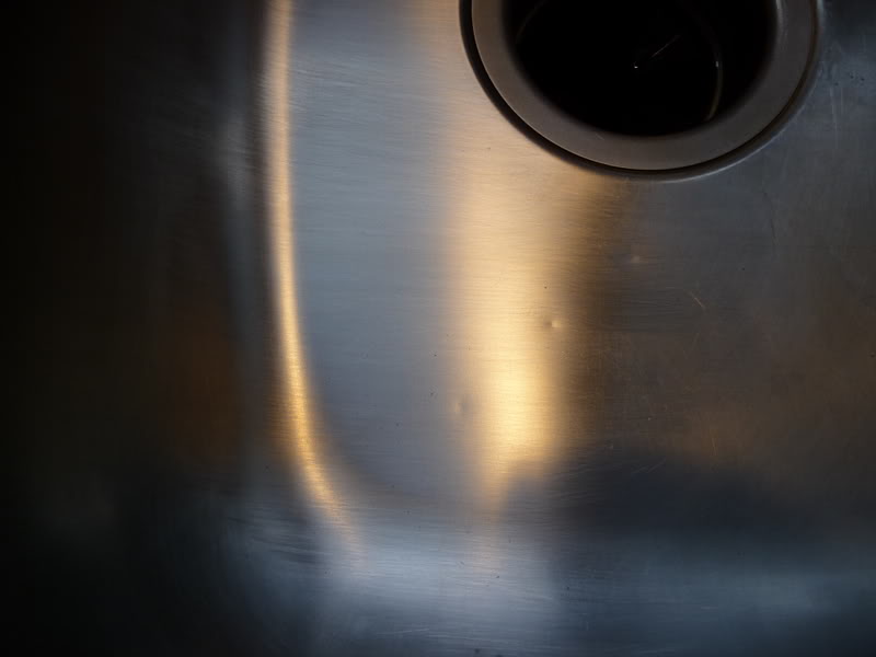

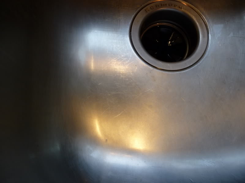

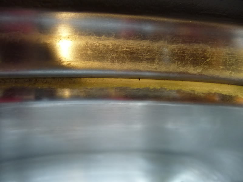

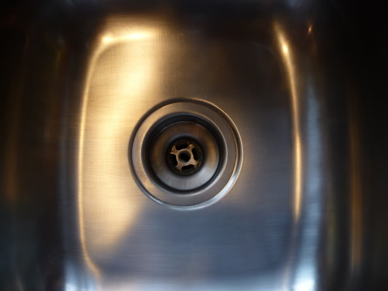

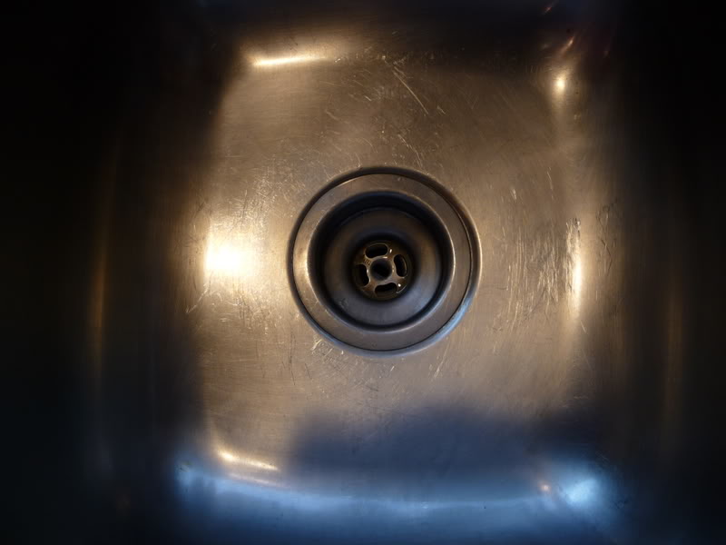

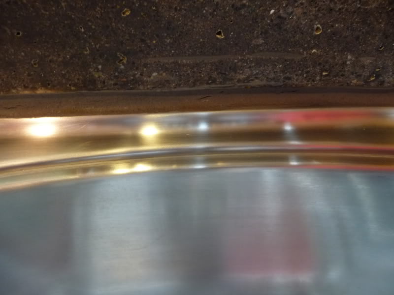

Our SS sink has gotten pretty caked/scratched/oxidized so I whipped out the 3 included abrasive pads, oxidizing/cutting fluid and pad holder and went to town.
Right side sink before
After
Left side b4
After
Edge b4
After
I'd like to learn some tricks for dealing with all the curves and change in direction of the grain on a sink.
Hopefully they cover it at MF.
I also worked o a small scratch on my SS fridge.
The original grain was finer then the finest pad in the kit would duplicate. Looks better but not quite perfect. Trying to mimic the grain on a large panel like a fridge would be easier with a jig of some sort to hold the pad straight.

As a rookie to this process I can already see that pre qualifying the results will be mandatory.
While huge improvements can be made I'm not sure an exact match to a factory grain will ever be possible when doing a spot on a large surface
I would guess whole panels would have to be done for consistency and by using hand tools the grain will not be as perfectly straight as what can be done by a machine, obviously.
Truly anal customers will be a bitch to deal with.
My wife was pleased with what I accomplished though

Try steel wool for corners and odd edges. What does the paste smell like?. I got good results with brasso and assortment of floor pads. I think Fon mentioned the steel wool for deeper scratches.

I think it looks good. I know a lot of customers that would be really happy with those results. I just would get the customers to not expect it to be perfect and think many of them would be happy with that.

And yes, you are scratching the metal. You are putting a new or restoring the old scratch pattern. Just like you do in wood and completely the opposite of what we do on stone.

let's see if i have a handle on it, you're sanding the contrary direction scratches out and getting them going in a uniform direction with the fine scratches (for lack of better term) of the finish ?
