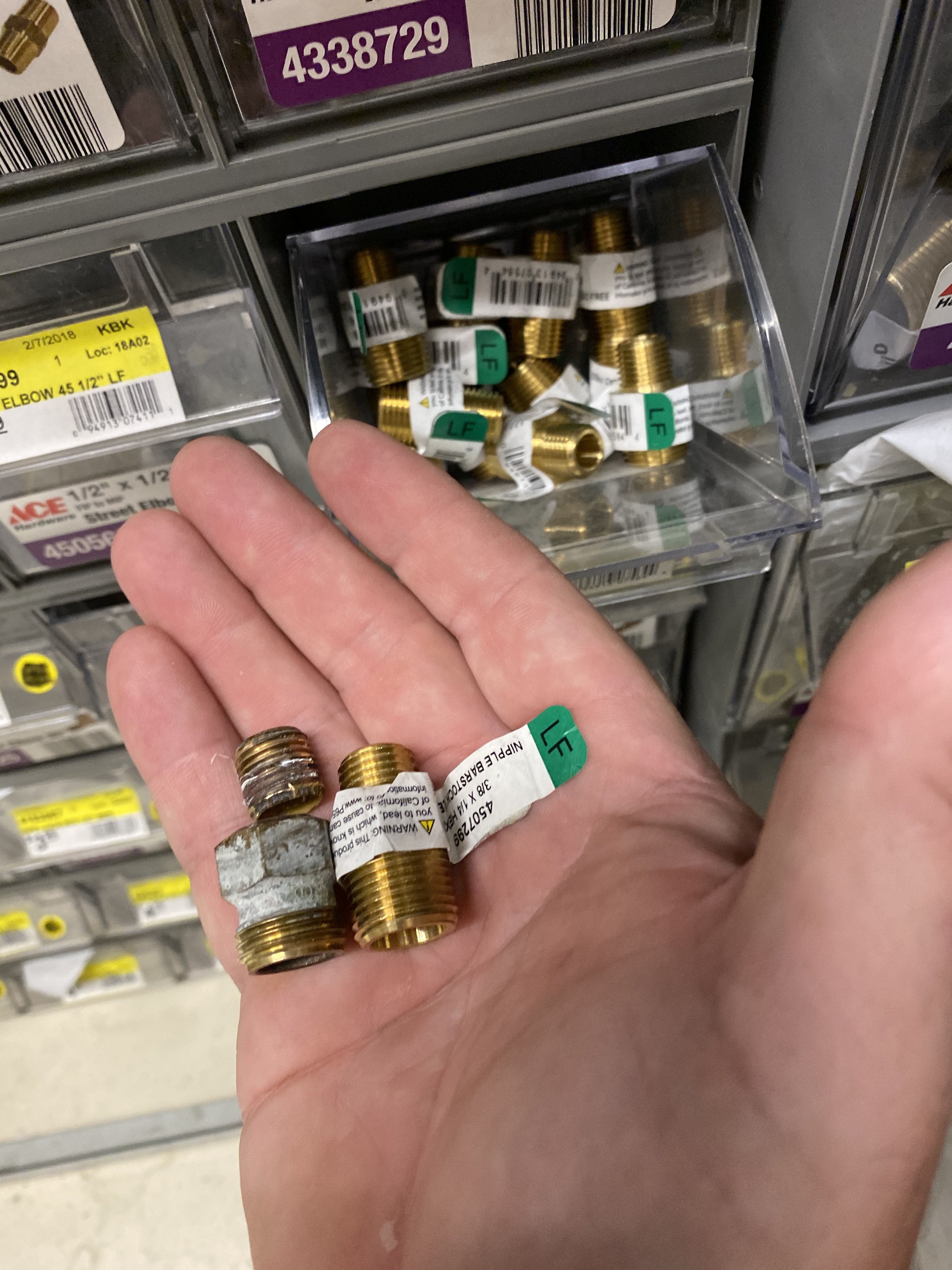

You can take the ends to ace hardware and figure out the difference. They have a board with all the firtings. You can digure out if its MIP or whatever.you can also probably get all the fittings you need to make it work.
