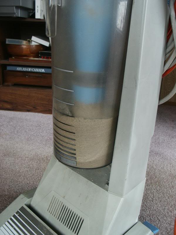

AS for my dirty machine, I use it because it removes the soil, and it does that exceptionally well. Some how I think all the hype over what I "might" be bringing in is like the mold hype from years ago.
Ron Werner
8,726
Ron Werner

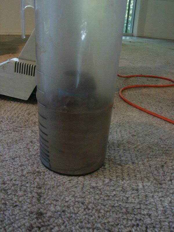

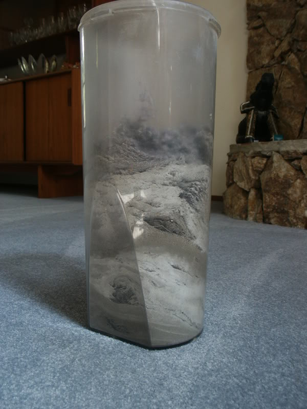

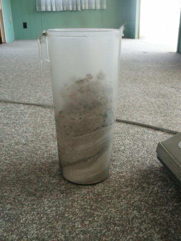

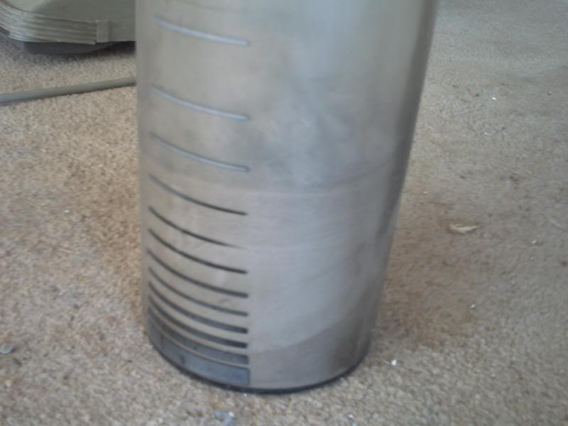

Kevin P said:

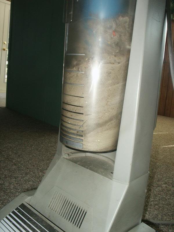

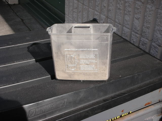

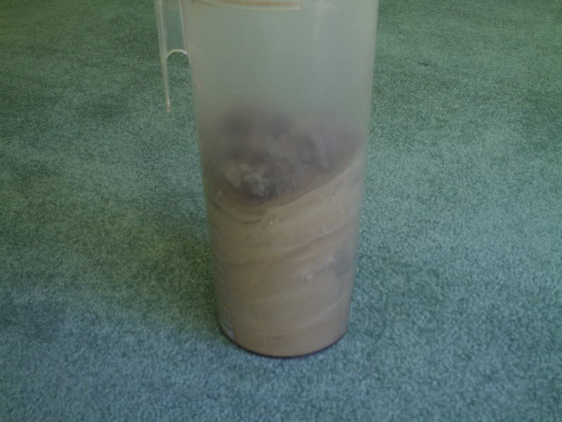

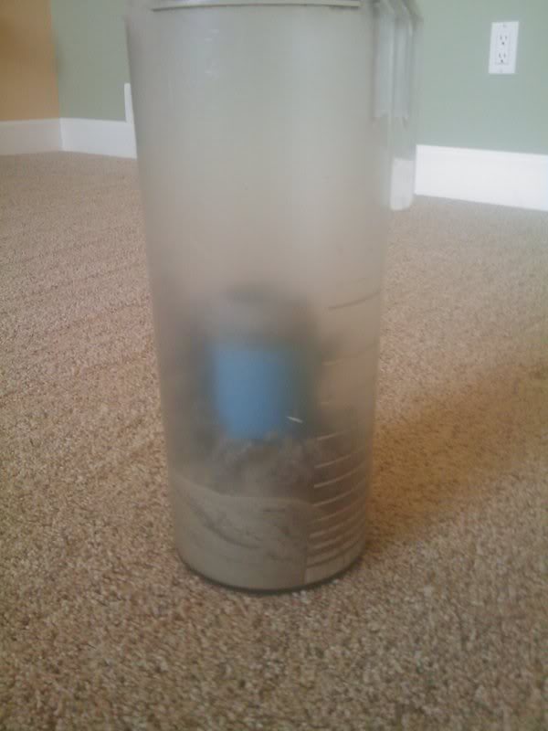

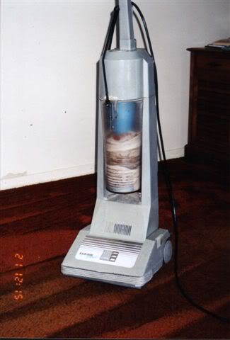

Ron,that person or persons you get that crap out of are the ones that Do Not vacuum enough period.You can give a guy the best equipment there is and still do a crap job.So put blame where it belongs,to lazy people not vacuuming.Oh and teach you're clients the importance of frequentcy or you are doing them a disservice.

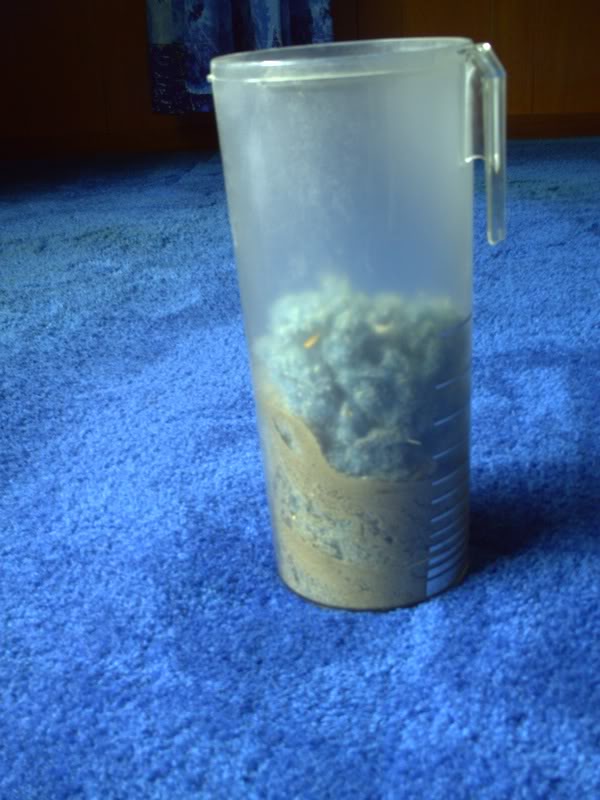

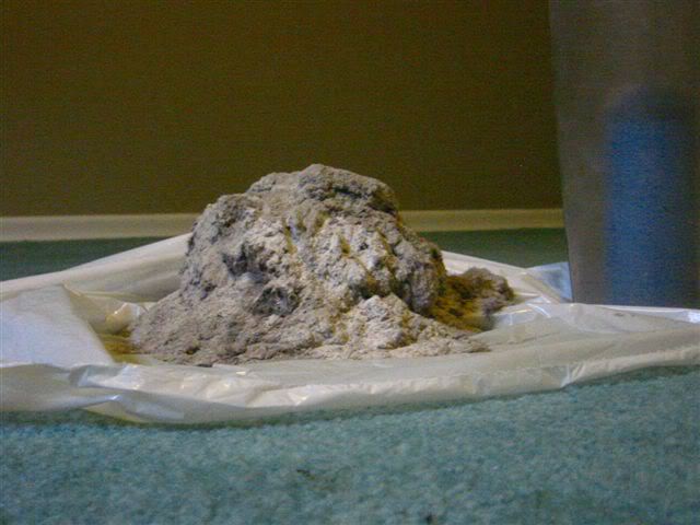

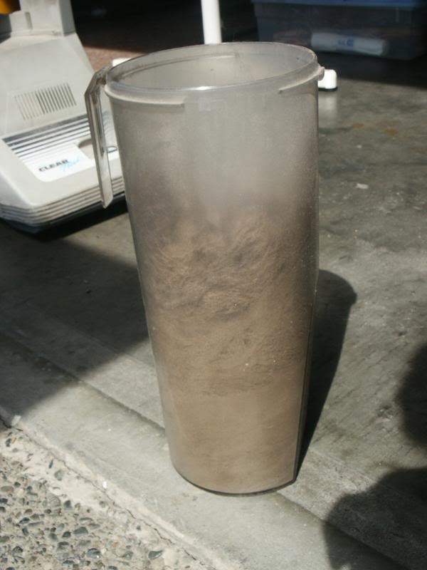

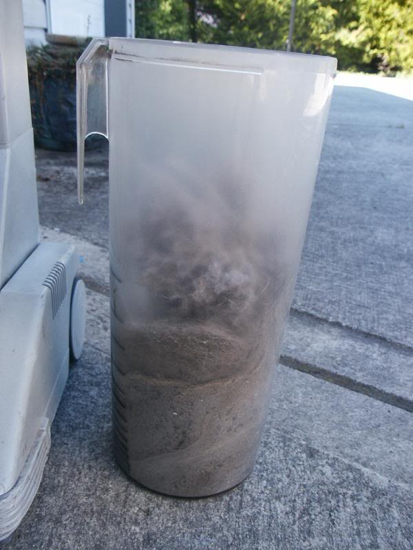

Most of those pics are from well kept homes, not trashed places, where the client has vacuumed before I arrived.
Keep bringing the excuses, haven't heard anything new yet.
If you don't want to prevac, just acknowledge that you are not removing all the soil that you could. When you've finished and the job looks great, you're only guessing that you've removed the soil.
