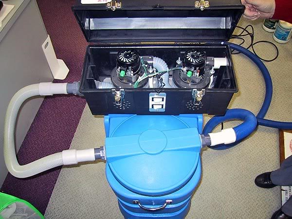

I want it all.:icon_cool: I'm going to order one of these to crank it up a bit more: Gotta have it! And only one more cord,,,,
http://www.***************/clean-storm-universal-vacuum-booster-p-4832.html
27,862
Only problem is, does it have a filter/shut off ball or equivalent. Otherwise, it may be blowing dirty water/foam out the exhaust. I was contemplating doing the same for one of my old ninjas. Just cut a hole in the lid and mount a 3 stage vac with a filter ball float in the middle and plug it in.
Vancouver
Ninja vac booster? Simple toolbox unit. Suck dust off the moon.
I've seen that before, actually made one that attaches to my exhaust. Just thinking it would be simpler to drill a hole in the center of the lid and install a 3-stage on top with a ball filter below. Maybe build a louvred cover for it so it looks nice. probably need to replace the 1 1/2 in fitting with a 2 inch to maximize air flow. I need to get a replacement lid so I can experiment.
