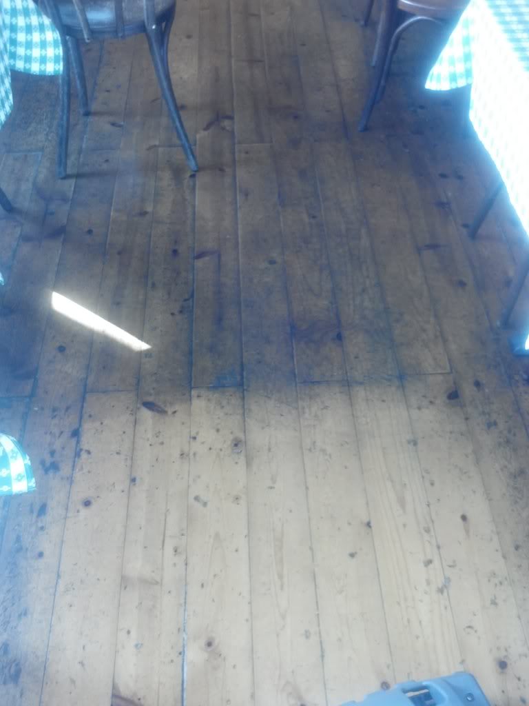

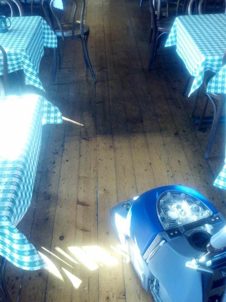

Did a free test at a popular sammich shop today.
night and day.
The mop water residue was so bad it was like they were mopping with brown wood stain.
The Dirt Dragon got some off but I had to whip out the 175 the break it all loose and then rinse/dry with the DD.
The Basic chems work great just not sure how cost effective they are @ a 4 to 1 ratio.
I'ts maxing how well the machine rinses and how quickly it drys the floor. Very little chance of over wetting.

well its a clean ******* pine tree now and they are going to pay me a buck a foot to clean and apply a one coat sealer.
Thats a lot of sandwiches!

You Spruced up that Pine.... :lol:
Yeah, I'm sure the demo in the middle of the walkway pretty much sold the rest of the place.
Manager did not come out and say " ever heard of the saying, "test in an inconspicuous area 1st " "?

The owner picked the area to test.

That’s impressive 8) .
I know that pine must have allot of deep scratches and gouges you cleaned out.
Pine looks amazing after good sanding and refinish but it takes on a rustic look fast. A satin finish might be the way to go.
