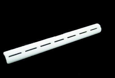

I don't know who makes this one but it is similar to my slotted(I have the hybrid as well) Point out where there is more cleaning area than an unglided wand floorguy. I see 20-30 or % of that covered. Now I look at it it is probably over 50%

Just a note: Glides Do Not increase agitation. You always lose agitation with a glide. More so with a hole, less so with a slot. However that is generally easily compensated for by the positive qualities of a glide.

So Greg is saying if you reduce a wand's vacuum slot by half, you are somehow reducing it's cleaning ability?
Jez....Crowley, I thought you were brighter than that.
G'head do as you choose, it's your body.
truckmount girl
1800greenglides
8,880
Sun City, CA
Lisa Smith
You need to read the Ameteck/Lamb charts. reducing the orifice size increases air watts and velocity. That's why HM's high efficiency skids are half the slot size as the old skids. This phenomena is more pronounced the smaller the machine. The difference in recovery on a small porty between a hole and slot will be significant, on a Vortex it will be negligible.
What you lose is DEBRIS REMOVAL capability by making the orifice smaller.
