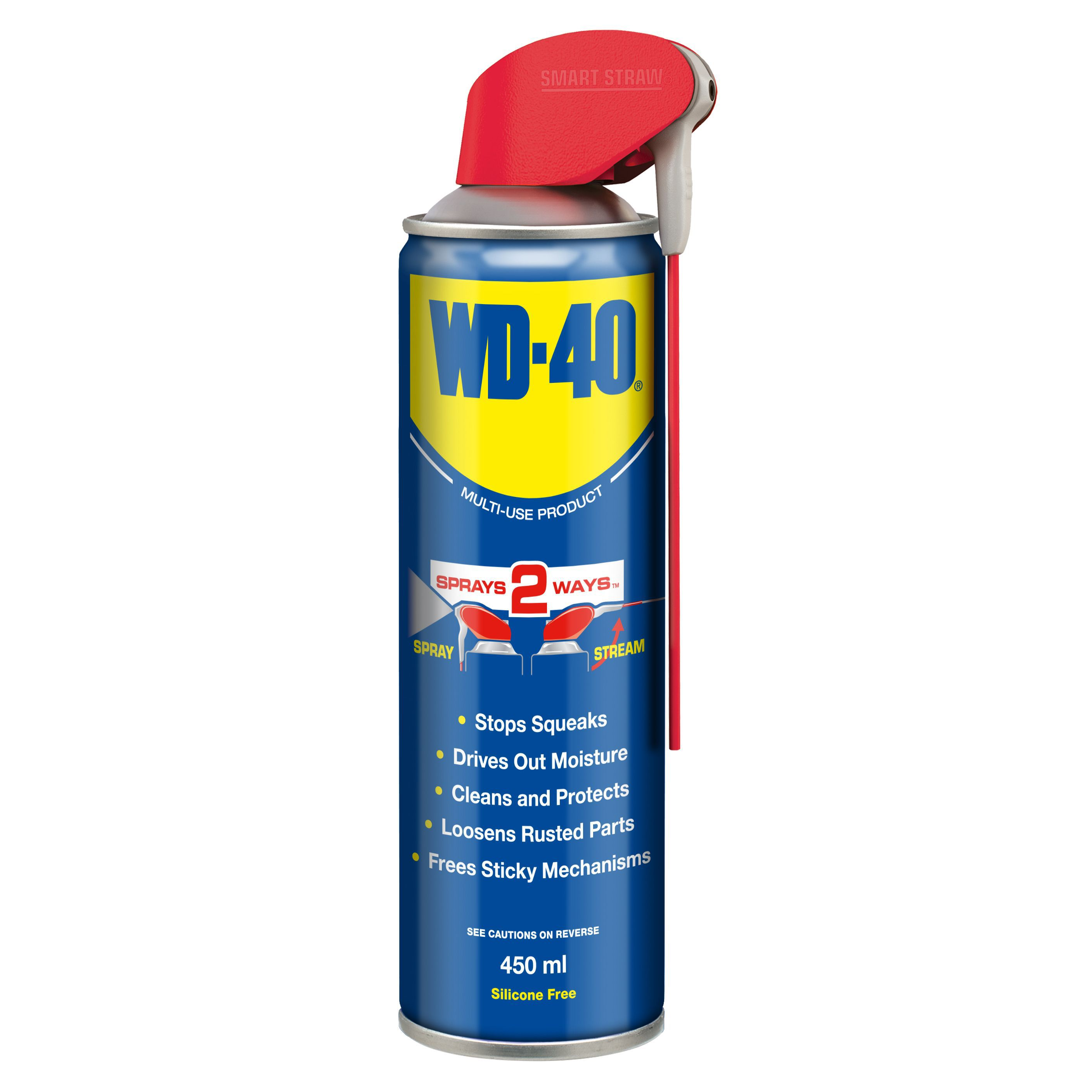

Wd40 can be used as an adhesive (and gum) remover
