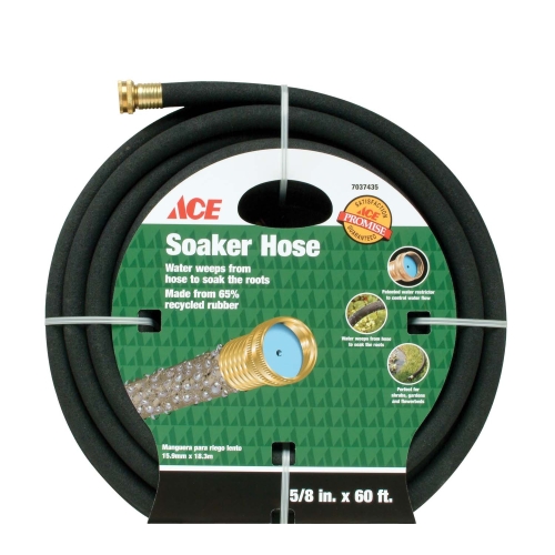

Just get this. Hook it up and charge the customer for watering the lawn. Its not that hard if they pay for carpet cleaning they can pay for the lawn service you offer. :lol:
