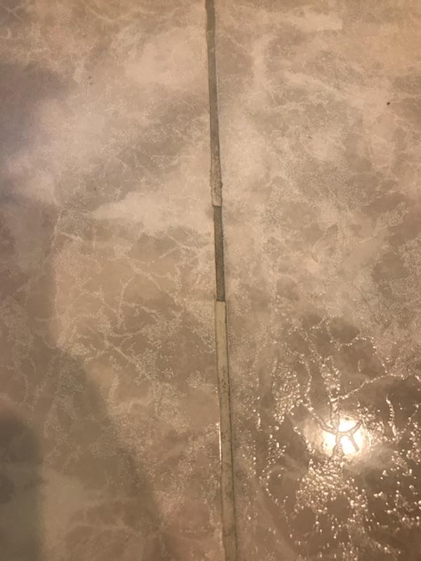

I know this is an old thread but unfortunately is an ongoing issue for me. Last year (2017) we completed a little over 5100 tile jobs. We get theses calls probably 5-8 times a year. We clean tike usually around 1250 PSI with a spinner. With this issue arising only once every 700ish jobs, it is clearly a faulty instillation. Unfortunately most customers accusing us of ruining their homes are unwilling to hear this. Usually I’ll ask them to get a repair quote and play it by ear (just pay to fix it as long as it’s reasonably priced).
It’s a tough balancing act. Too low of pressure people are pissed it didn’t clean up better. But still ensuring we aren’t causing unnecessary damage. 1250 has seemed to be pretty safe in the past.

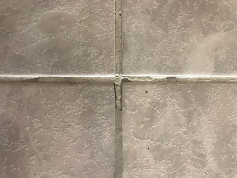

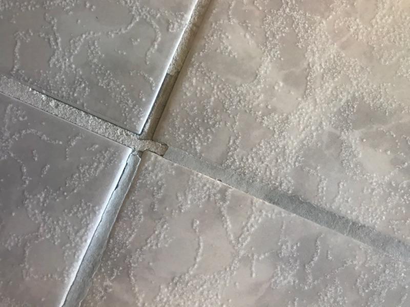

Well this most recent “grout gouging” fiasco has come to a conclusion. Come to find out a few months before hiring us to clean the tile & grout the customer had a competitor apply s “skim coat” of grout over the existing grout. Quite literally did not attempt to remove any grout prior to regrouting. Simply filled the recessed grout line with new grout probably 1/32” thick making it completely flush with the tile. Then is pissed at me when it blows out. He littered said he is “selling the house” and wants me to “re skim coat it so he can sell the house”. He “doesn’t care how long it lasts”. Just wants to be able to sell it. I told him I refuse to redo an already improper installation and pass the buck to the next homeowner. Now he is “taking me to small claims court”, and telling everyone how we ruined his home and don’t stand behind our work. SMH

Unfortunately the 3rd or 4th I’ve run into in the past year. While inspecting it can be tough to spot since you’re really just looking at grout. Not like checking for a film former where you can do an acid test or something. This seems to be a bandaid fix for people selling or flipping houses. Not really sure what the answer is. They’re so delicate the slightest amount of agitation or psi can start chipping them. Maybe a scratch test on the grout before cleaning?

Basically, the customer hired a company that did not follow STANDARD OPERATING PROCEDURES for such a service. They are the ones accountable.
Some you will not notice.. it’s up to tech to notice as cleaning and hit the brakes.... with at much it’s pretty obvious, and chunks will make a bunch of noise in the turbo....

I have had 2 commercial tile and grout jobs they did a skim coat on the grout during remodel and even with constitution. (updated but kept original for Sam... Should be Construction... Lol)
Ugly... Hard to discover until get into it.... And difficult to explain sometimes to those that don't really want to know what the problem is
Carl makes a good point ....tech should of noticed and stopped rather than continuing blowing out more
donno how many sf needs re-skimmed .
but wouldn't it of been easier and less hassle to simply eat it and send someone with a couple tubes of this?
doesn't matter if it "wasn't your fault" due to existing conditions
you know what they say right?
"inform the custy of a potential problem, it's education
Inform after the damage, it's an excuse"
just thinking out loud now, Chester
If it's a LOT of sf to cover, your techs need some guidance on how not to CONTINUE to blow grout out from room to room
If only a few hundred sf, think it would simply be less hassle, (and no internet review hate) to simply send a guy there with Polyblend to re-skim .
what will you have, a couple/three hundred in cost for one of your employees to skim??
Yea it sucks ...but maybe sucks less than court and i'net trashing damage ???
