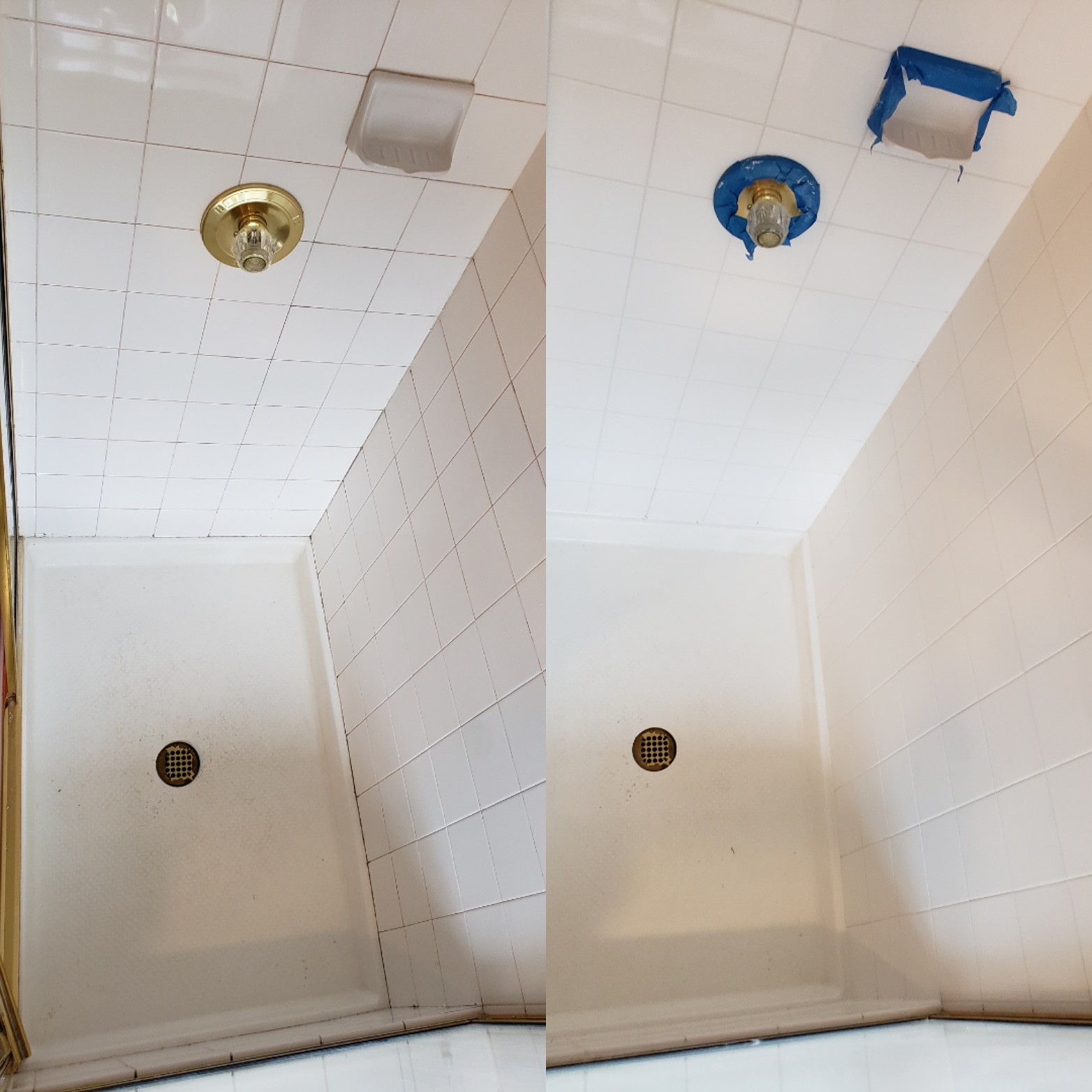

gundlach. stuff is awsome works on wet grout. Someone turned me on to it and its really good.
nothing else compares unless you want color enhancing for slate jobs etc, then we use DuPnt

gundlach is, spray and walk away wet grout etc doesnt matter

havent been using it for very long yet but so far it works really well.

You dont need to wait with Gundlach on fresh grout... but we only use it to seal after cleanings. The grout we install does not need a sealer thats the whole angle we take on our regrouting jobs. We only use Perma pool grout, its 100% waterproof made for underwater in swimming pools. Nothing better out there for showers, this shower will never need sealing again
