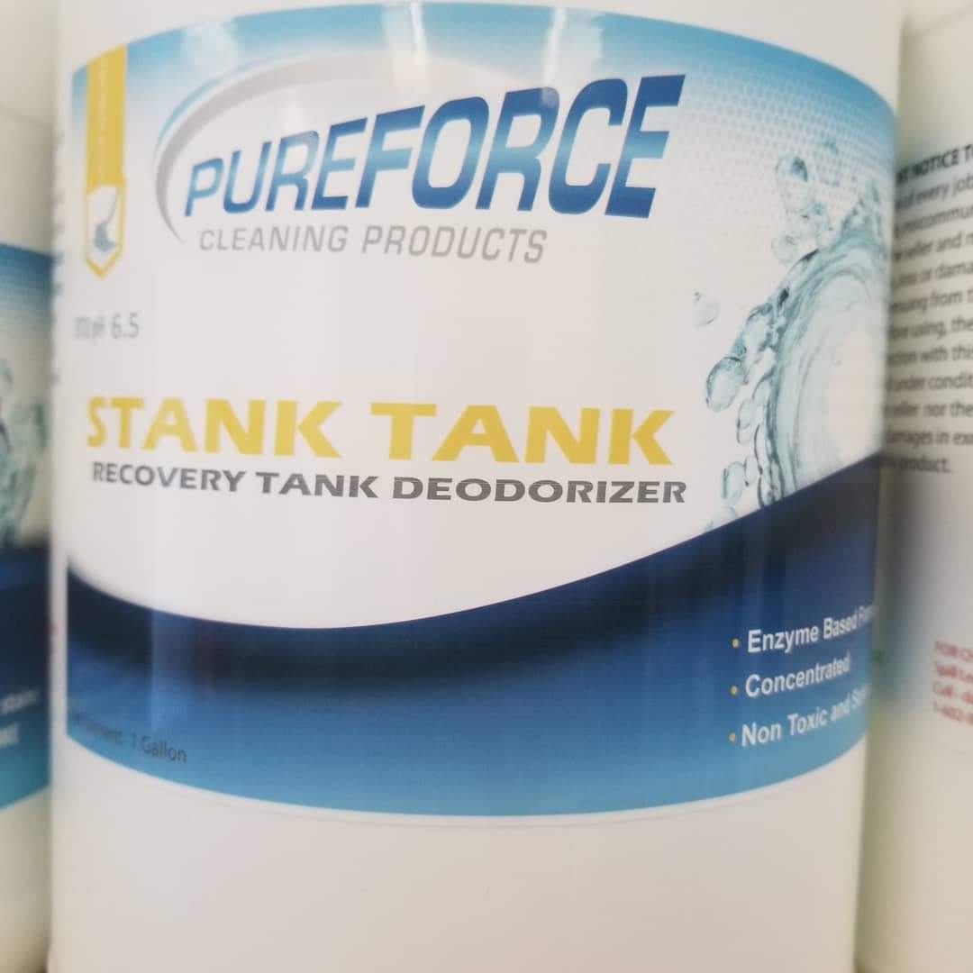

Fill with hot water and soak with some fabric softener.
Maybe some ptespray too.
The vacuum will be outstanding if you get that cleaned off
6,518
Bc
Put it on straight or dump the whole bottle with the tank filled with water overnight?
I would babysit it. The stuff is insane strong...
I’d fill 1/2- 3/4, then add a bottle or 2...
I wouldn’t leave it overnight.
I’ve used it to unclog drains many times,residentially, and it works fast..
it’s formulated to work in about 15-30 minutes.
wear PPE...
the last time I used hot water, it worked in 3-5 minutes.
The fumes almost killed me..
