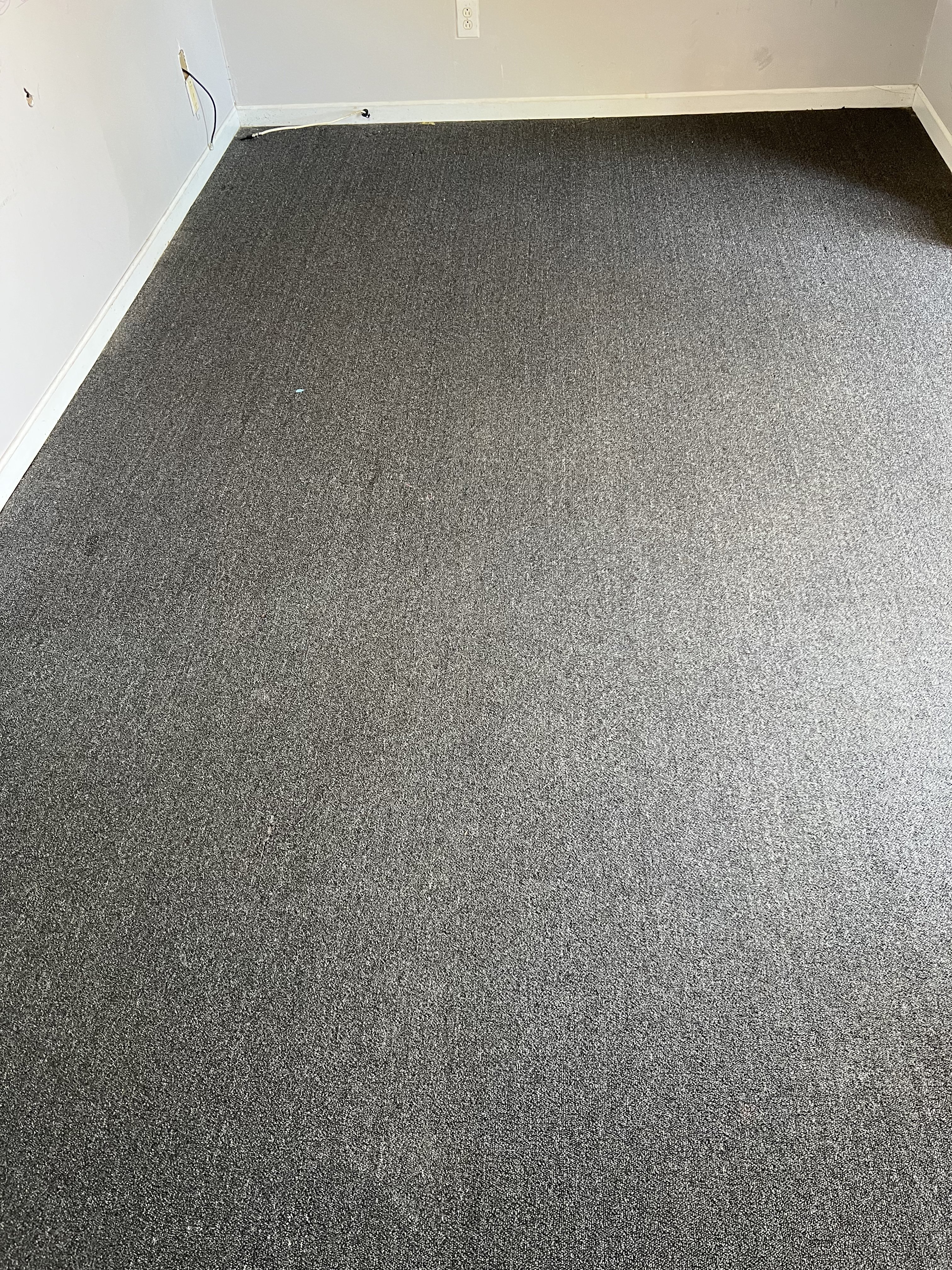

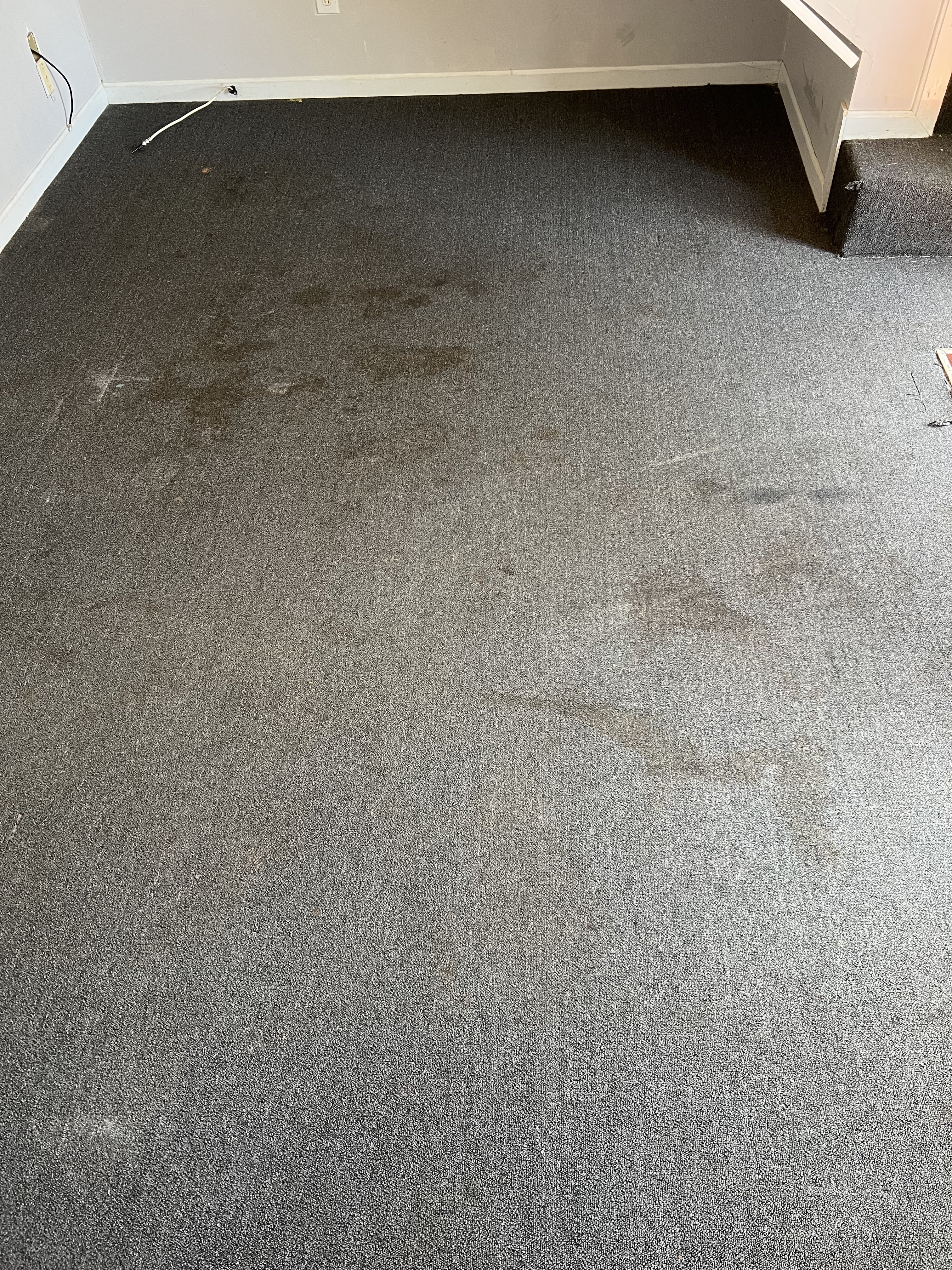

Before and after pics from one of the apartments we knocked out today. We used a Phoenix with a grey pad, 4 opg Awesome Encap, 2 opg Go Oxy, then followed up with a blue/grey striped microfiber. I also had my son give it a post cleaning vacuum and sprayed some Fresh Scent Odorcide at 2 opg.
View attachment 122489 View attachment 122490
The naysayers will eventually bash your results. Looks good.
I don't understand post vacuuming. The product is still wet, hasn't crystalized yet and you're picking up moisture with your vacuum. Probably not good for your vacuum.

It was dry in no time at all and the place had blow in insulation/drywall/construction dust all over. We vacuumed a total of three times, two before and one after. The Phoenix jiggled dirt up from the bottom of the pile during cleaning that just couldn’t not be vacuumed up.
Had I extracted it all that crap that jiggled to the top would still be down there and wet, instead of dumped in a trash bag.
The whole place was in really rough shape and had been empty for a while.
