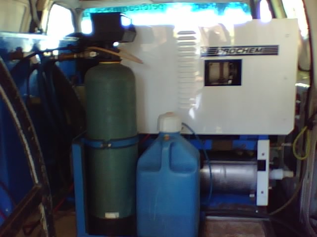

:shock: HERE IT IS ON MY 405...DOuChbAg..............
"Use the LEFT-HANDED sCrEwDRiVer...." :roll:
Make sure you tell them what pAiD for IT.. :oops:
The BLUE JUG is the bRine Tank....... :?

That is a 1992 .....405 ....with 5700 hrs on HER.....The best machine I have ever OWNED..
It is my BACK-UP unit.....It is the only VAN we have left....ALL BOX TRUCKS NOW...
The Water softner has not been used in 2 years....."he got it PRETTY cHeAp..." 8)

Richard here are some pics.....of the 405's.."LUCY"...new home...
This is the Truck the 805 was in........

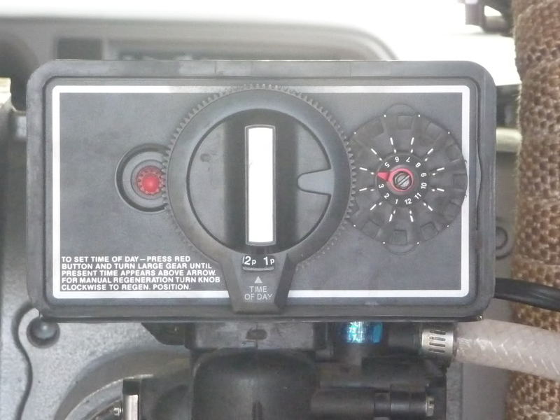

That control is made by Fleck. They make the controls for most of the softeners and all your local independent stores will sell and service. Look for a shop near a rural area where people use wells not a shop that specializes ripping people off by telling them the city water will kill them.
To recharge mine I run an extension cord to it,hook up water supply hose and unhook the QD to my fresh tank so not water is flowing,run a piece of tubing that is hooked to the softener and hook it to the brine tank in the garage that I use for my house unit,run the drain hose to my waste tank and manually advance the dial to get it started.
