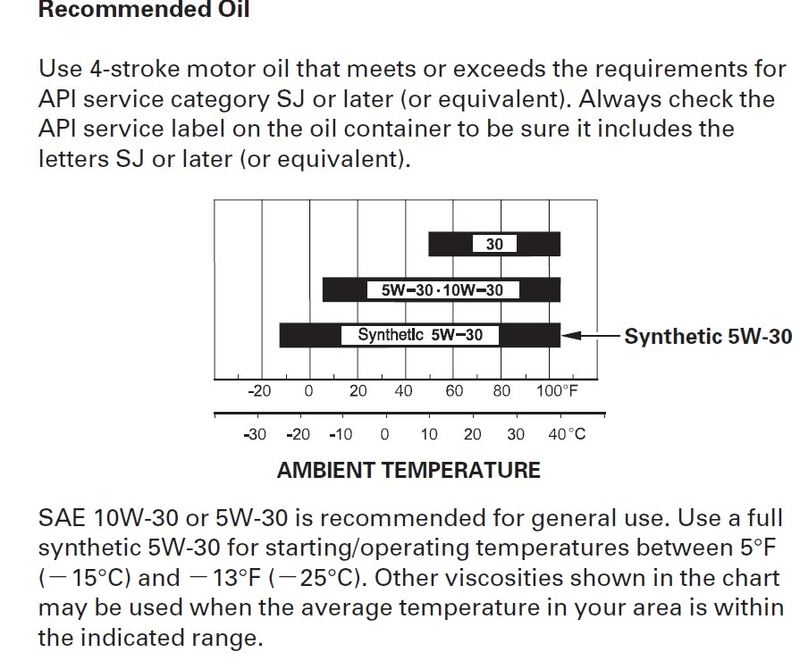

dgardner
Apr 7, 2008
5,109
Phoenix, AZ
Dan Gardner
joeynbgky said:
My Honda engine owners manual says 10-w30..
Joey, your TCS chief has a Honda GX690, right? The manual I downloaded from Honda for the GX690 seems to allow several different choices depending on ambient temp (typical for most small engines):
Your manual doesn't have this table? Curious.
joeynbgky
Jun 27, 2009
3,434
Bowling Green
Joey
My honda owners manual does have this............. So I have been using 10-w30 like it says... But like I said my TM manual says HD-30, because of the heat I suppose.
Ron Werner
8,726
Ron Werner
run 10w30 in the cold months for that extra lube at start up, and straight 30 in summer when its much warmer. In colder months you're going to get better cooling, in summer, the air doing the cooling is already hot.
