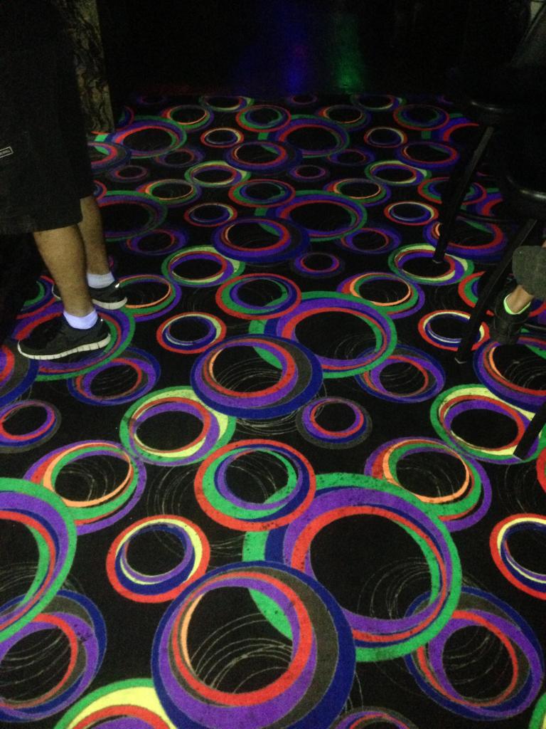

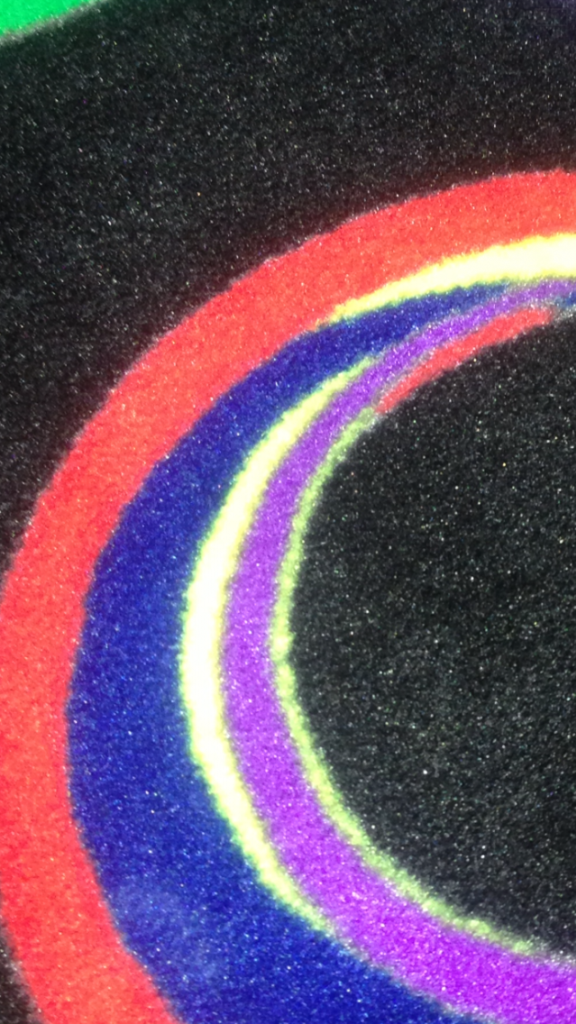

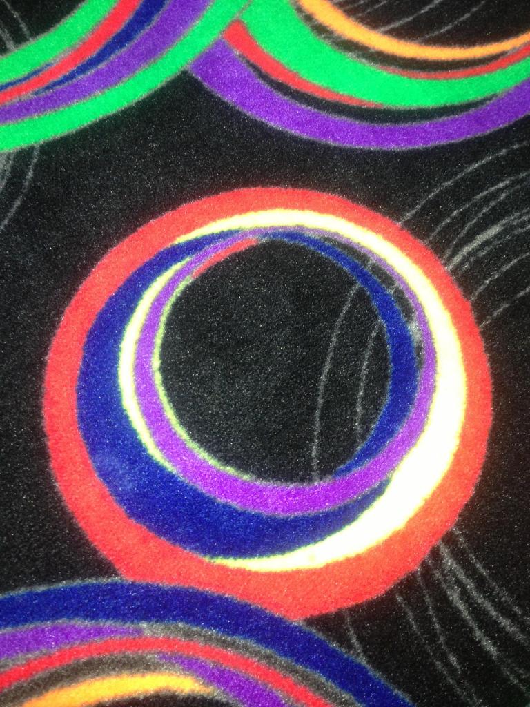

here are the pics of the strip club carpet

less than a month old..never cleaned..manufacturer told them to hwe it and then protect it..it came from factory with protector on it.
it glows like crazy in the dark..kind of creepy actually

Good gawd, I'd be dizzy as hell wanding all over that :shifty:
Sling that outta yur hose end YUK!

It looks like bowling alley carpet. A little sleazy for a strip club............ then again, maybe not.

Most manufacturers of fluorescent carpet warn that high pH cleaners may accelerate the degradation of the fluorescent properties, so you may want to watch your pH. Also make sure nothing you are using contains any optical brighteners.

yea you guys should see it in full swing..with all the lights blinking and light dots running all over the place like colored bugs..its crazy.
i really dont see how anyone doesnt get motion sickness in there..
i will watch the ph on my prespray and i have to see if powermax has any optical brighteners in it..

Cuz they are not looking at the carpet. DUH
I've cleaned that stuff before in a bowling alley, it is designed to react with black lights, Monty Carlo or moonlight bowling.

The advice to watch the pH is very important. Some manufacturers say no more than 8.5, others say Neutral. So, stay very low.
Because you can't hit it with the strongest cleaning juice, it should be cleaned and protected fairly often. If the soil levels get out of control, it will be difficult to clean without high pH.
There is an article on Glow-In-The-Dark carpet and how to clean it on Cleanwiki - http://cleanwiki.com/technical-resources/ Look under the Technical bulletins selection.
