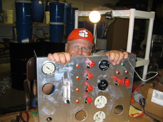

HERE IT IS THE ALL NEW N1 NORDIC1 ES ELECTRIC SYSTEM
Bjorn
2,450
r]http://www.youtube.com/watch?v=fldCgcXTsFQr]
Bjorn
2,450
WE KNOW HOW TO USE SCREW DRIVERS AND OTHER TOOLS
Take a shop class Kracker!
Bjorn
2,450
two 110 cords # 10 gauge nice big Hubble twist and Lock connectors no expense spared on components
Apr 4, 2009
675
Looks great!
How about the specs?
temp, psi, vac lift, cfm???
What do you plug it into? Total amps used?
Price....?
Installation..??

got to get your heat from some where and propane is the most bang for the buck in BTU's
but here is the true secret to the system
1]http://www.youtube.com/watch?v=TuhYd9L_d7w1]
right now we are the only truck mount manufacturer using this technology
working on a portable fusion reactor at the moment
just waiting for good house keeping seal of approval

IMO, it looks like the unit needs more vacuum, everything else looks awsome...round waste tank, 3 ht, 120,000 btu, plenty of heat for an 8 flow at 450 psi. I would ad one more 3 stage vac mounted on the right side of the machine on the outside of the panel straight into the exhaust of the motor. Use it as a booster. If you can't find a different circuit, which you probably can in a commercial building, buy a small generator....probably $100 on sale for the situations you may need a little extra vac. I only say this from experience. Years ago, I had 4 3-stage vacs hooked up to a square box, 3' x 3', high pro, 500 psi pump. One plug ran the pump and one vac motor, one vac motor ran off of another plug and the other two ran off a generator. The unit was good, up to 150'. I grabbed the wand on a rainy day that was resting on the vacuum motor after hooking it up and I got lit up like a fu***** christmas tree.

There are 4 ways to generate heat for a HWE truckmount.
  • 1. Heat Exchanger/s — In an electric unit, there are not enough heat generating devices to capture heat from, so heat exchange is not a good choice for electric truckmounts.
    2. Electric Heaters — Requires way too much juice (electric amps) in order to produce enough sustained heat.
    3. Kerosene — It will produce plenty of heat.
    4. LP — I prefer LP as it is extremely clean burning, less fuss than Kero, and will produce all the heat that you will ever need for cleaning any type of job, and then some. The clean burning LP heater goes along with the ECO friendly contribution of electric truckmounts for planet Earth.
If you doubt the cleaning power of some of the newer generation electrics, come to MF this February and see for yourself!
I take back my opinion. After using the Nortic1 at Mickey fest, it ran very strong 2 vacs 100 ft. We used the Zipper jr. with a 12 flow. Very impressive.
