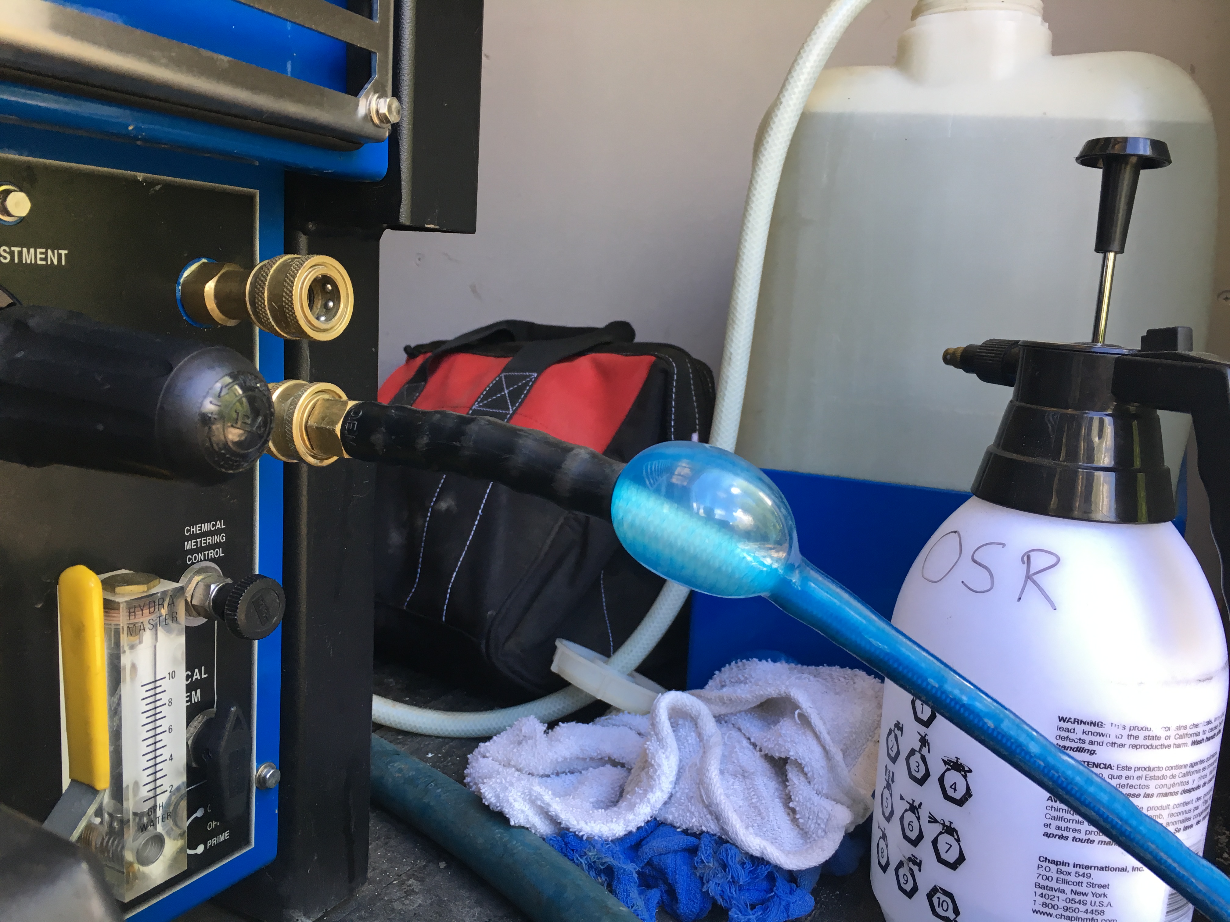

Ugh
I’ve seen this comment a few times about how good cobbs is. Bs. This happened more than once for me. Don’t get that no name cobbs hose
I had no problems with it.
I was able to crimp my own fittings and bought it without fittings.
and I didn't use bend restrictors that trap heat more heat
