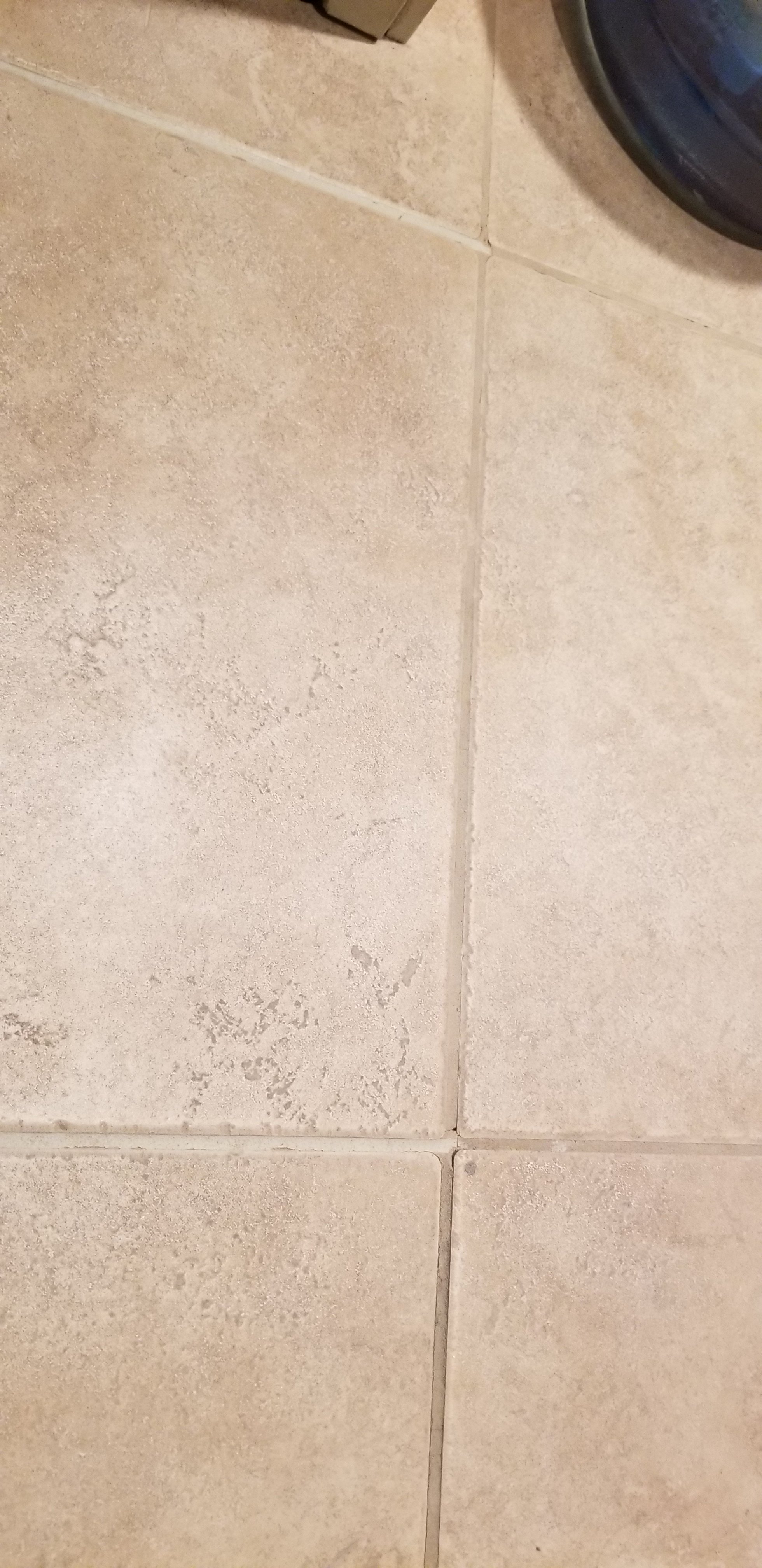

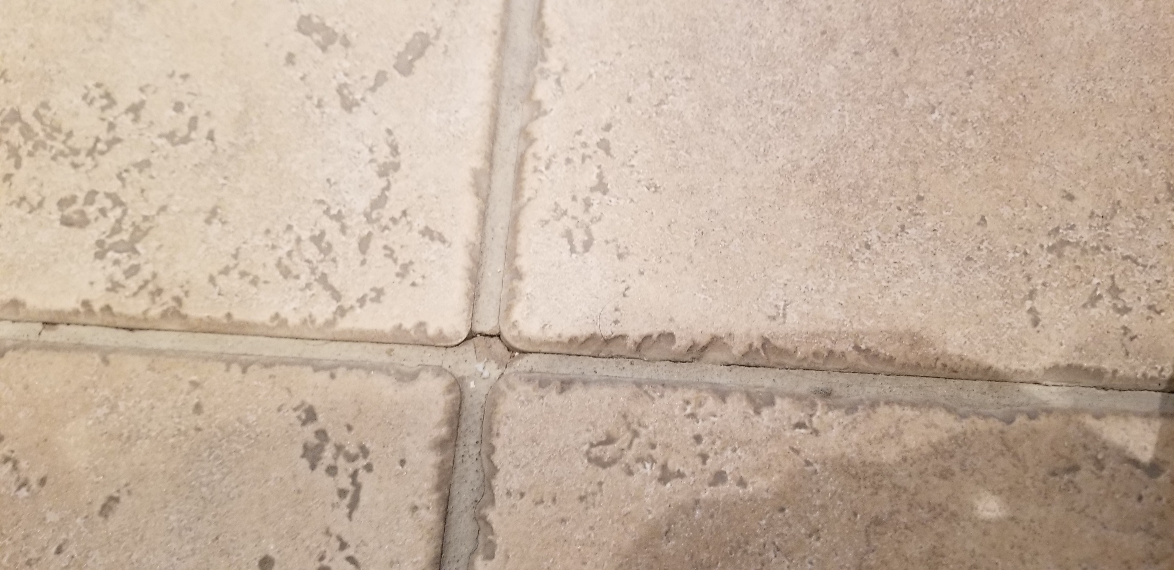

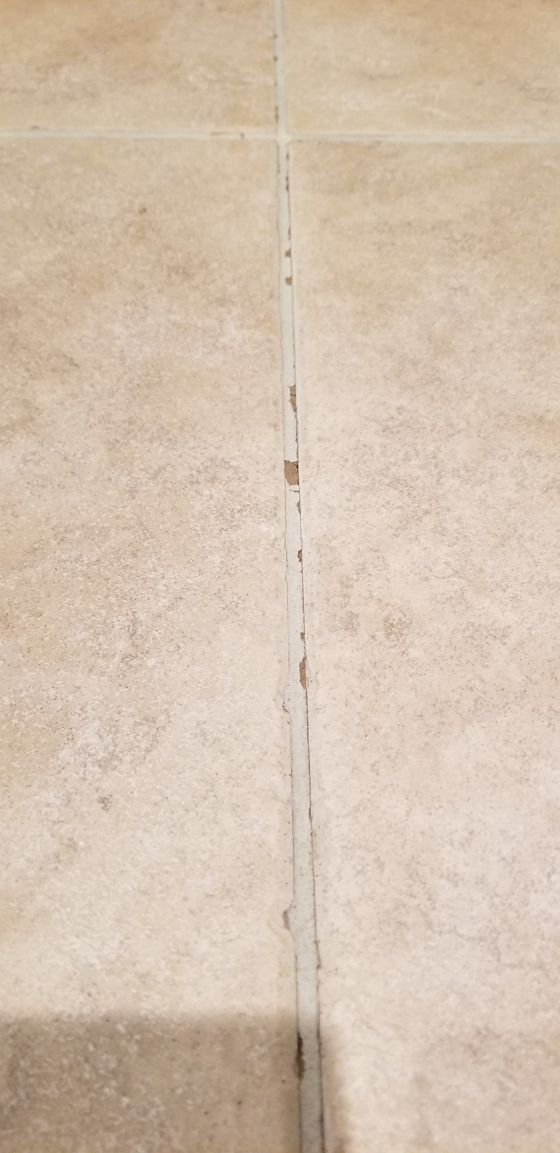

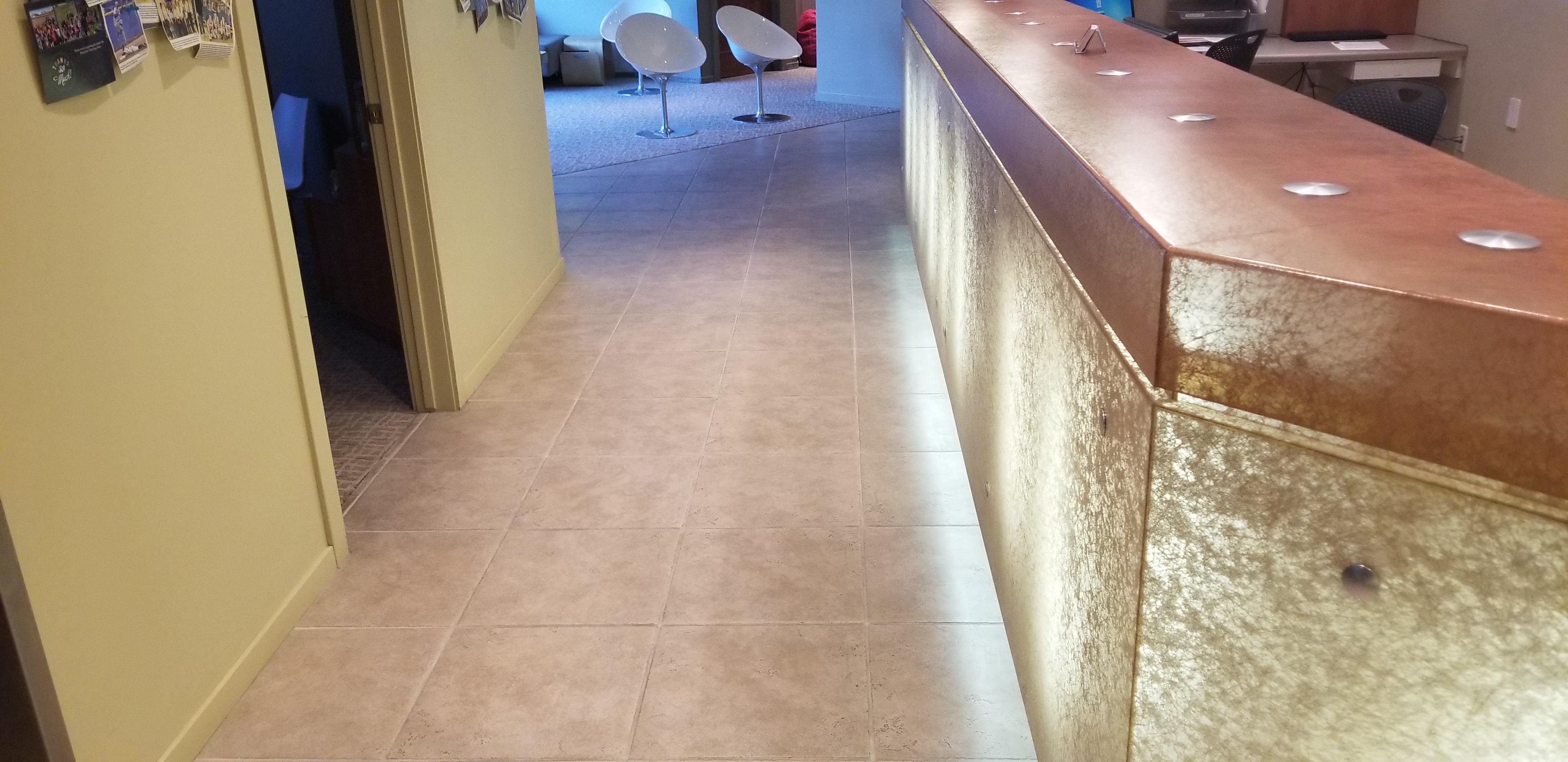

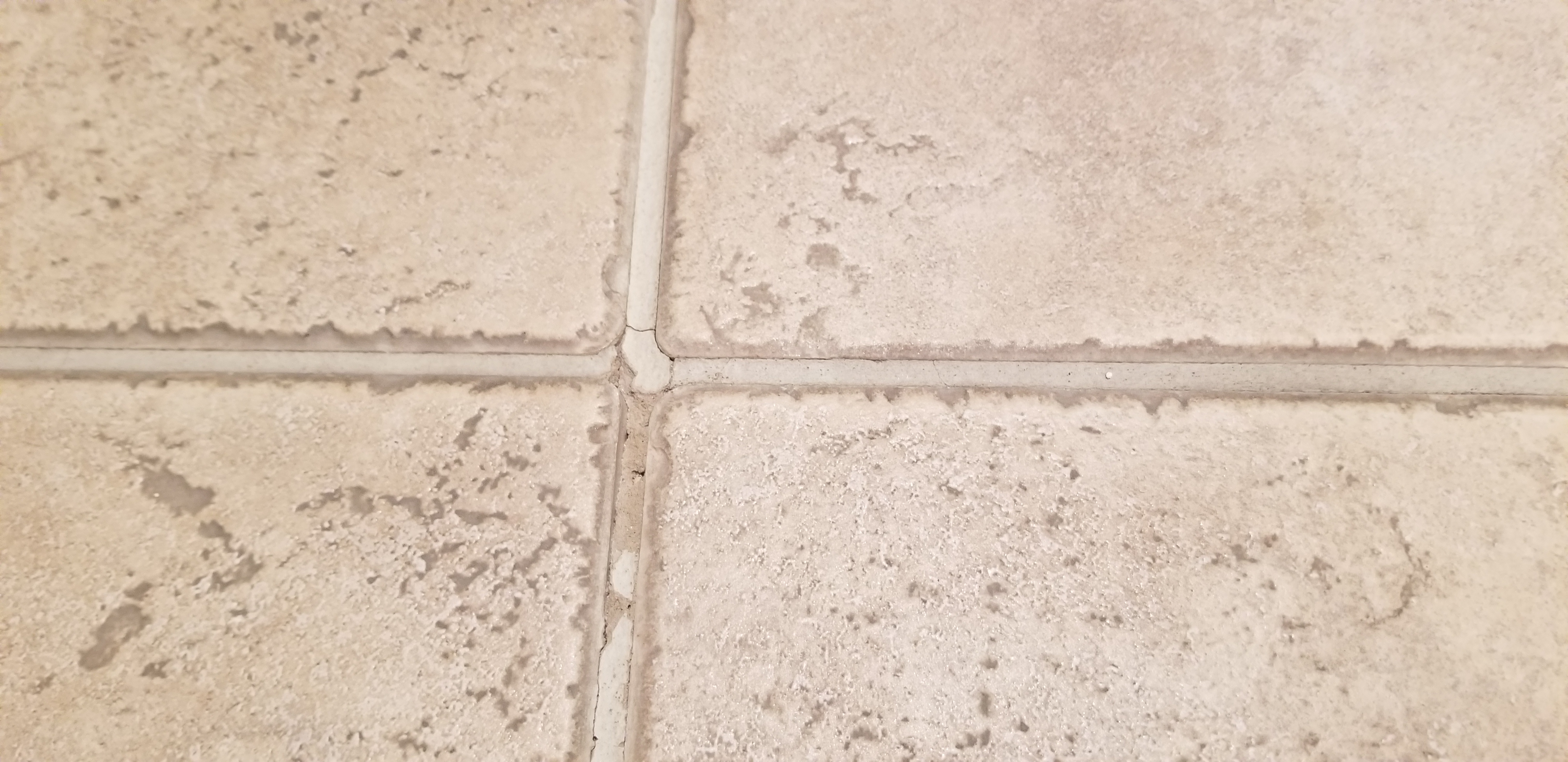

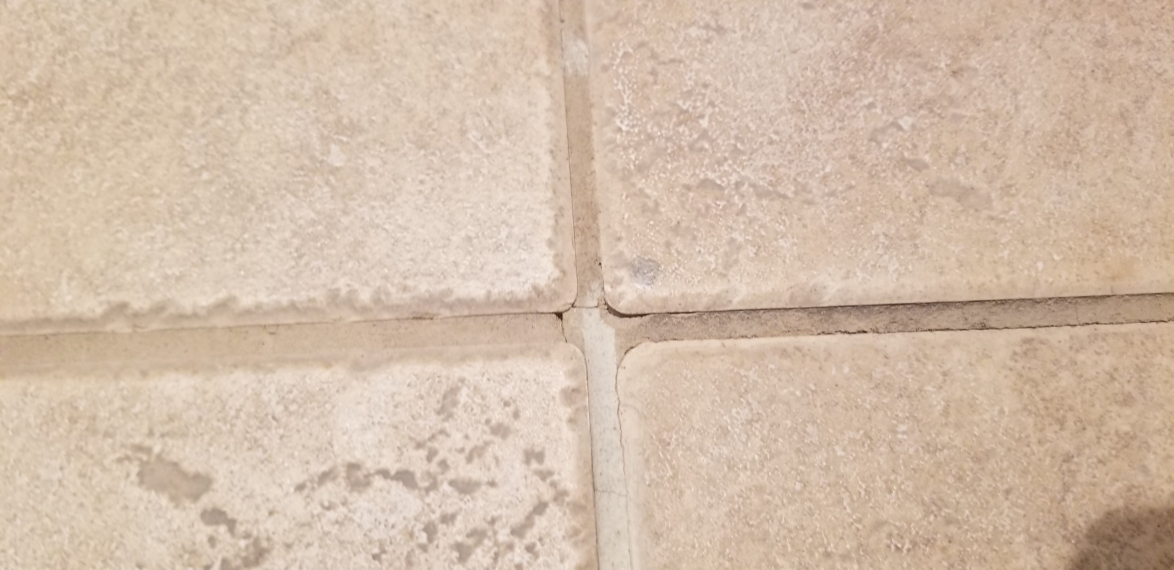

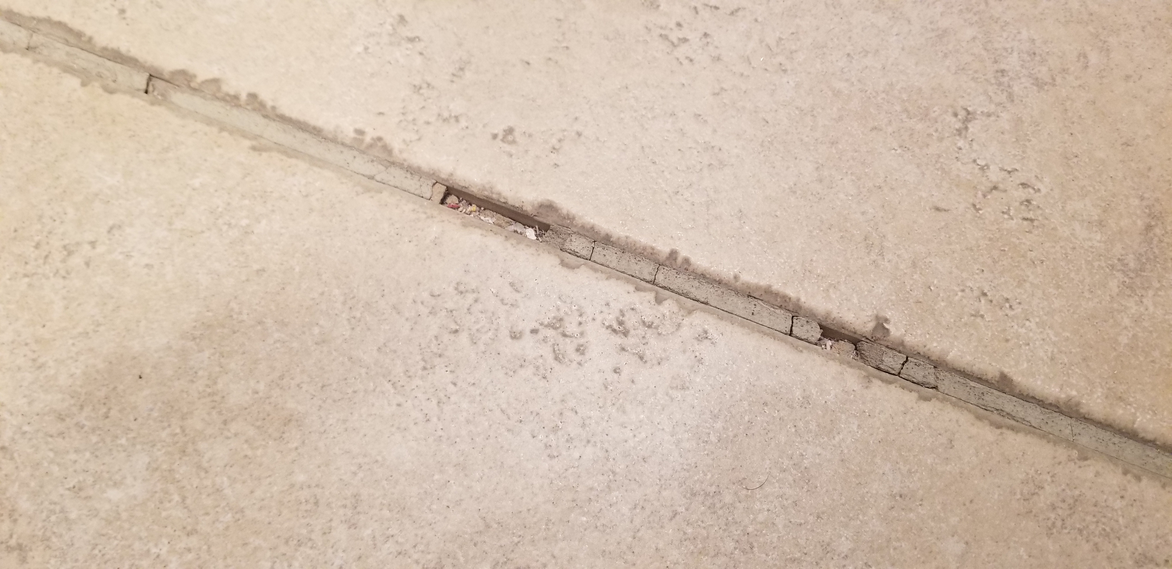

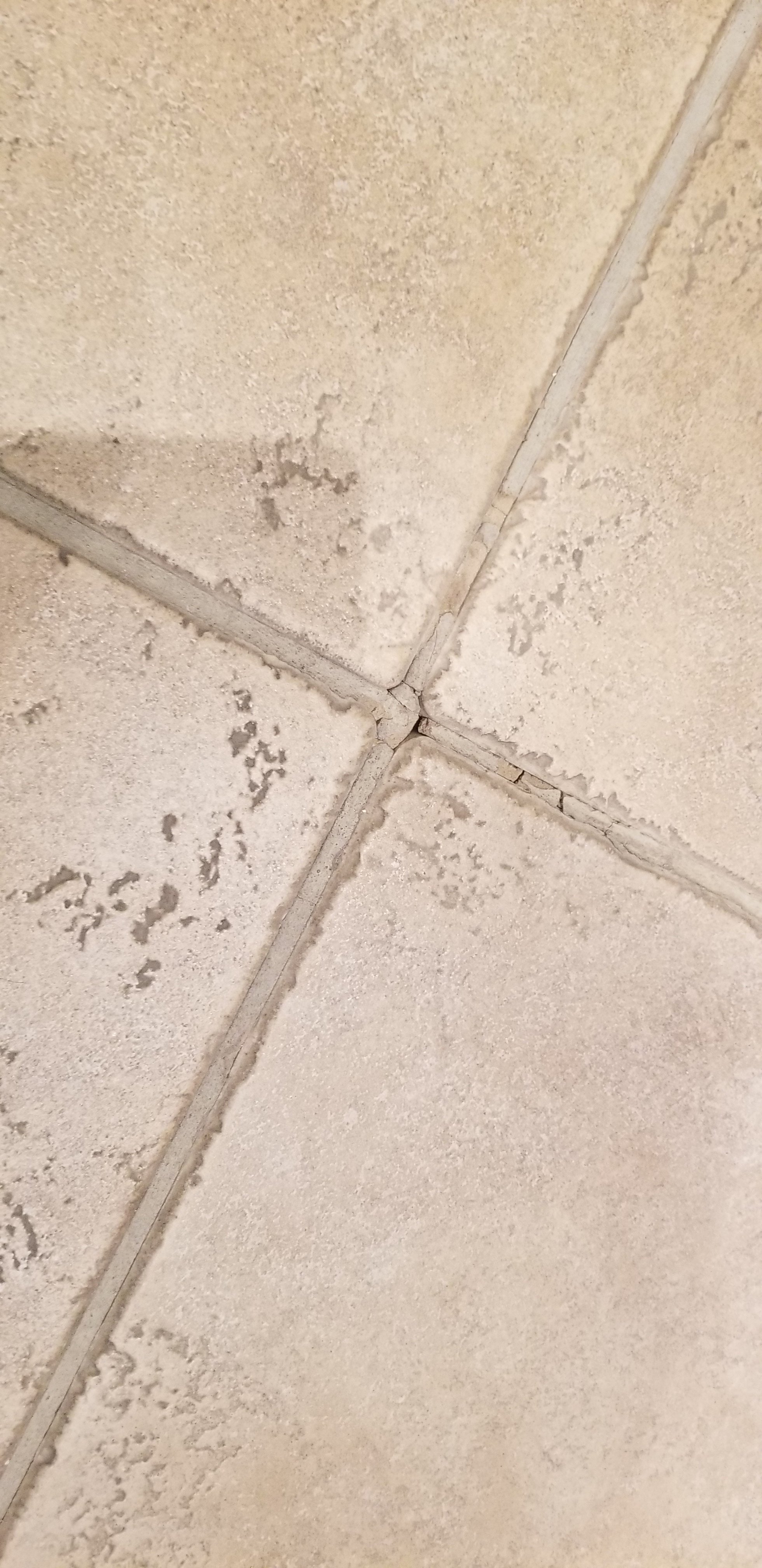

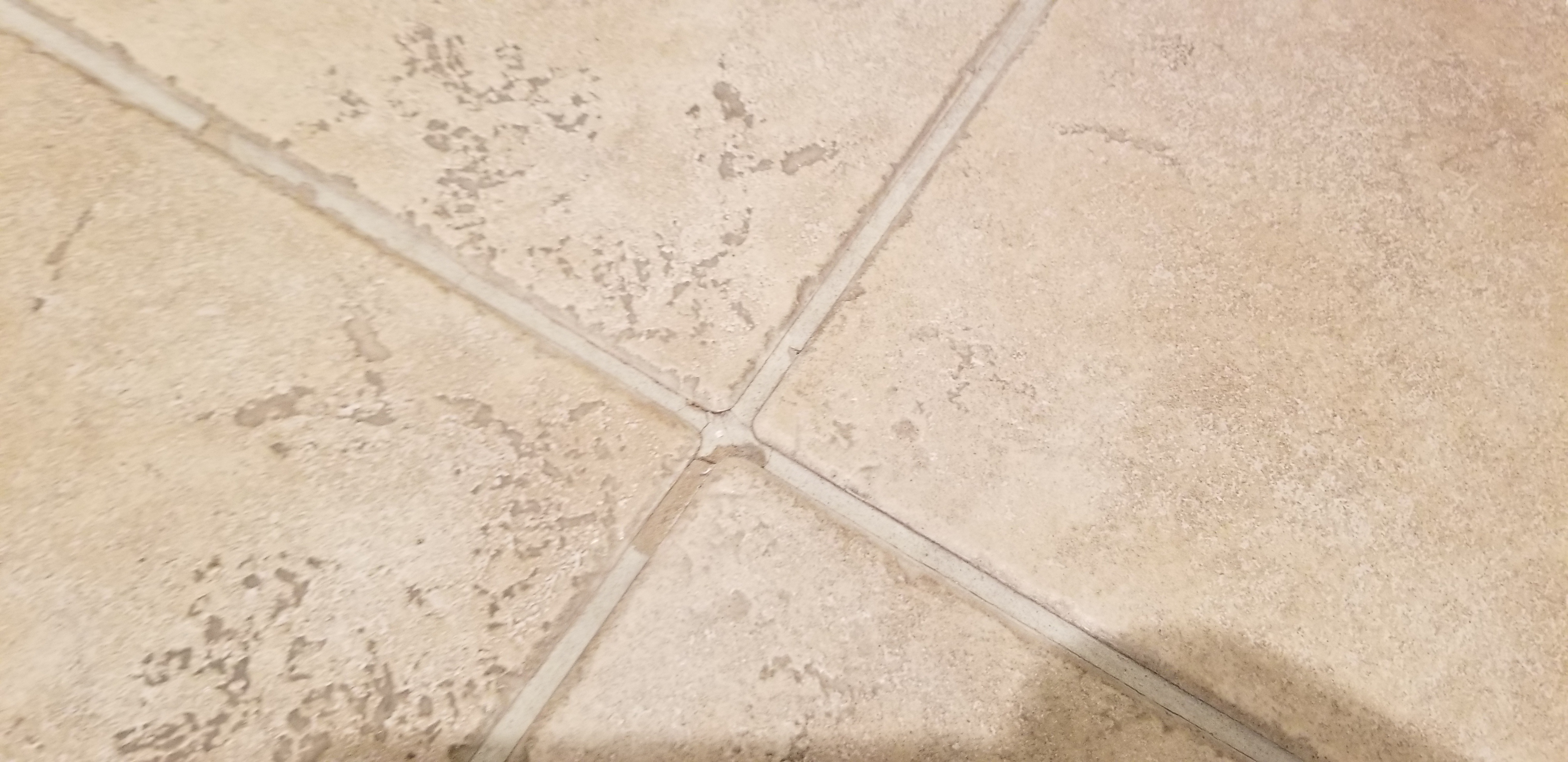

Horrible grout situation, but I made the best of it..
115,962
Blown out grout, crappy colorseal job.. 20180726_094444.jpg 20180726_120612.jpg 20180726_094441.jpg 20180726_101555.jpg 20180726_101551.jpg 20180726_101539.jpg 20180726_101535.jpg 20180726_101513.jpg 20180726_101510.jpg 20180726_101504.jpg

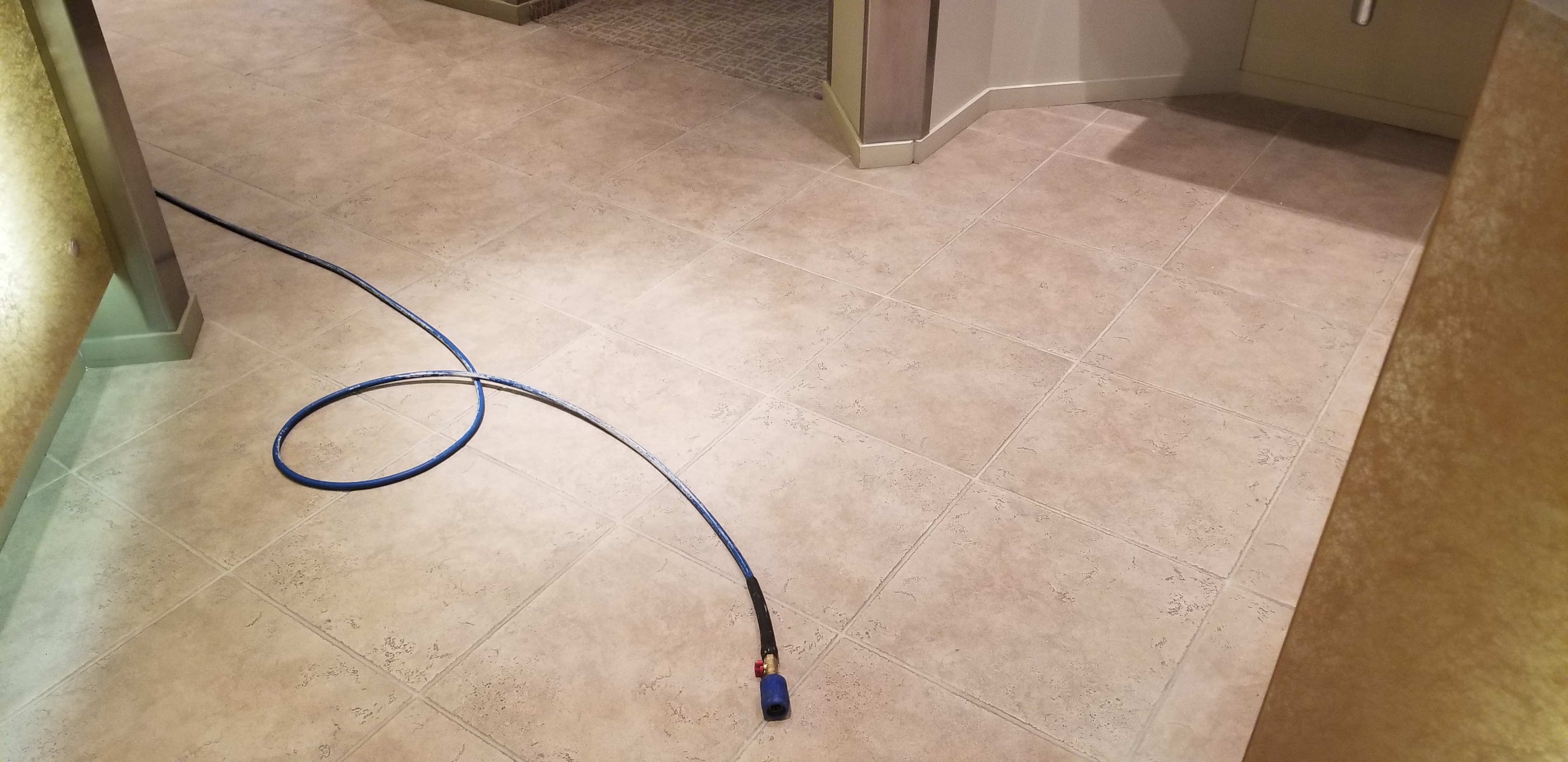

Neutral No Rinse cleaner mopped down.
Crb, which did wonders..
Glided wand rinse at 400 psi and cold water.
Tomorrow I'll fill the voids with SGA color matched to the collorseal.

Thanks for the pics by the way. Good example of a job that can't be done without some repair and customer relations skill.
