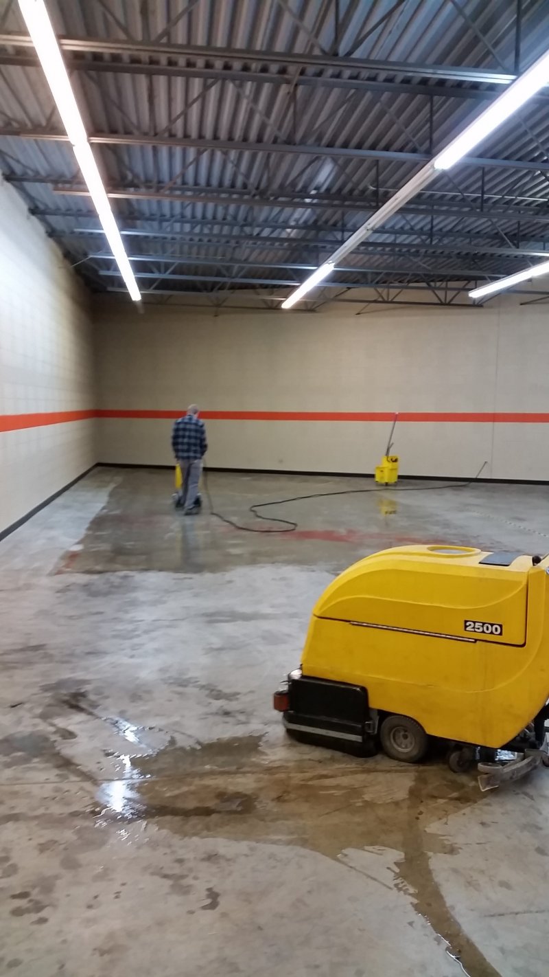

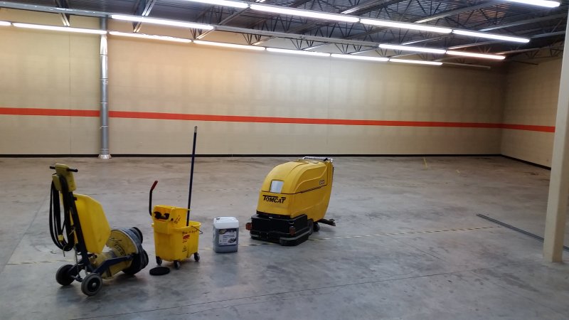

I just did a smaller warehouse that used to be a Harley dealer. Lots of oil and crud on the concrete. Mine was only around 10,000 sq ft on two levels. I mopped down a good degreaser, ran a cimex over the bad areas, then used a walk behind auto scrubber to suck everything up. If you can rent a ride on floor scrubber, that would be the best route and then use a good degreaser to put down on the floor.
