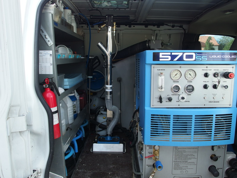

Butler has a Hot Water convenience hose and nice shut off on the front of the unit...the hose is pointed through a hole in the bottom of the floor to help prevent water getting in van, or burning you.
We just pull that hose out from it's floor hole, wipe off road grime and fill jugs and hot water as needed.

My white magic pro 1200 had that too, it was nice. New 1200 has a seperated valve with a hose plumbed direct to the rinse jug, I pull it out to fill sprayers but the hose needs to be a little longer

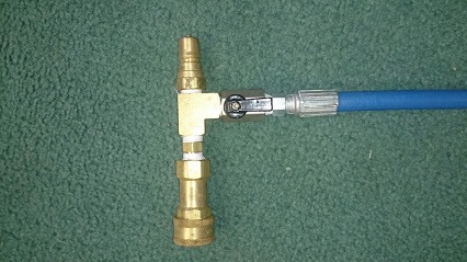

Hydro-Force just introduced a quality convenience hose outlet two weeks ago. Top quality 1000+ PSI ball valve and Qucik connects. You can buy it assembled
for less than the cost of the parts to build it.

My 870 doesn't have a courtesy hose. It really should. That short hose with ball valve is what I use now.Very dangerous for new people. Being that the 570 ,pro1200 and the 870 use engine coolant hxs I wish Sapphire would offer a hot water hose plumbed off that.

Hydro-Force just introduced a quality convenience hose outlet two weeks ago. Top quality 1000+ PSI ball valve and Qucik connects. You can buy it assembled View attachment 12017 for less than the cost of the parts to build it.
That looks convenient, Scott. But why not just plumb the tee directly to the machine and eliminate a set of quick connects?
Buy that assembly, remove the female quick connect for use elsewhere, and plumb the tee to the machine.
