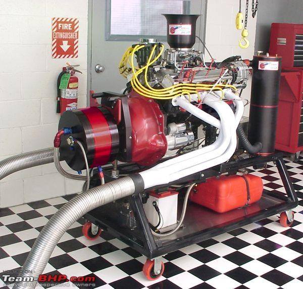

Since rpm are involved, why would it be any different than a car that moves? Bhp is basically a true rating of hp.
BHP is the engine torque measured under brake
(no other way to measure a stationary engine)
HP used to be measured in theory only (no engine friction a perfect system) which was why it was standardised.. sometime ago...
@bob vawter might know?
DAT
Apr 3, 2017
6,486
Nevada
Bill Cheryl
This is how they test BHP ? Make senses.
