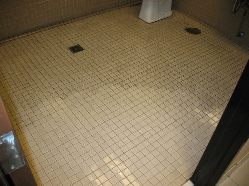

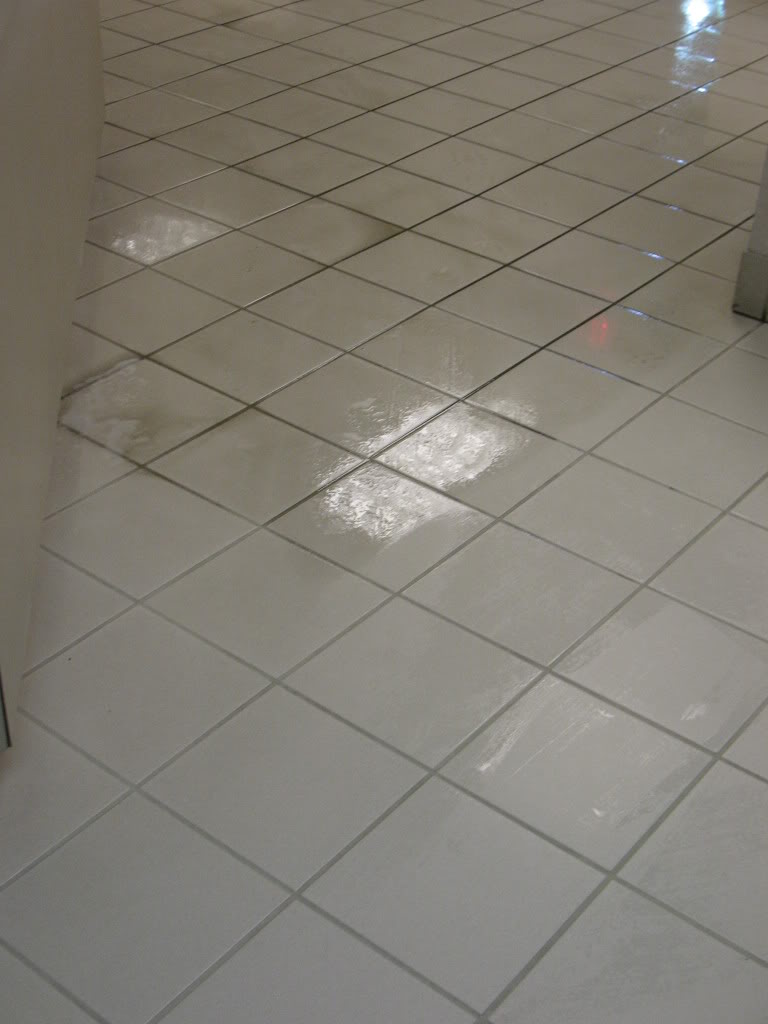

Finished in about 4.5 hours and was not to difficult but was not completely 100% happy with the results. Don't get me wrong the customer loved the end result and is going to get me in to their other buildings but i was not happy citing that i had a different idea of how it was going to turn out. I will post pics as soon as i learn how.

With this job the grout didnt match when dry. But after a close review of the floor i noticed that some kind of repairs had been made to the floor at various times and those repairs were not to professional. There was grout on top of the tiles, there was grout that was even with the tile, and several places that the grout was darker not dirtier but darker than others. Is this were color seal comes into play?

Sounds like an ideal situation for color seal. Nothing on top and grout that isn't uniform in color.
If the customer is willing to pay for it, it will be worth doing.

Be careful selling a color seal job when this condition exists, especially in high traffic areas. The color seal WILL wear off the grout. If there are a lot of high grout lines, pass on the color seal or be very sure to set the appropriate expectations with the client. You can also remove some of the grout from the high lines.

That is true. Flush grout is not wise to color seal. Tough to get the sealer to stay for sure.
