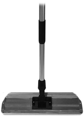

Mar 27, 2017 #1 Jimmy L Member Joined Oct 7, 2006 Messages 15,250 Location Ne Name Jimmy L How do I apply this? what to use etc.?
Mar 27, 2017 #2 hogjowl Idiot™ Joined Oct 7, 2006 Messages 49,294 Location Prattville, Alabama I spray it on with my Multisprayer and rub it in with a swifter mop and microfiber pad
Mar 27, 2017 #3 Mikey P Administrator Joined Oct 6, 2006 Messages 115,956 Location The High Chapperal Reactions: Mark Saiger and Bob Pruitt
Mar 27, 2017 #4 BradFenstermaker Member Joined Oct 9, 2006 Messages 1,846 Location N GA Name BradFenstermaker Is that mop dry or damp? If damp with what?

Mar 27, 2017 #6 Mikey P Administrator Joined Oct 6, 2006 Messages 115,956 Location The High Chapperal BradFenstermaker said: Is that mop dry or damp? If damp with what? Click to expand... damp with sealer Brad

Mar 28, 2017 #12 dealtimeman Everyday is Saturday. Joined Sep 20, 2008 Messages 10,878 Location Fort Worth , Texas Name Michael We don't spray our just pour on the tile and spread around.
Mar 28, 2017 #13 Mikey P Administrator Joined Oct 6, 2006 Messages 115,956 Location The High Chapperal I pour on about half the jobs

Mar 28, 2017 #17 Jimmy L Member Joined Oct 7, 2006 Messages 15,250 Location Ne Name Jimmy L What is the name of the product?
Mar 28, 2017 #18 Mikey P Administrator Joined Oct 6, 2006 Messages 115,956 Location The High Chapperal UltraSeal Impregnater
Mar 28, 2017 #19 Jimmy L Member Joined Oct 7, 2006 Messages 15,250 Location Ne Name Jimmy L Thanks! What tip do you use on the multisprayer?
Mar 28, 2017 #20 Mikey P Administrator Joined Oct 6, 2006 Messages 115,956 Location The High Chapperal 80 or 95/01 Same for carpet Reactions: Jimmy L

Mar 28, 2017 #25 Larry Cobb Member Joined Oct 7, 2006 Messages 5,795 Location Dallas, Texas USA Name Larry Cobb Jimmy; This is the applicator and product : Pour it on and spread . . . http://www.cobbcarpet.com/zen/index...arch_in_description=1&keyword=DCUG1+or+LG518F Reactions: Old Coastie
