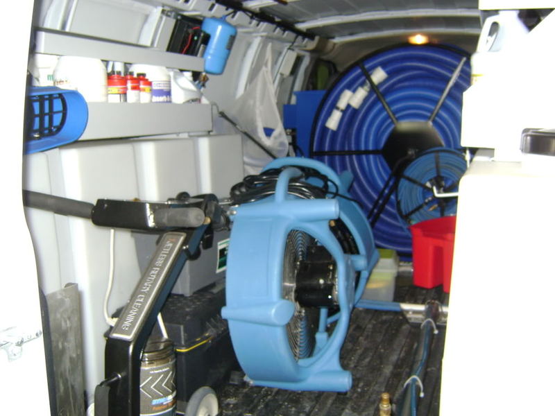

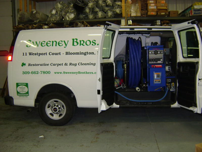

2008 Hydramaster CDS 4.8
Installed in a 3/4 Ton 2008 New GMC Savannah with the 4.8
Dual 60 gallon saddle tanks with a combined 120 gallon capacity.
200 foot hose real and solution real. We have 100 feet of 2.5 and 50 feet of 2" on it.
The system offers a heck of alot of room in the van. We carry usally 2 air paths, a regular blower fan, a RDM, space for 16 chemicals, greenhorn wand, vacuum, Spotter Kit, stair tool, upholstery tool, two water buckets, two sprayers, a second five gallon stock solution, host machien and still have time room to bring a couple rugs back to the shop.
For a technician to run they are great because there isn't much they can screw up. The only thing I would recommend would be to upgrade to the Salsa Package and maybe the apo.
The extra 20-40 degrees can be helpful. In the summer we get 215 to 220 at the mount on hot days.
