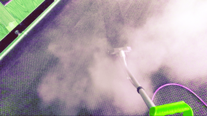

I feel as if you may be including me. I use Devastator’s. You should also. Then you wouldn’t worry about wand jet physic’s.
Will you Show me the water spray on the two middle jets? I’m curious if the vac tube interferes with the spray like all the other 4-6jet wands
