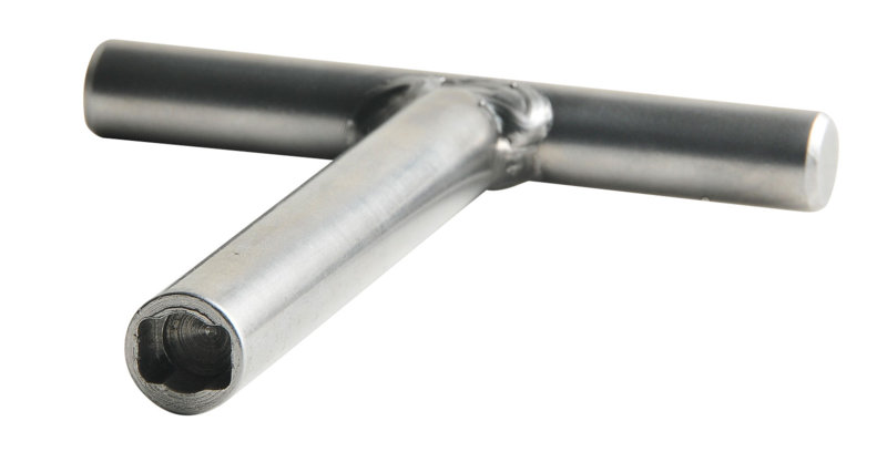

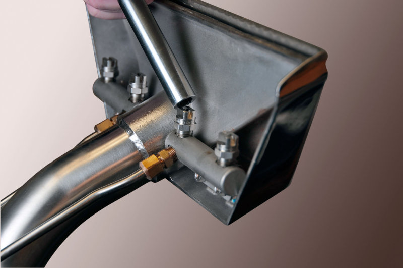

14,083

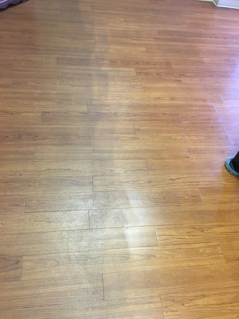

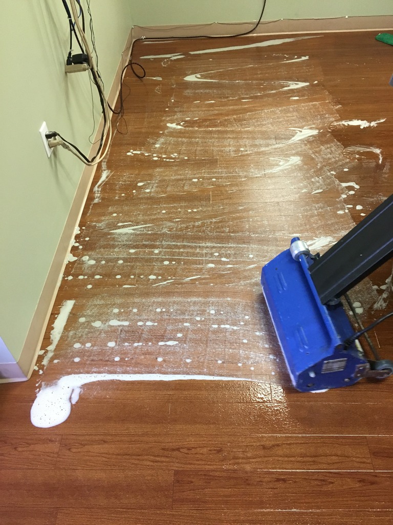

If you have a laminate cleaning procedure, it should work to clean the construction dust.
These photos are from a job where the vinyl had a texture to it. I hope the previous cleanings with a black pad did not ruin it.
We used only flat mops for extraction. A CRB is the right tool for this type of job.

Yep. Looks very similar different color. What did you use for a cleaner? Daily neutral or Bruce?
