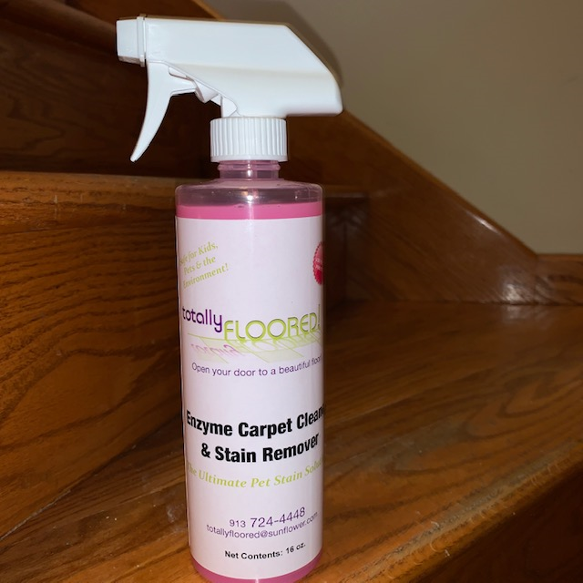

Russ I use a spotter that Full Circle in KC does for me. It is a plant based enzyme and pink, the girls love it and rave about how well it works. I think it's about 3 to 4 dollars a bottle and 12 bottles to a case. Give em a call.
