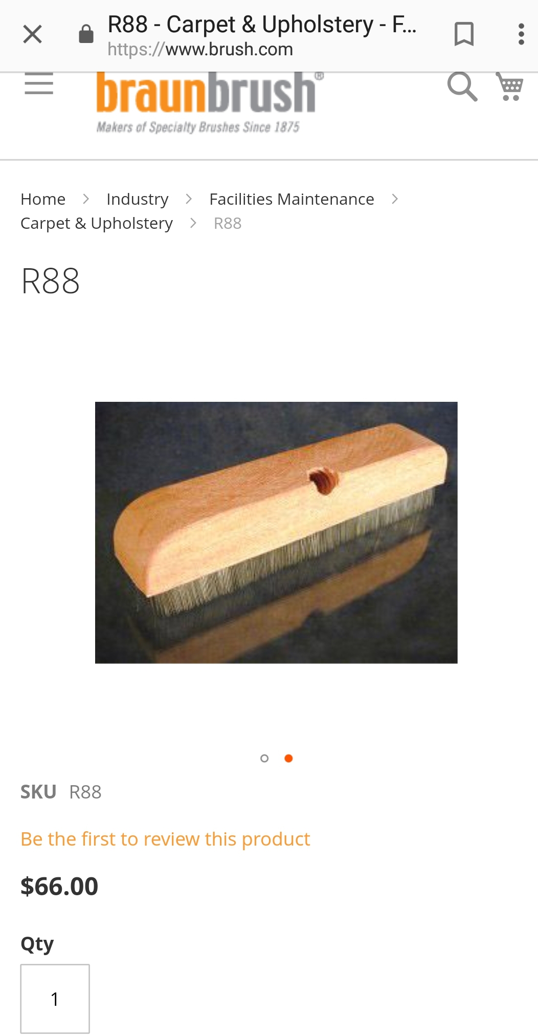

We use a standard ZIPPER on rugs. However it sounds less like the tool and more of a grooming issue.
If they are careful get one of theses heads and a nice pole. With a little effort it may minimize any call backs.
