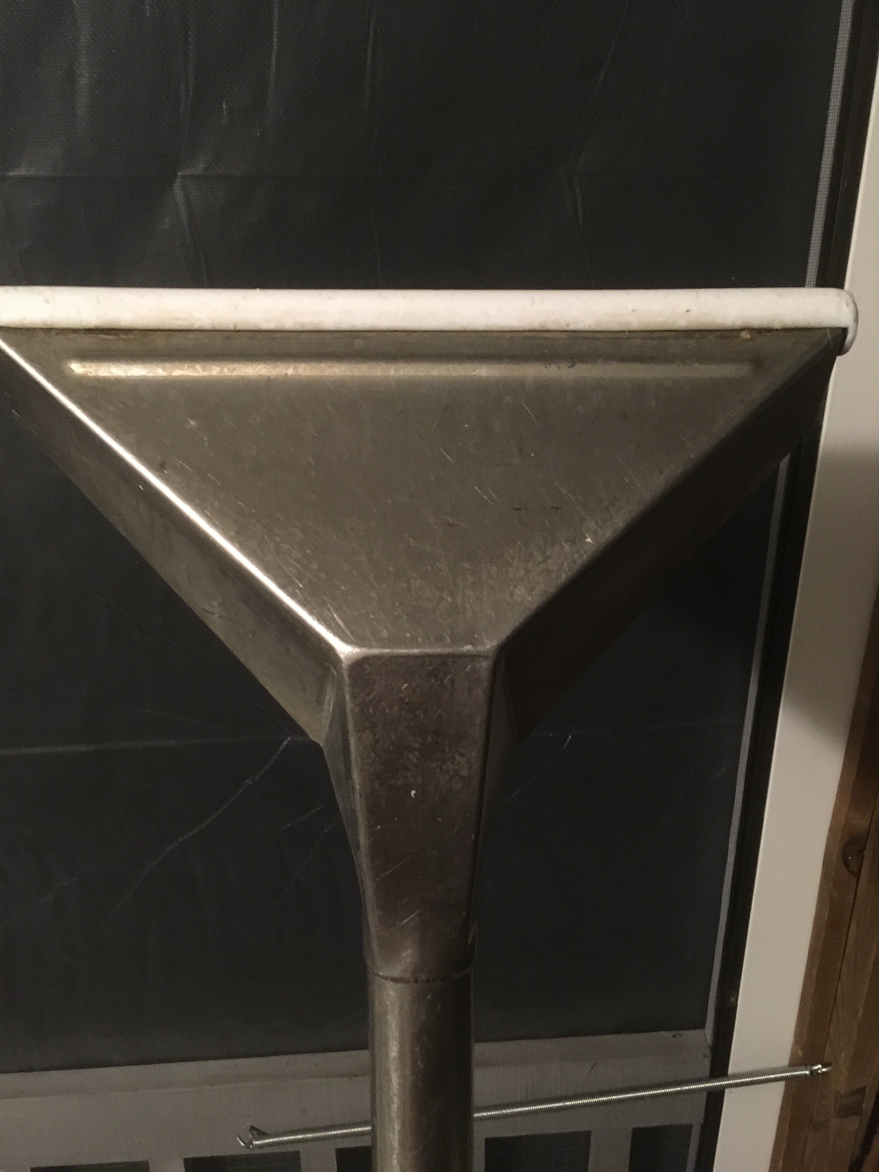

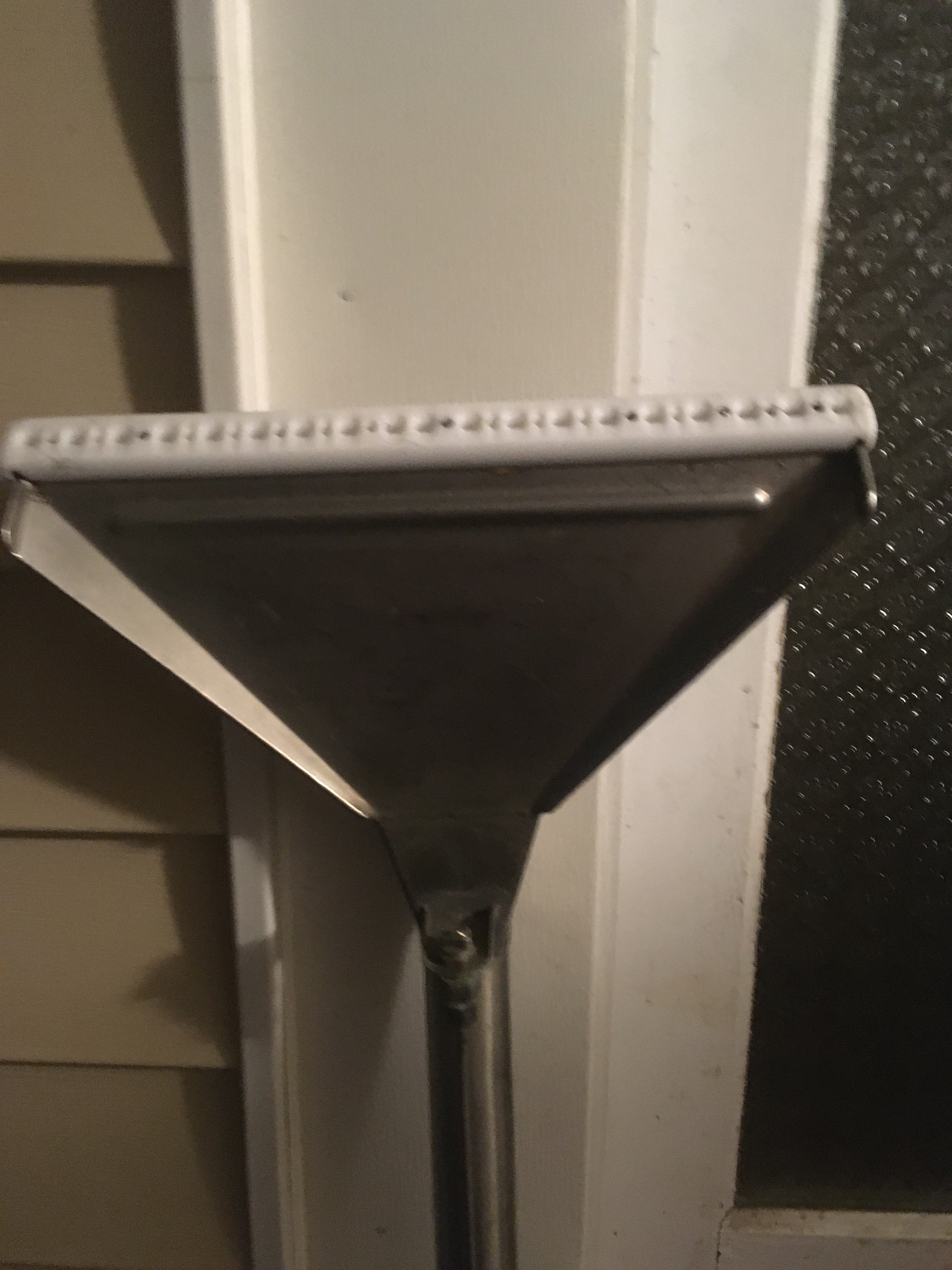

I do. I've been ordering Greenglides for 18 years from Lisa. This is actually what they call the "look a like" Hydrahoe made by PMF. The external is a perfect fit. I've never tried the internal one but I would be glad to give it a try.View attachment 113611View attachment 113612
The PMF wand is still in production and is actually the exact same wand.
Hydromaster discontinued it a while back in favor of their Evolution line.
I sell mostly internals as they help keep the older HM wands from pinching shut, the PMF version has a support pin in the middle which does the same thing.

Is your SSTI Glide internal or external fit?
The internal is easier to swap out if you remove the back metal lip.
14,097
Oh.. wow..
Yeah you will be amazed at the difference. Haven't you noticed that the external is rocking of and on the back lip? and leaking air...
The “other” glide companies say leaking air is good😏
Screw that. Give me a tube of silicone
