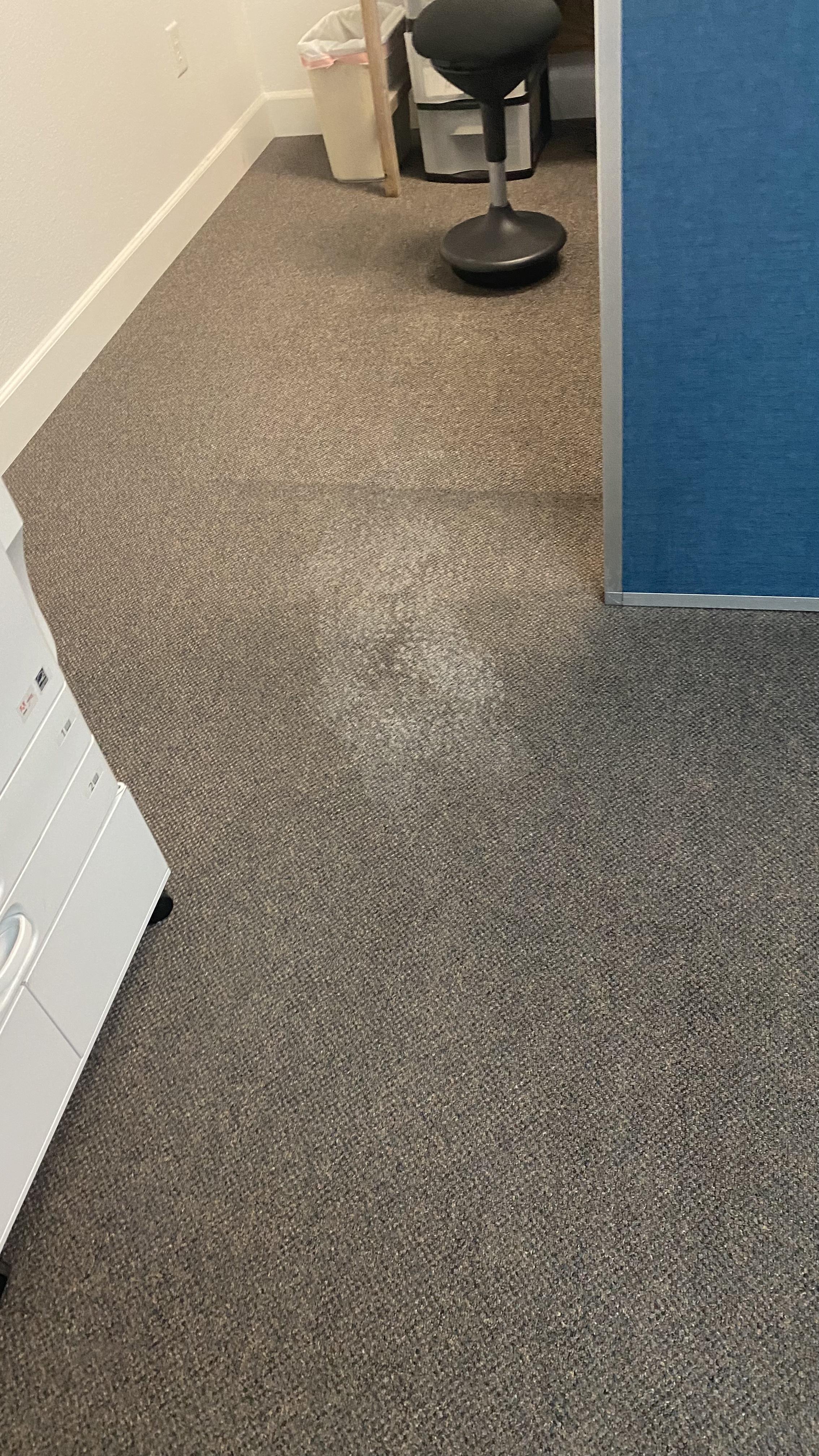

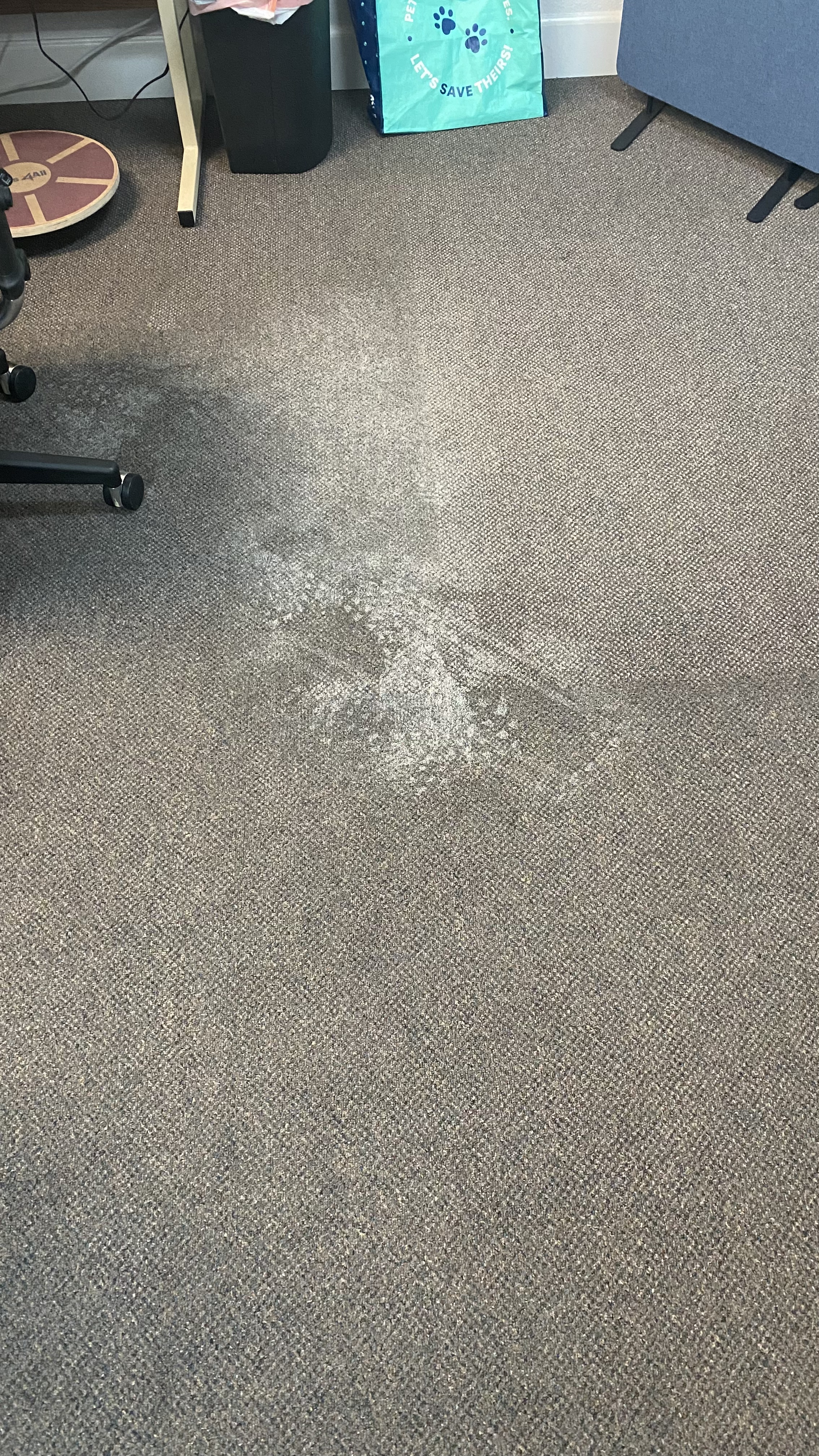

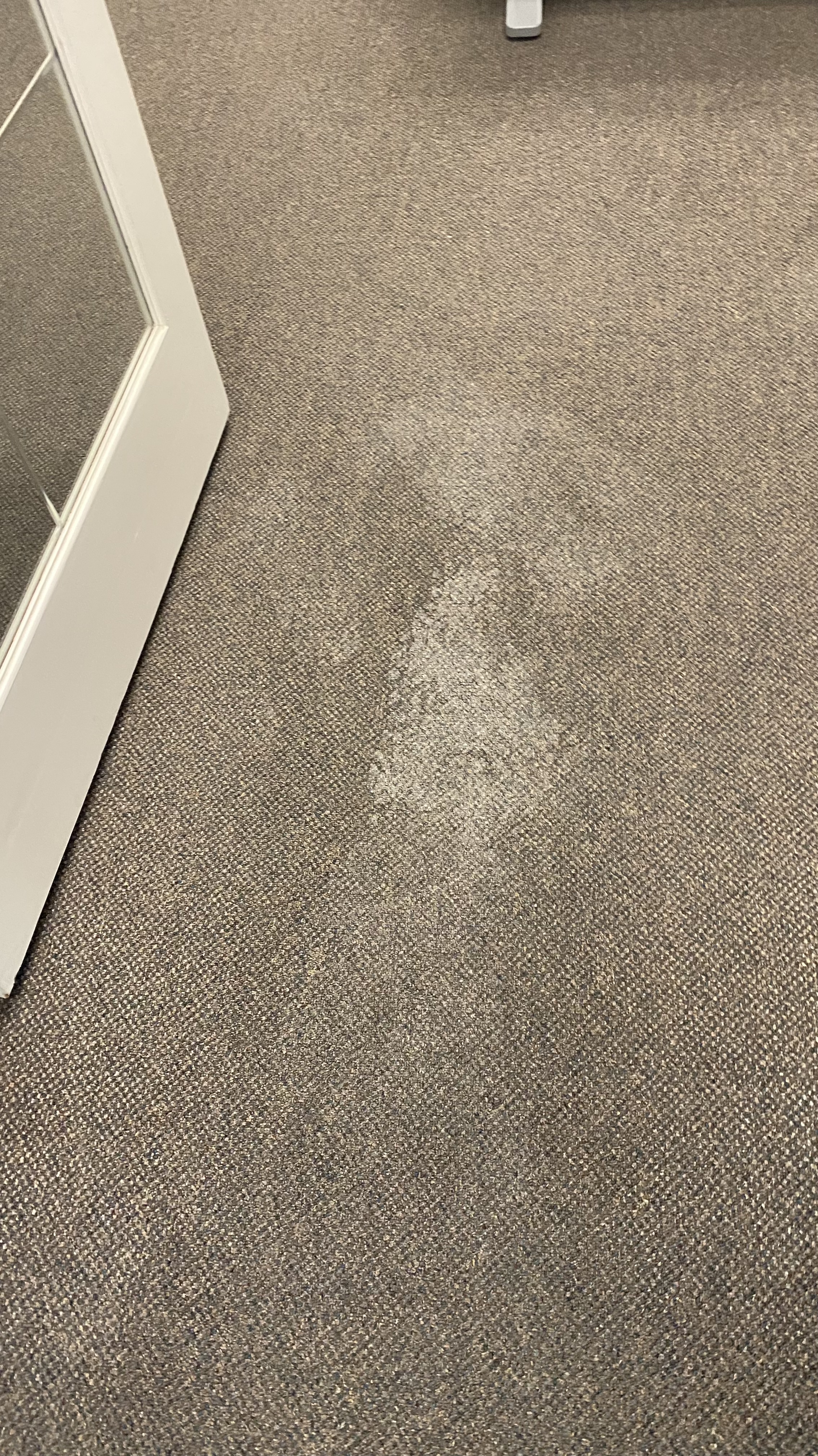

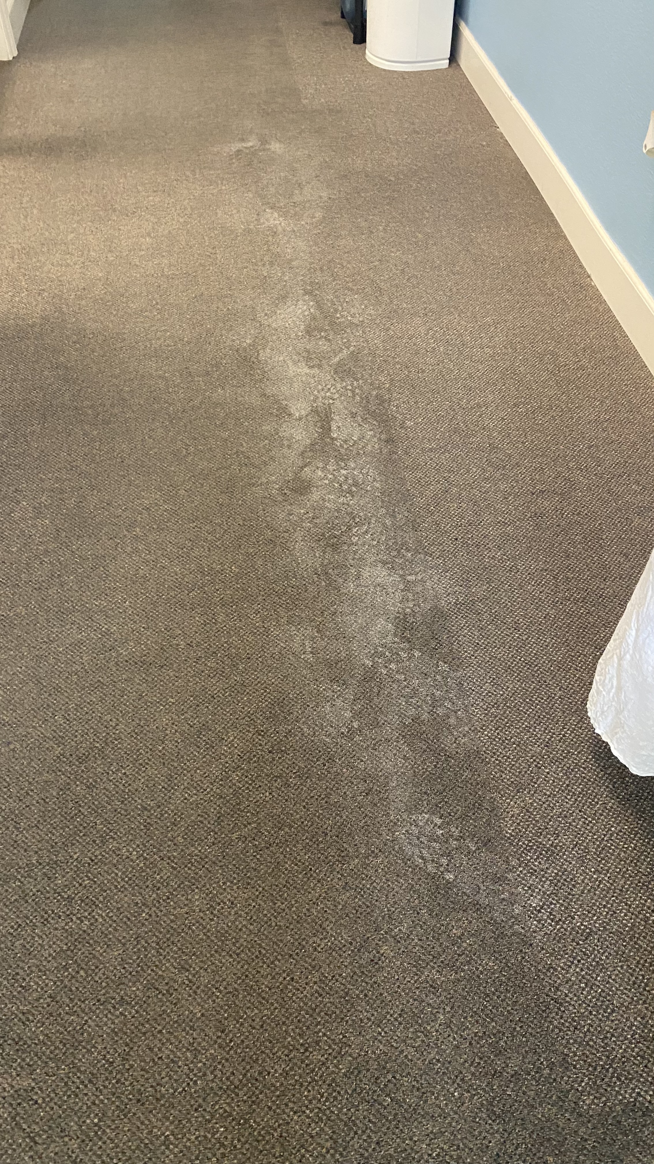

Used Green Dragon encap powder for the first time. I’m not impressed. I should have just used my normal Awesome encap or Angry Lemon or DS2.
Got a call back from the customer saying there is white chalkyness in places. Going back tomorrow night to reclean.

Yeah. I’m not telling the customer to vac it up. To me this is an unacceptable result. Never had this happen with my other encaps. The customer should not be required to do work after paying me for a cleaning. I’ll fix it tomorrow. Who knows, maybe I just need to vac it.
Fix it correctly by rinsing it properly

You might be able to vacuum that out. Was it mixed up good? Maybe you had unmixed powder getting put down?
I don’t use Green Dragon or any of those VLM powders. Was always too afraid of something like this happening.

1 - GD dragon isn’t a stand-alone encap at all.
2 - If you just poured the powder into you tank, then that’s the problem. It has to be mixed up first.
3 - GD is similar to Procyon and a Carpet Details.
