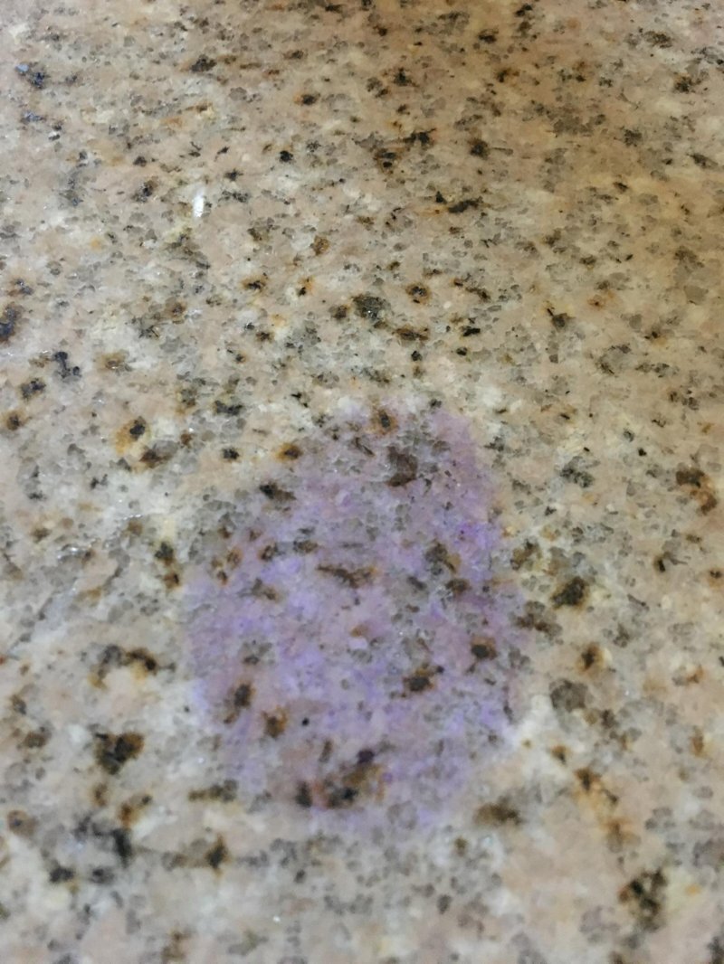

Custy used some Acetone and lightened it but still not all the way out..Suggestions?

Agree with Mikey keep trying-
Dont rub-if the acetone doesnt get it all try below.
Try paper towels folded about 6-8 ply high placed on top of the stain.
Wet the towels with some bleach and let sit for an hour or two-
Should do the trick-if not maybe an overnight poultice of hydrogen peroxide

Try Isopropyl too.
Soak a paper towel in it fold it over the spot and cover with plastic wrap and seal the edges with blue tape

Wet the area with StainZONE. Cover with Stain Absorb with stone for a poultice.
The professionally formulated version works a bit better than the Heloise methods mentioned above.

Ink = Hydrogen Peroxide. Every time.
you have to be careful with ink stains and solvents, you can actually dilute them and carry them deeper into the stone.
