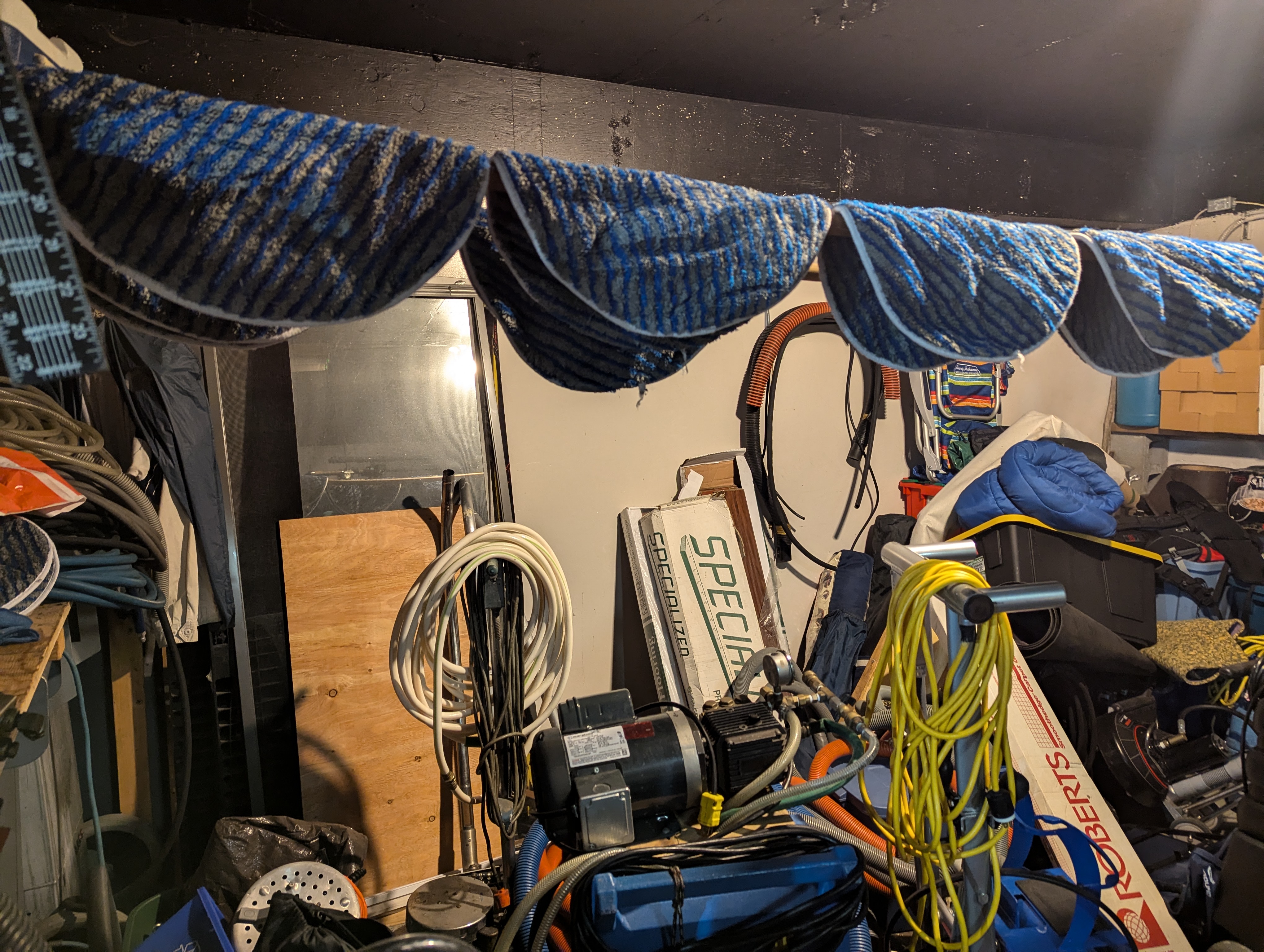

I have a washing machine at the shop but just air dry my pads.
