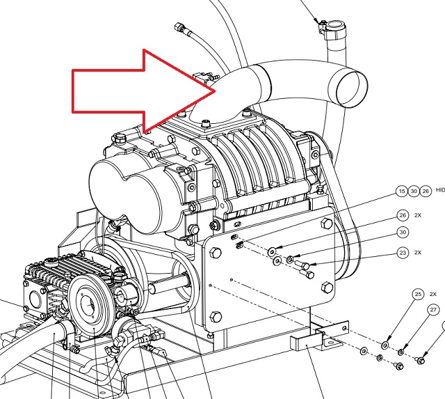

I'm not going to have a nice weekend! I have a 1999 Hydramaster CDS and last year in August I had to replace the blower. It had seized.
So now I have a similar problem, the blower still turns but there is a lot of drag, to the point that it almost shuts off the truck engine. So I abandoned the job I was about to do and scheduled an appointment with LPM, which is the local repair place.
To get a little more information, I disconnected the drive line and took off the belt that powers the blower. The driveline and the pillow blocks turn easily, but the blower is really tight. It can be turned by hand but not easily. It is a Tuthill Competitor Blower Series 21/22/23. I tried to call Hydramaster fo find out what could be the problem , but nobody picks up the phone. According to the manual I have 24 months warranty, but what if something bad got sucked into the blower, would that void the warranty?
I don't understand how blowers work, so I have no idea how the air flows through it and what could possibly get into the intake, to cause the blower to have resistance like that.
I understand lack of lubrication could cause it to seize, that is not the case here. Maybe some metal object in the intake could seize it also but it's not that either. Nothing that might have gotten into the tank even punctured the mesh intake filter.
So what could possibly make it so sluggish that you can barely turn the driveline by hand?
I have an appointment at LPM in Spokane on Monday, but I sure would like to find out a little sooner if I'm looking at a possible second blower replacement or if that is something that could be fixed.

I wouldn't open the blower just pop the inlet piping and look in....and give it a spin to see if it spins freely
but based on your last post it almost sounds like there is a vacuum that can't be broken that increases with rpm bogging it down........like something stuck in the inlet system or collapsing (could be on exhaust side too)

have you checked your vacuum relief..it may be stuck closed...and not allowing the blower to breath and bogging it down......

This may not explain why the blower is hard to turn by hand but if the engine is bogging down you may a restriction on either the suction or discharge side. I had a unit with a blower heat exchanger. The coil inside the exchanger moved and restricted the air flow out of it. This cause the engine to dramatically bog down after it reached a certain rpm. The blower could suck all the air it wanted but was unable to discharge it.

do you have a missing towel.....
seriously...turn machine on and drible some clean water thru the intake....slowly increse volume of water till the blower either straightens up or blows up whichever first

Has your waste tank over flowed recently? If so do what Bawb says and flush that blower out with lots and lots of clean water with it running... if its really gummed up with grease and oil, take a cup of Kerosene, turn the machine on and dump it into the blowers inlet. The blower exhaust will smoke like a mother, but It will get the gunk out. Then follow with lots of water, and then a 30 second shot of WD-40

Schaeffer Penetrol lubricant........
there is probably the problem right there....this stuff is leaving a build up and causing the blower to stick....
willing to bet you flush and clean the blower out it will loosen back up like mentioned above....
this is one of those things that some people agree with and some don't but I never ever spray anything down inside my blowers...things like this happen where they start getting all gummed up and it also gets on the heat exchangers and starts plugging them up.....
what I do is let the machine sit and idle...cool everything down..and clear the blower and dry everything out while I am picking everything up and wrapping up my hoses....I have pulled the inlet pipe off and looked inside to see nice clean blowers that have 1000's of hours on them....and I have never had one give me a single problem.......

I totally agree with Jim, don't spray anything in the blower just let it run and cool at the last job of the day.

My 5m was clean inside with very little rust. I only lubed it a few times when I accidentally sucked up water from a stuck float switch. I do like Jim, I let it cool down before shutting off. The heat evaporates out the moisture. Spray a little wd40 or similar on your bike chain and watch how it collects dirt and debris. No thanks. More than one person here has sucked a rag into their blower but only when working on it. You can't do that past the filters.
If you start by finding the belts that were slipping you'll narrow down your problem. Your assuming it's the blower because you had that problem before. With a cds it could be bearings locking up.

So find a field to park over and suck in some kerosene to clean out the muck and go lubeless...
Will this void warranties, Ron?
It's rare i lube blowers too
But did try Bob's plain, clear water rinse technique.
First time I'd heard of it was from him...thought he was nuts...til i tried it
While the blower is running and hot, i trickle water thru the spray lube port..it really does the trick
BUT, BUT, BUT, i don't have blower HX'ers ..I wouldn't want the gunk 'n crUd slurry that I see coming out of my blower going into HX'ers, that's fo-sho
I will say with absolute certainty, Bob's way is the cat's azz though
