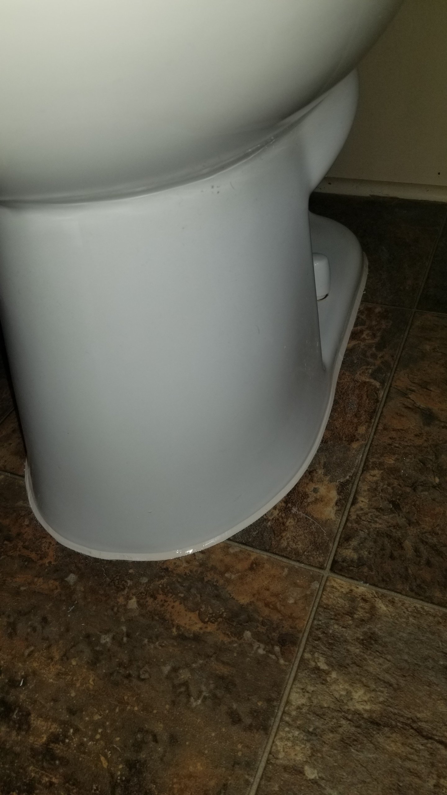

It was my toilet. I was just testing the the profile tool. I do prefer smaller bead.

Maybe it is because of the way I grew up seeing it but sometimes when I see your jobs I think "that doesn't look right".....ever get any customers like that?
115,984
No but I know what you mean and most people are so used to seeing caulking on both sides of the gap that I tell them up front that I'm only going to fill it then after it dries the next day when I return which is often the case to do more they agree with me that looks absolutely killer and seamless from just a bit of a distance.
Caulkins and silicones fail when people spread them too far onto the walls and tubs as they get thin and they eventually peel back from movement or over cleaning and dirt and debris get behind them and the mold starts and it's all over with.
Only fill the gap.....

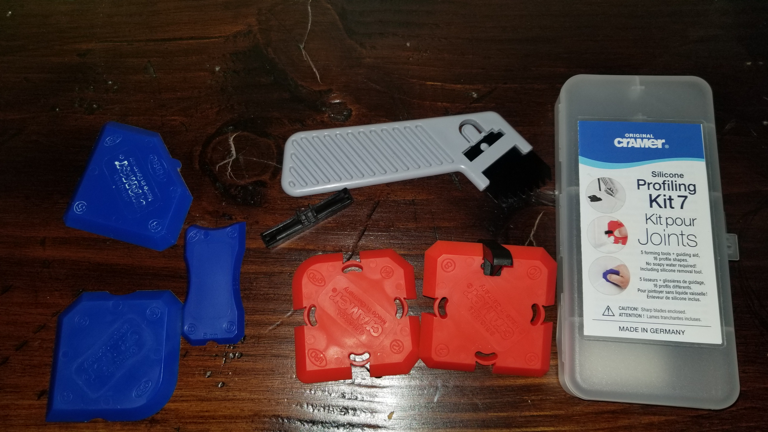

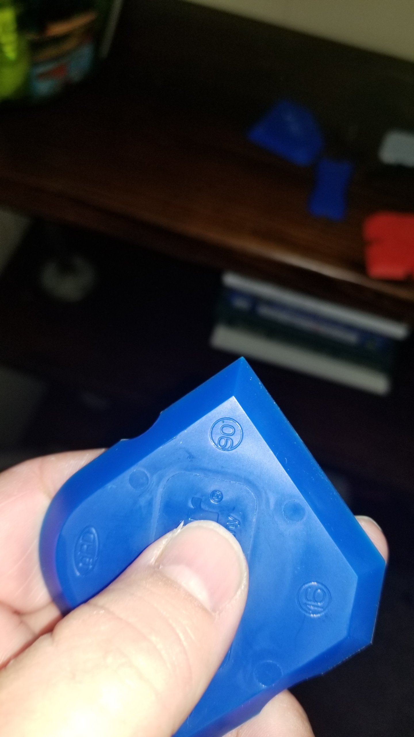

That's what nice about this profile tool. It cleans it up real nice. I agree about bead being too big. It can be pretty unsightly.

Ill be removing it tomorrow to try the 90 degree profile to keep on the edge and fill gap only.

I had a flash light. Yes, no matter what you use, it always leaves a skin. I still had to clean up with towel. But what was nice about this tool, it left behind very little skin up on wall or floor. So clean up was easier.
I was at the demo station. I did a lot of it.
