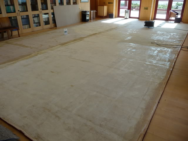

Not teh sort of job to want to run out of glue so far from home... was it at the end of the day?
John
117,376
Yeah, no big deal on the glue. We finished at 530 pm
I found 12 gallons at a local supply house for tomorrow.
117,376
If you knew what I am getting for this job you'd do it naked a with a glue gun up your butt.
Sold em new pad too :D
117,376
I doubt paint rollers would have worked it in deep enough.
Those trowels were working over time.,
That damn thing was THIRSTY!
I'm afraid it will be,glued to the floor in the AM.

Spent a good part of today applying another coat of latex and getting the new Durabond ready for laying tomorrow.

Trowel or scrap of low-nap carpet is the way to go because you need to press the adhesive through the existing scrim and get get it into good contact with the tufts. At the same time, you don't want to put it on too thick, or press it so hard that it seeps through to the face. Good for you for taking this on, they will now consider you their very own expert and work at that facility won't go to the lowest bidder. The rug will also be easier to clean now that it has a little more body.
PS: Buying material based on someone trying to help you from looking at a photo, and complaining about it? Bite the hand and you'll get no more help you big dork. :lol:
117,376
Snow Job knows I was kidding you even bigger dork.
and yes, rollers would not have gotten the glue in deep enough.
I only hope when the 4 of us go to flip it tomorrow it's not stuck to the floor.

who takes the risk on this deal you or them. Meaning if you ace it up or it just doesnt turn out good. Are you on the hook for replacement? or do you still collect you dough and tell them tuff dooky....
117,376
If it goes bad I would no charge them and they can buy 8 Ikea Specials to take it's place and come out way ahead.
Seriously, what could go wrong?
G
gasaxe
the main thing i was thinking about was the glue "bleeding" through into the face of the rug. I dont really know ive never done anything remotely close to that. None of the tight asses in my neck of the woods would spend that kind of money to fix one.
