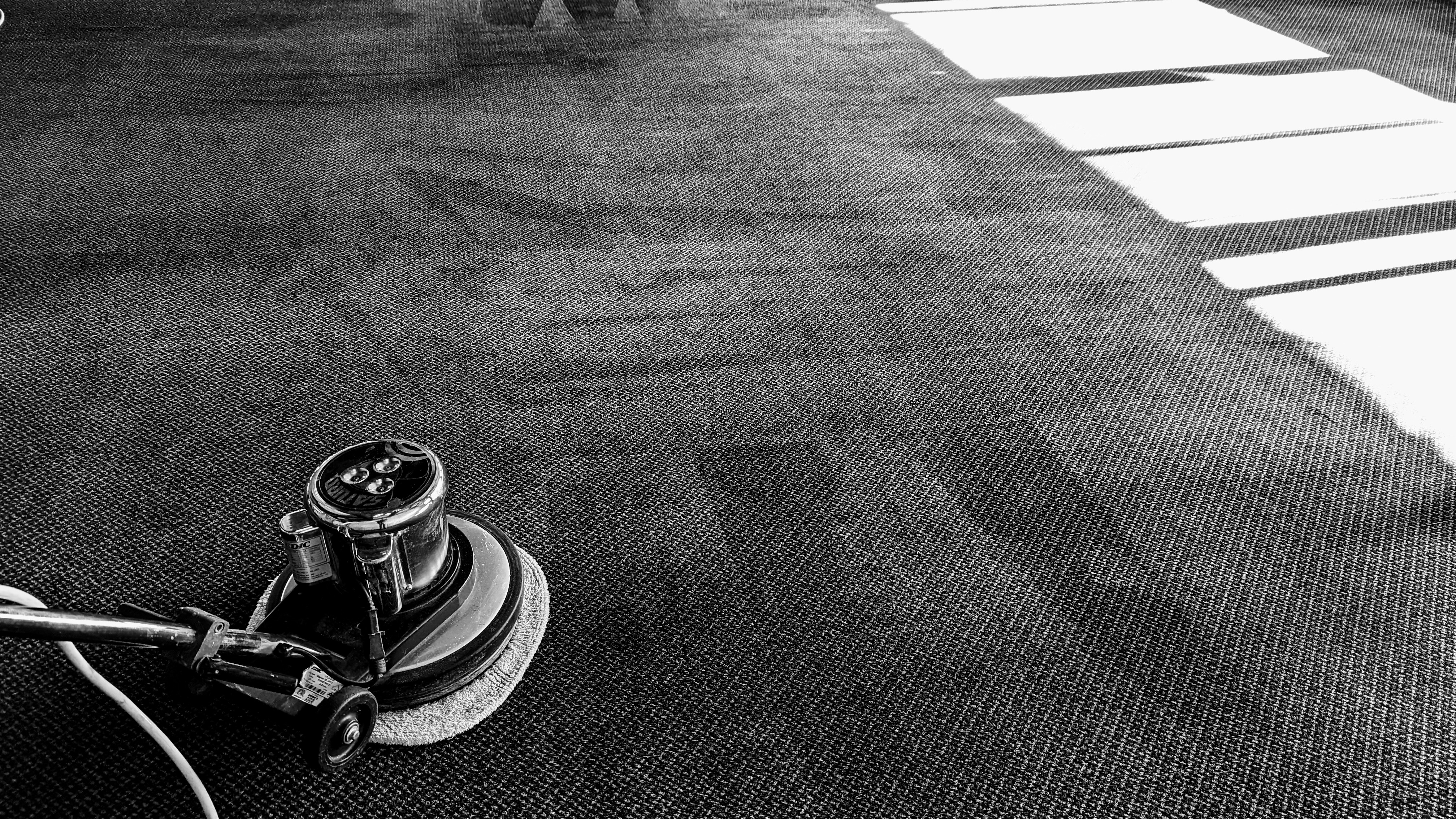

Its been eons since Ive post padded with a 175..
115,991
worthless compared to an OP.
No digging in whatsoever.
Reactions: Johnny and Nomad74
I do it once a month on some elevators. Hwe every quarter. Its commercial carpet so it does a good job on them. Looks better than the HWE but we all know it's not cleaner.
115,991
The idea of post padding was lame, but it led me into pre scrubbing back in the days just before rotary extraction. It made a huge difference in commercial cleaning.
Post padding resi pile is lame but funked up olefin GD, it has some benefits...
definite extra soil removal, friction drying of sorts, leaving an encapymer behind to act as an anti wick/protector, until the check clears...
