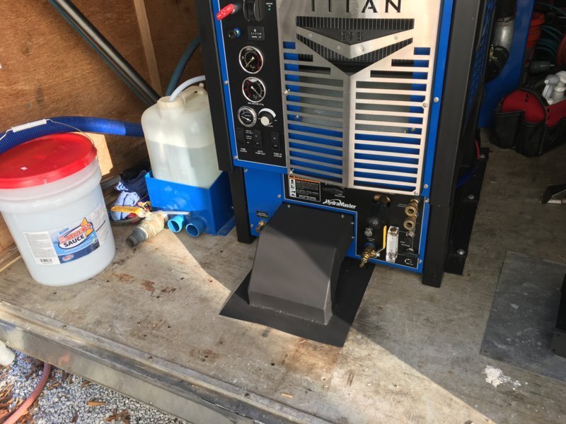

It's gonna be nice with my exhaust going under the trailer
14,632
I don't have to worry about getting burned, or getting smothered in the aroma of dog piss after a bad job
Of melting a hose or any other plastic that might rub up against it.
It looks nice and clean with that cover. :cool:
14,632
I'm not worried about anything touching the metal
I was more concerned with the exhaust blowing on my vacuum hose, melting it that way.

But I couldn't find a decent exhaust kit for my Titan, so my local handyman/welder said he could make a clean looking extension. What kind of tm do you use?

I'll be adding that to my list of things to do when I set up on a job. Yesterday, I parked over some crush-n-run gravel. I had to wet the gravel underneath to prevent dust from going everywhere. If I don't like it, I'll be taking it off and just putting up with hot exhaust and a the funk of the waste

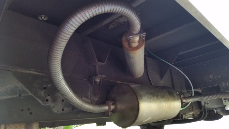

It makes it so much nicer inside...I had a muffler installed under the truck, then installed a second heat exchanger...
HydroDude
Dec 15, 2006
379
JB
Purchased a used Whitèmagic Pro 1600 couple months ago . ..has been trouble free, with exception of replacing a couple fittings and installation of the heat exchanger . ...simple design easy to get to all components .
