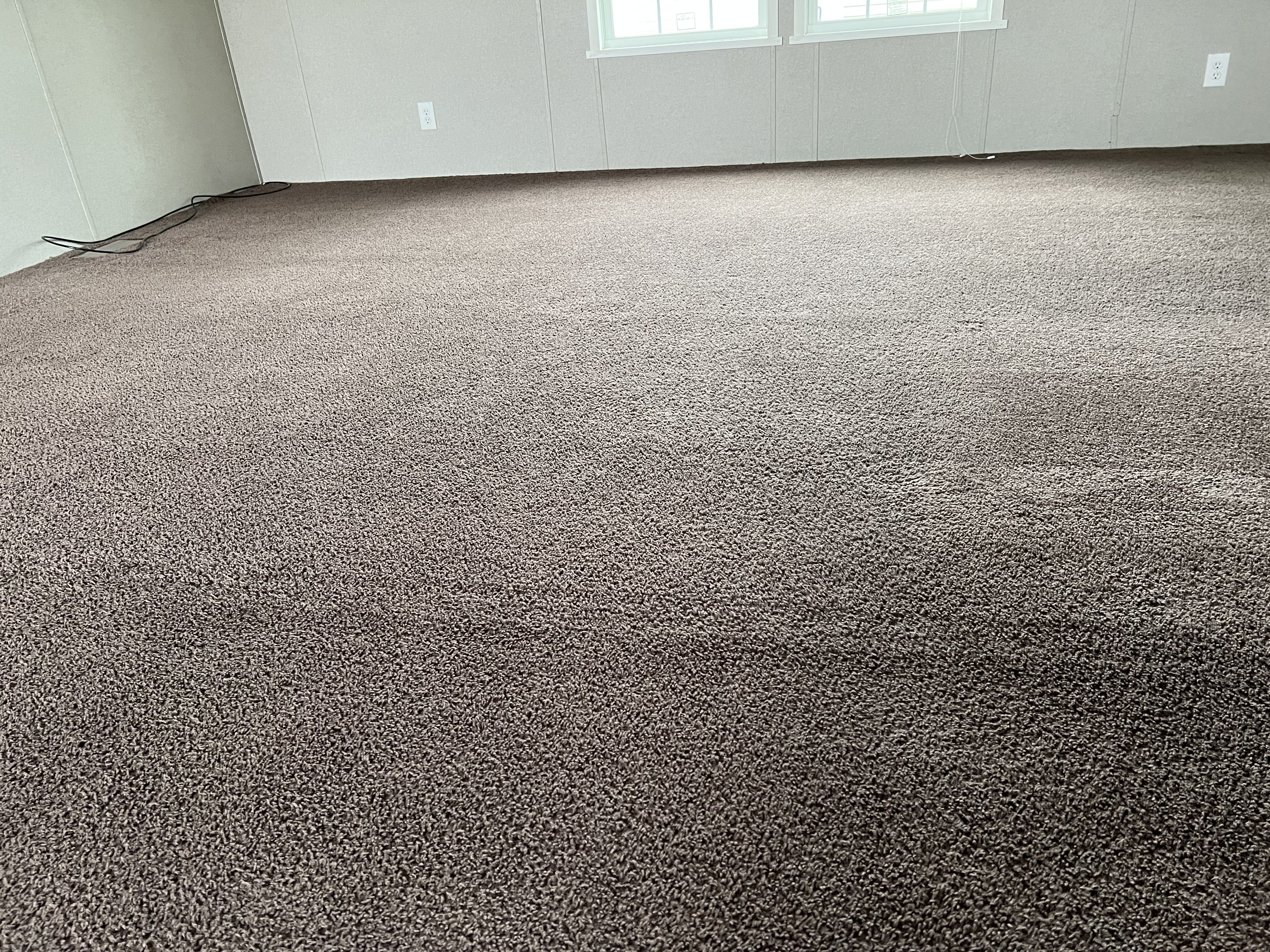

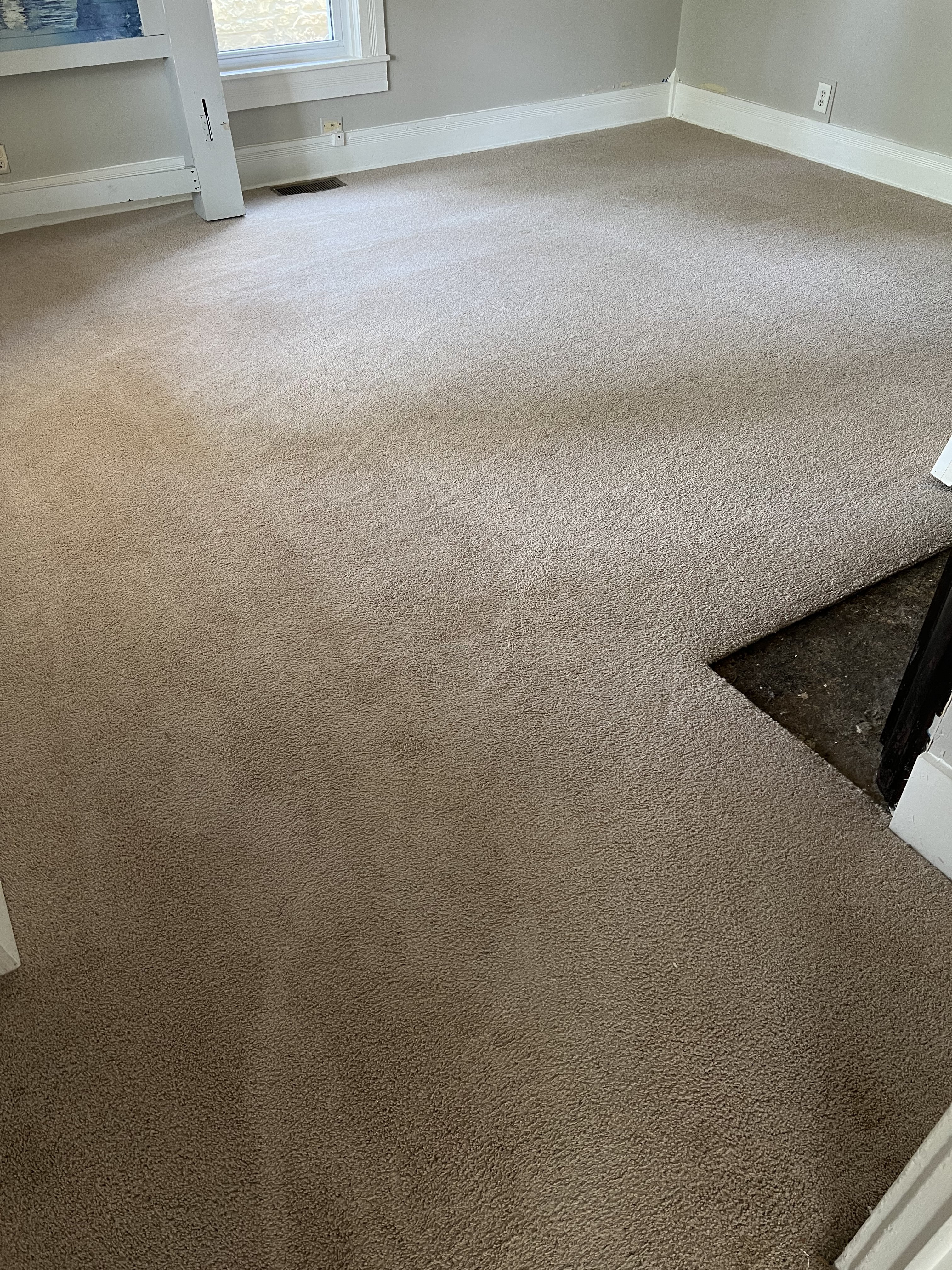

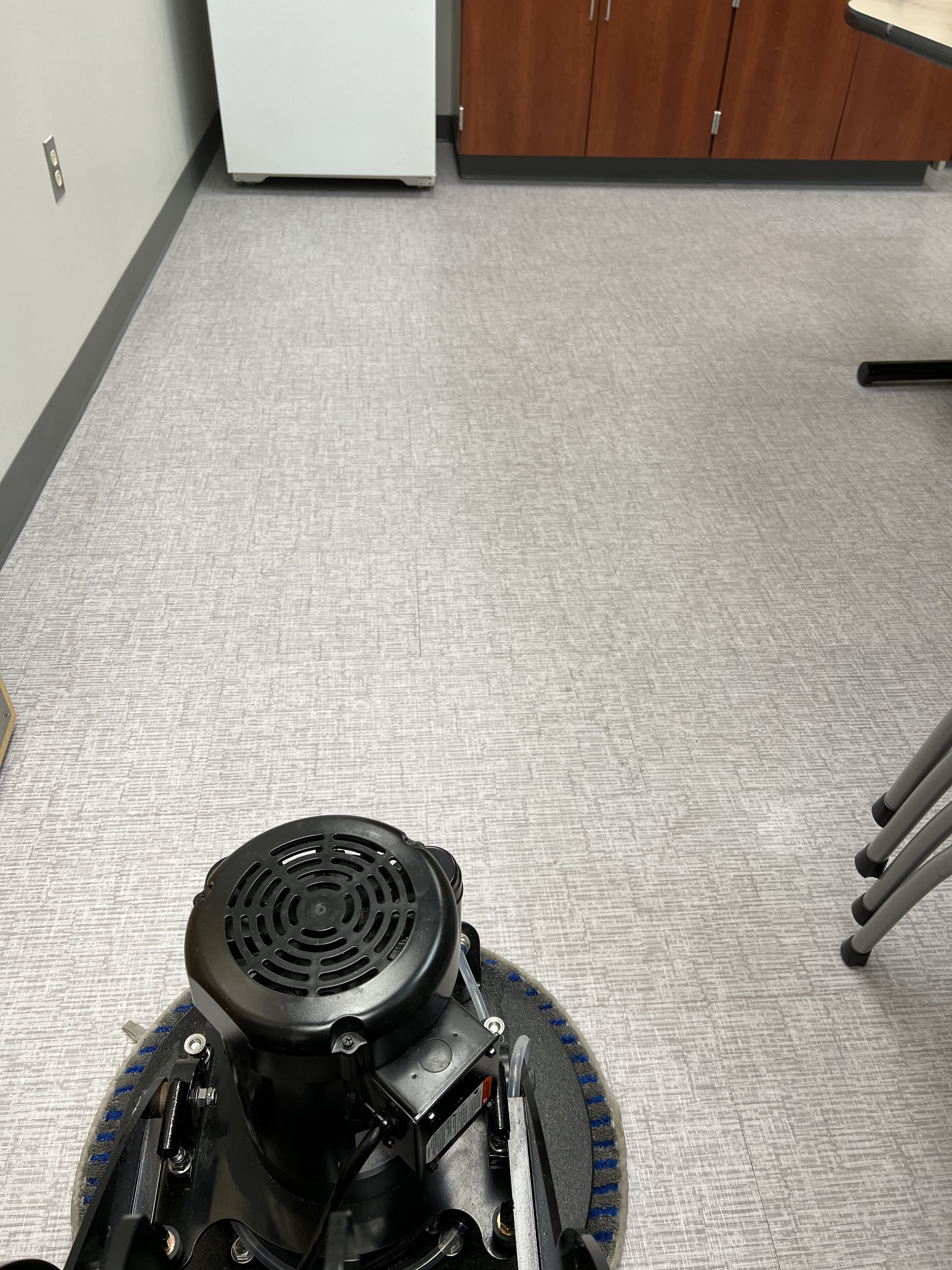

We used the Phoenix and Cimex today in an empty trailer. Cimex on the carpet while I used the Phoenix on the sheet vinyl flooring. Then I went over the carpet with a blue micro under the Phoenix to finish up.
It’s quite versatile. I’m also thinking where this machine truly shines isn’t necessarily carpet, but the LVT/LVP/sheet vinyl floors that have become so popular over the past few years. It chews through that stuff like a buzzsaw. One pass with an appropriate floor pad and a small spray of neutral cleaner every other step, one pass with a micro to pick up the slurry. Finish with a flat mop.
Pics from today, a rental from last week, and some vinyl tile. All using the Phoenix, except for today’s where we incorporated the Cimex on the carpet to save time.
One negative I will mention, I had a carpet that was a shedder and whoa… it was a little concerning, but turned out ok.

Carpets that shed like crazy that I would hesitate to use the Phoenix on. Just using the crb with soft brushes pulled tons of lint out of it. That's after vacuuming.

Didn’t noticeably shed when I vacuumed it, when I saw the little balls of fuzz everywhere I thought I might have ran into a wool carpet (in a junk rental house…). A quick burn test showed it was synthetic.
We ended up vacuuming afterwards (carpet was dry) and pulled two cans out of about 1100ft2.
I need to get a CRB, it’s about the only thing I do T have at this point.

Won't the thumping action of a Trinty damage the seems of thin engineered flooring?
