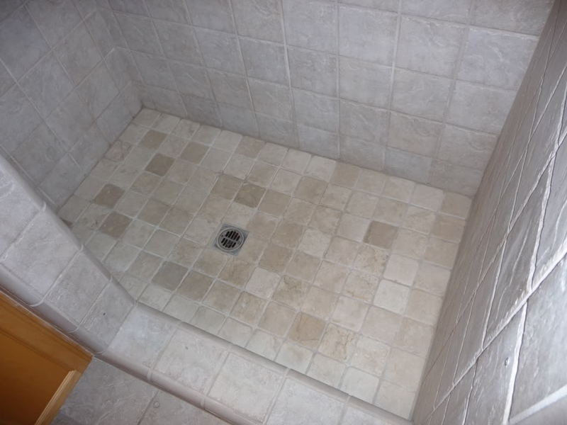

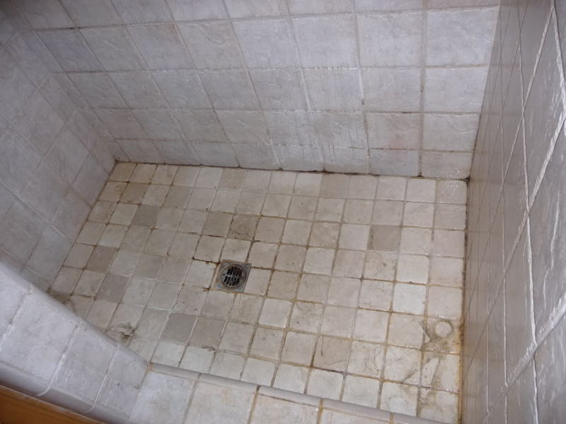

Great job. Could you explain briefly how you restored the tile? I have been turning down jobs because simply cleaning a shower stall does not get satisfactory results for me. What do you do if the grout is chipped or stained?
Thanks
116,020

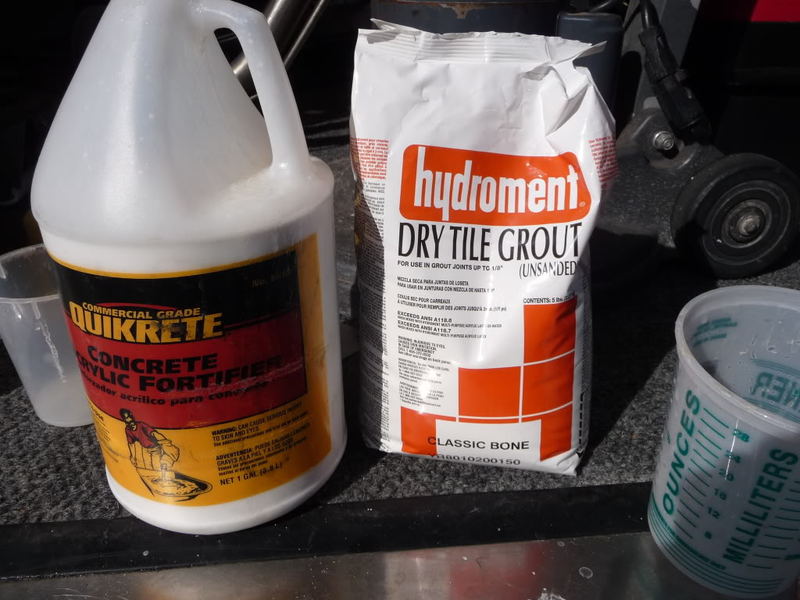

No "restoration" was doe to the tile other than cleaning.
Grout is easily repaired if stained or missing. Dig out the damaged stuff, mix up some fresh using a acrylic additive/modifier instead of water.

To answer a few questions. Like concrete, grout does not stick to grout. I use an additive and remove a minimum of 2/3 the depth of the grout line as advised by the TCNA.
Don't use the Dremel rotary to remove grout. It makes a dusty mess due to the speed of the tool. Dremel just released a tool very similar to the Fein multimaster. There are are a few guys on DirtyGrout testing them. They should do fine if they are not used daily and only for repairs, not complete regrouts, as I don't believe they are as durable as the Feins. They run about $100.
I like Laticrete Latasil 100% silicone for caulking ANYTHING. GE is a very distant 2nd best. Do not use DAP, it stinks, and is very difficult do use and clean up and really is not a good caulk. Do not use latex, acrylic, or siliconized latex. They will all crack and mildew. If you will be caulking showers, use the best possible 100% silicone caulk.

I get Latasil caulk from Century Tile here in Il. Not sure who carries it out there. Floorlife.com has it. I usually use Laticrete Bonding Admix. Really any grout admix will work.
