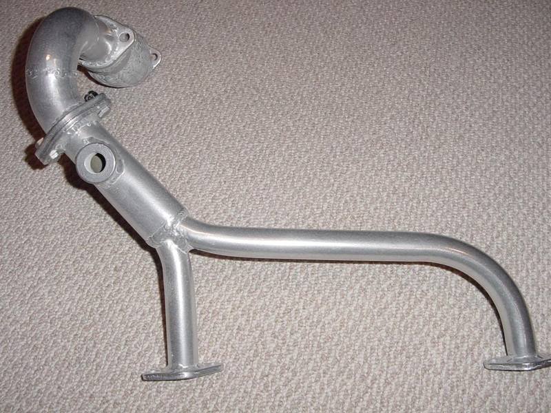

Ok we have put our garage mount together with the 31hp aegis efi motor, I haven't had a "slide in" for some time, mostly direct drives...
Starting at around 1500rpm under no load, the exhaust manifold I welded up glows CHERRY RED... I've wrapped it in that "titanium exhaust wrap", and you can see the red through it', i even made it 2" all the way to make sure there was minimal back pressure
. Is this normal? Here are some pics:

Personally I would get rid of the wrap.. My 25 horse Kohler will glow also, though it has to be a lot darker to see it. I always thought a larger pipe would help.. Maybe if those two pipes coming off the head were shorter it might help?? It might also help a little if you elbowed out of the first head to get it flowing out right.

Thanks for the reply Larry, I sprayed the manifold inside and out with VHT ceramic coating and had it baked, will this prevent the corrosion?
Also, this motor has a total of 24 minutes run time, brand new :/
I designed the manifold to be free flowing with 2" all the way, other manifolds I've seen on TM's use 1" all the way, with bigger motors than mine.... Maybe the velocity of the larger diameter exhaust is too slow?

It's normal. The carbon steel won't last. Doesn't matter if it's wrapped or not, coated or not. Been there done that. The only thing that can be carbon steel is the head flanges. You may also have trouble with it cracking between the tubes because of expansion. If you're not using the exhaust for heat I'd get an exhaust manifold/muffler from Kholer. This one was made with SS pipe and carbon steel flanges and sensor nut. It was also mig welder with the wrong wire. It eventually burned up the welds, nut and flanges.
