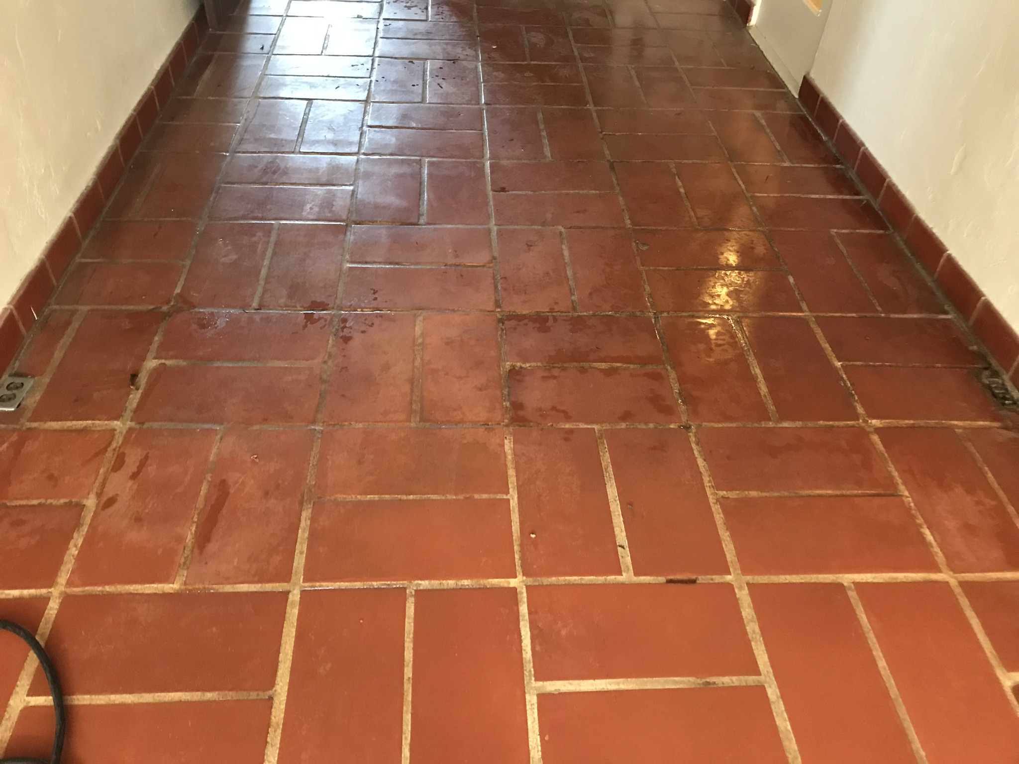

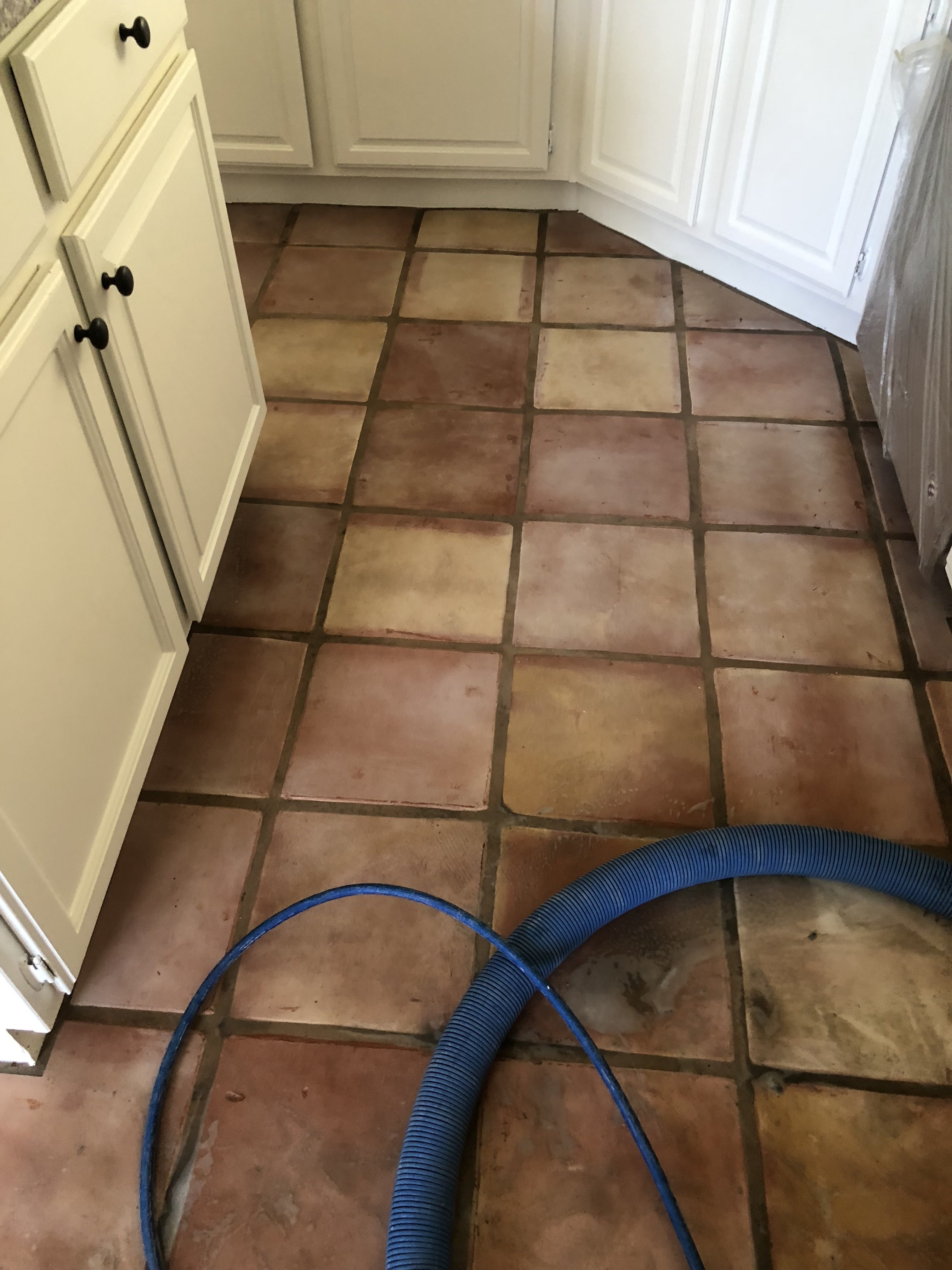

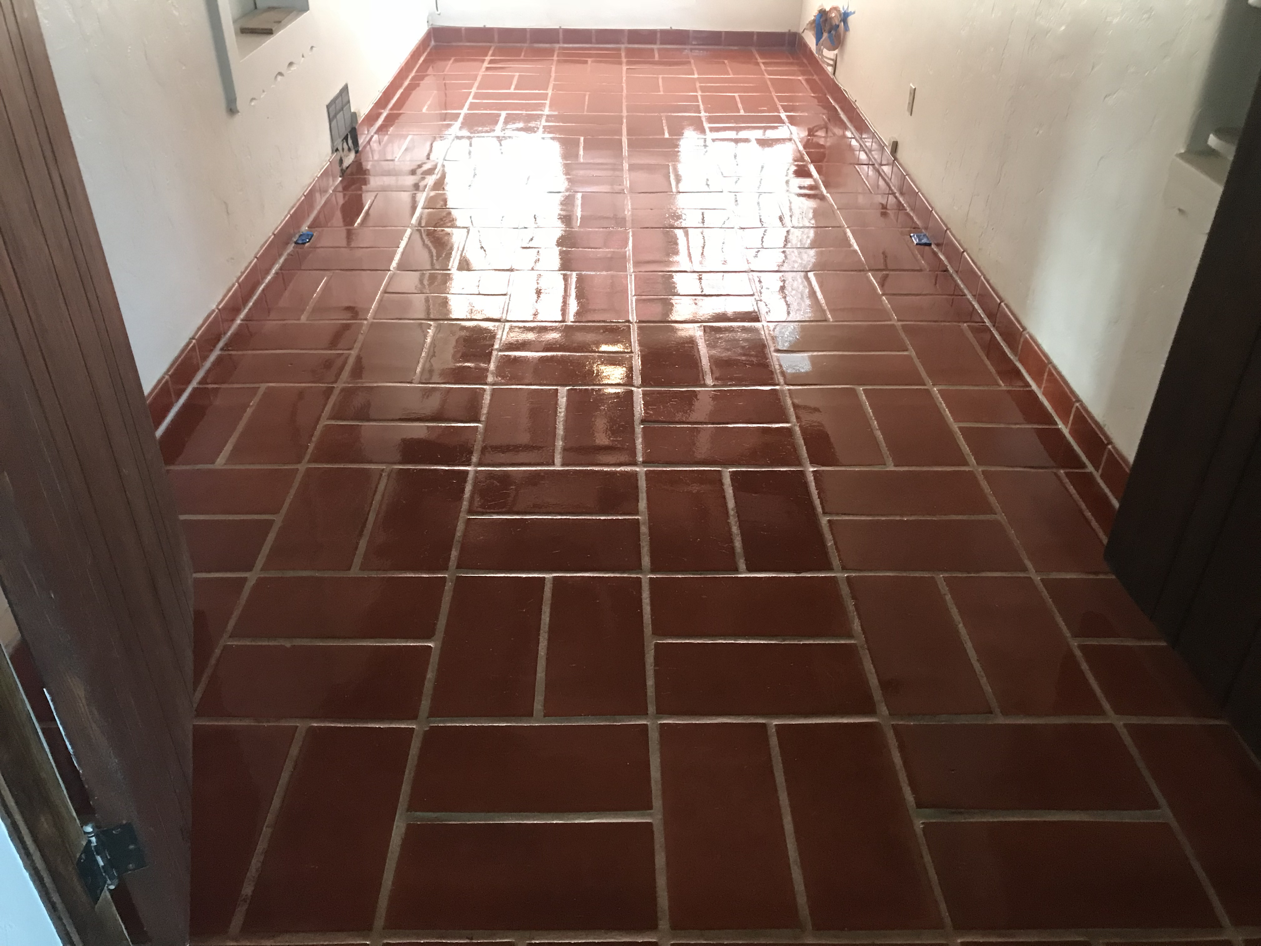

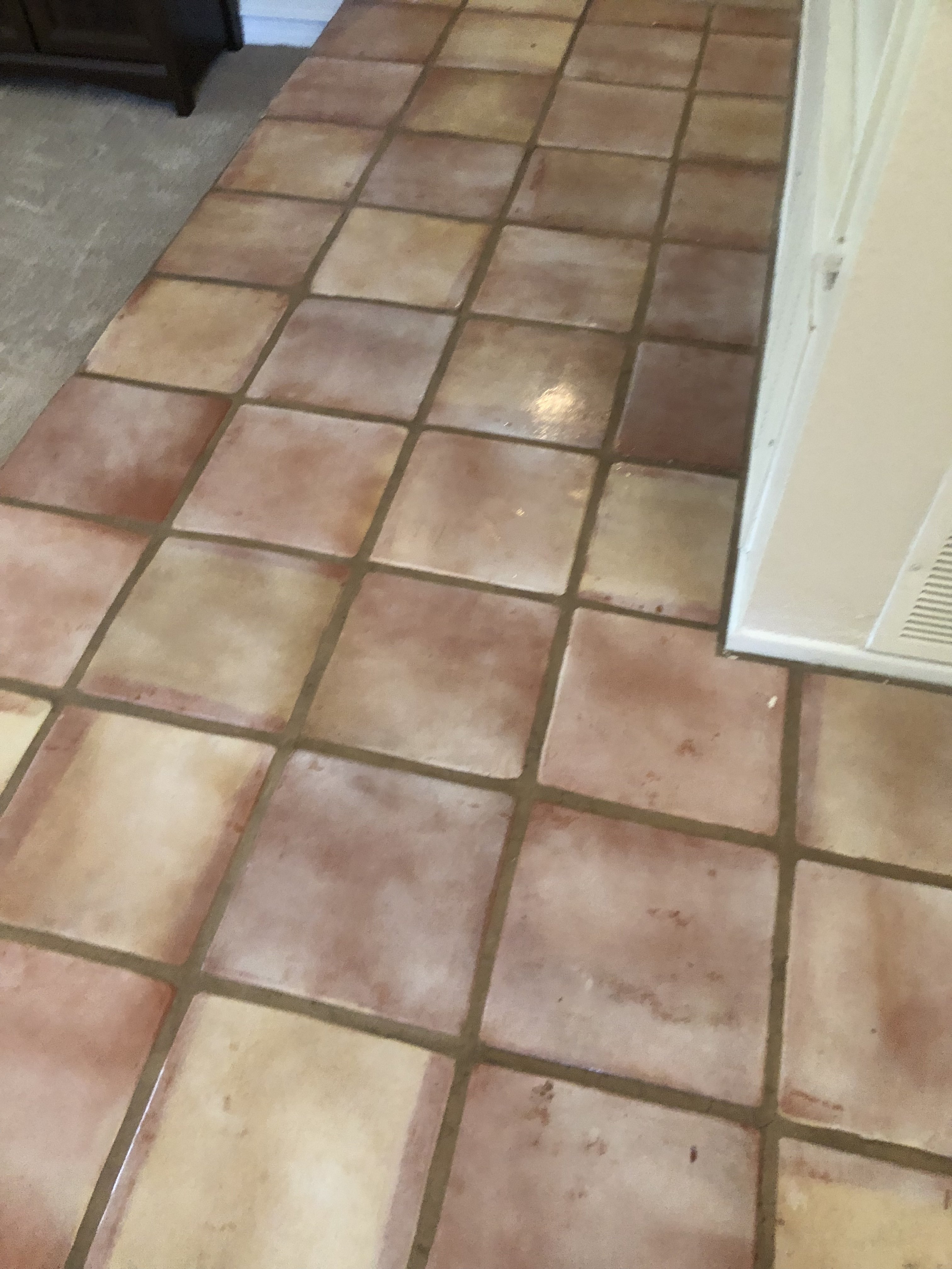

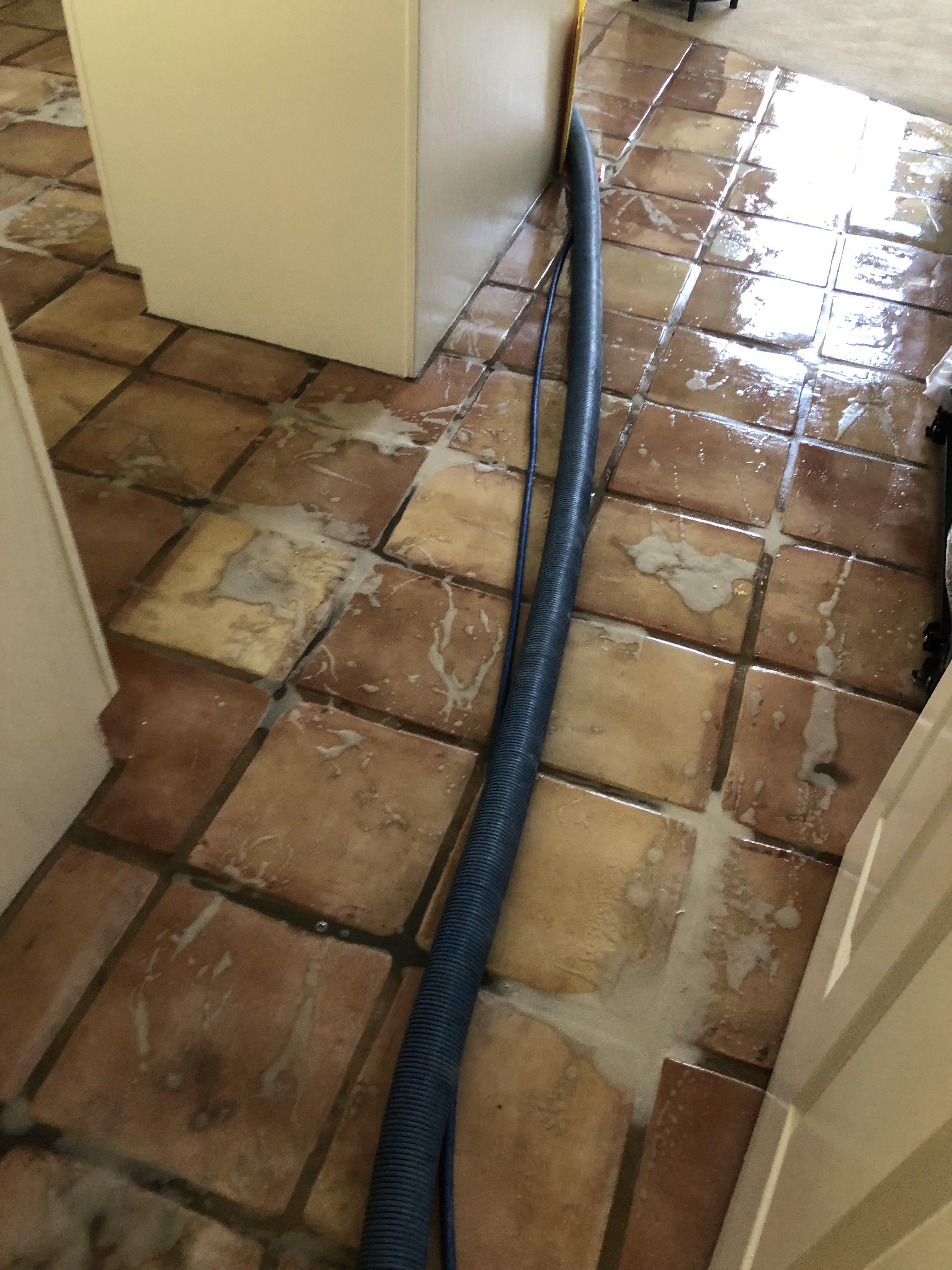

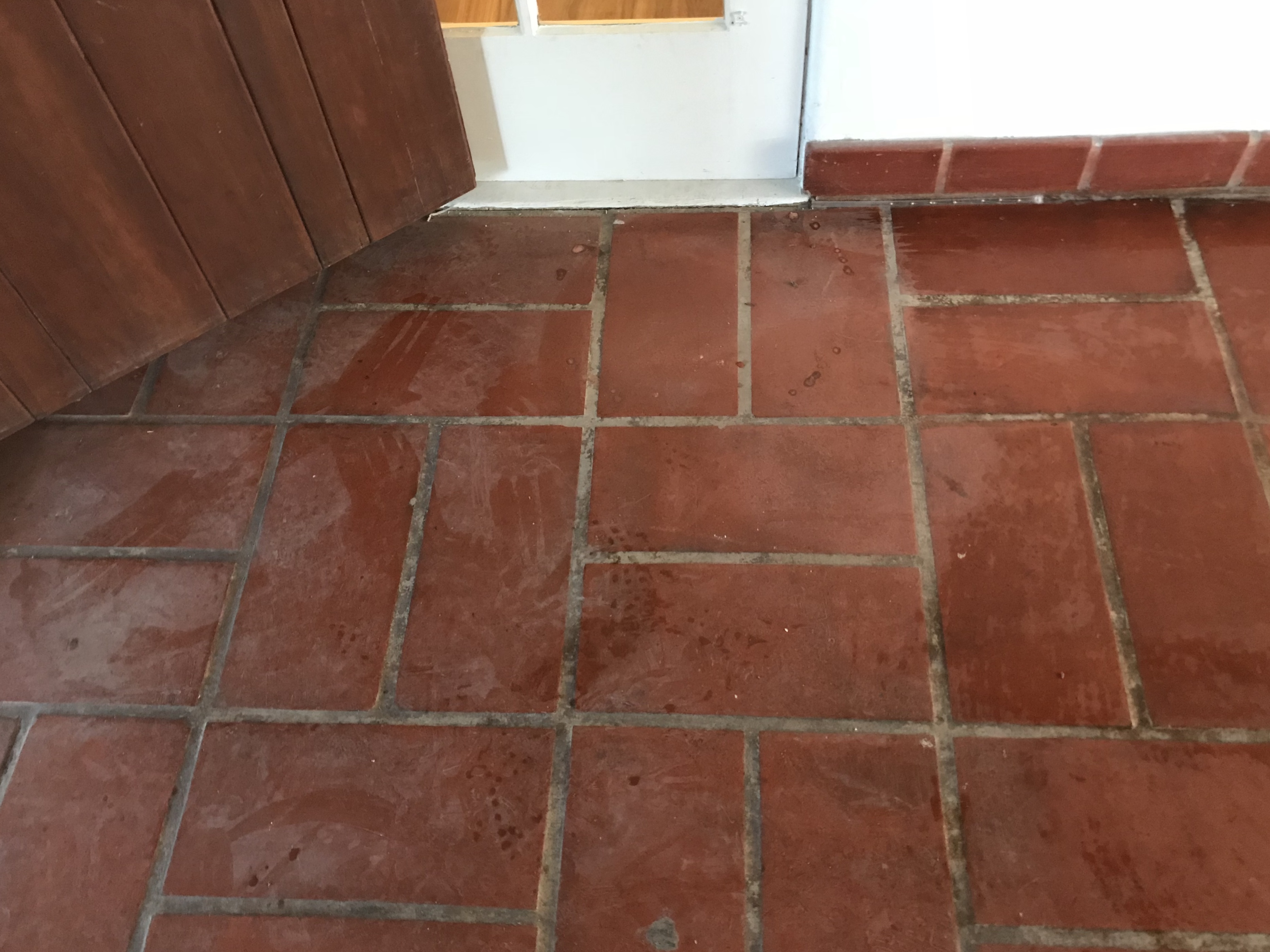

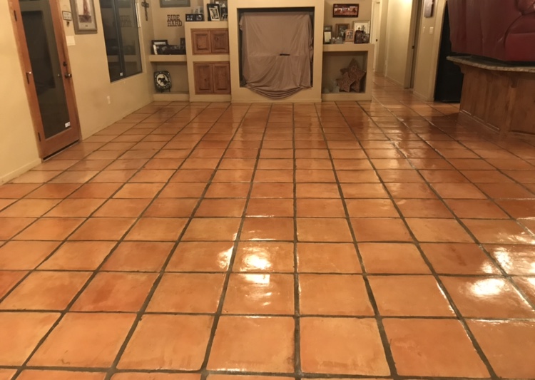

Terra Cotta clay pavers,
That had a coating real dirty.
@Mikey P said hit it with a nuetral cleaner and light scrub, low psi rinse.
Well I declined it at first, but she called and said please.
So I hit it with slop and gobble but added last step to lower the ph!
White brushes crb and 300 psi with a gecko tile wand!
It cleaned up real nice the lady was happy!

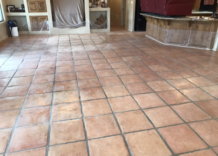

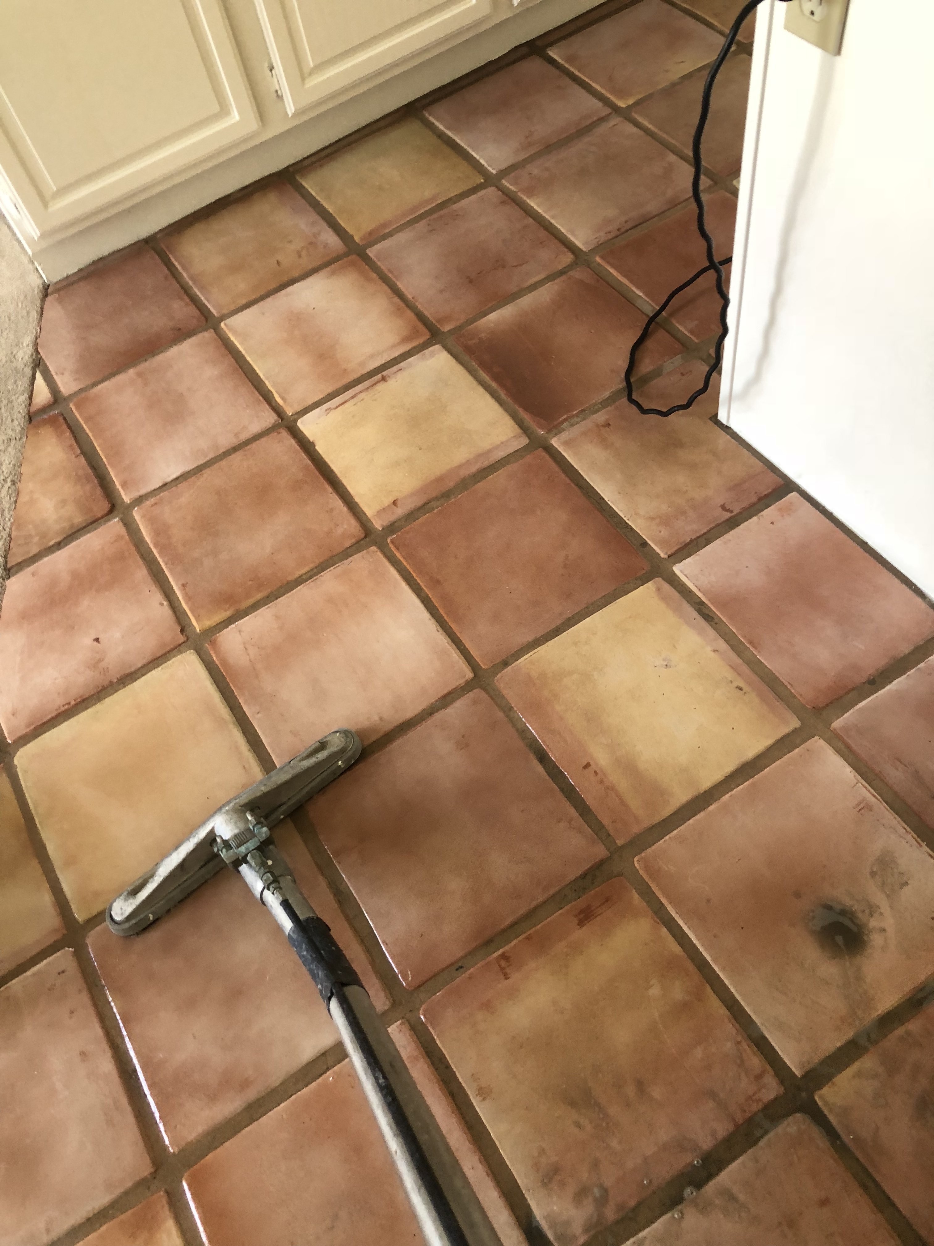

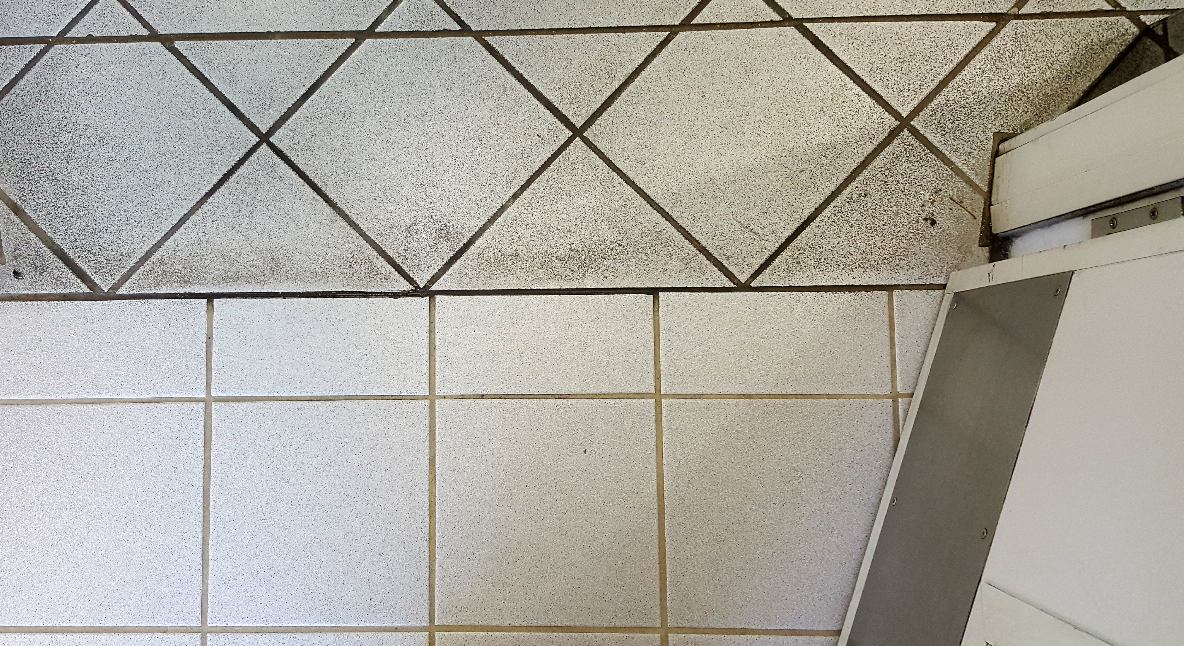

looks good, I'm no tile expert but I use mainly neutrals on tiles pic from halfway through job last week
