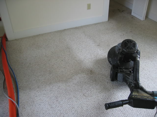

although I would really like to have a 175 on the truck because there are times I could use it the RX in most cases will do the same thing and you don't have to scrub and extract..it is all in one step....
I have gotten a load of empty home in the last few weeks and have found it much easier to rx the whole place and hardly ever touch the wand....
If your RX is leaving the carpets to wet then re-jet it to work better with your machine so it uses less water.. ( got to find that balance ).I am RXing some pretty dirty places from base board to base board and the carpets are just barley damp....also if you are worried about hitting the base boards ..get a hold of Greenie and see is he still has those funky shields that go around them....they take some getting use to and I would recommend filing the bottom edge to make it round so it glides better....I used it for awhile and finally go to the point where I can get about an 1/2 inch from the wall and not touch it so I gave mine away to another cleaner because he was always hitting them....

I gots green glides with my rx and dont have any dry time problems just like a wand you have to make some vacuum only passes
Greenie
6,820
The GuardZilla was a cool tool, pushes cords out of the way, protects base, good training wheels for newbies.
I just assumed all RXs were glided these days.
A glided RX on berber is pretty sweet.

I need to get my RX 20 running for some big commercial accounts. I am killing myself wanding these 10-20K sq. ft. monsters. Most my Saturdays booked out for a while....
I am going to see about just getting a new head. I priced parts at $500.00 to get it running straight plus glides for $200.00, or just a new glided head for $1000.00. Prolly just get the new head.
If I am running a greenhorn at 12 flow (4 #3 jets) what should I jet my glided RX at?

6 flow is plenty on mine. I have the HE head and it has 3 jets. It makes my TM hover around 200 ATM and it's plenty hot. Actually I ran out of water on one of my machines this week and the CDS kept up with my .10 flow greenhorn and my RX and both were steaming on CGD to finish a good size room. Of course the truck engine was probably about 220 and the temps outside were around 100+ so it may of been that it was hot enough for that one room and maybe would of cooled down if I kept running it like that. I may try it some more shortly, it will be nice to save some cash not having to buy propane for the 2nd machine.
