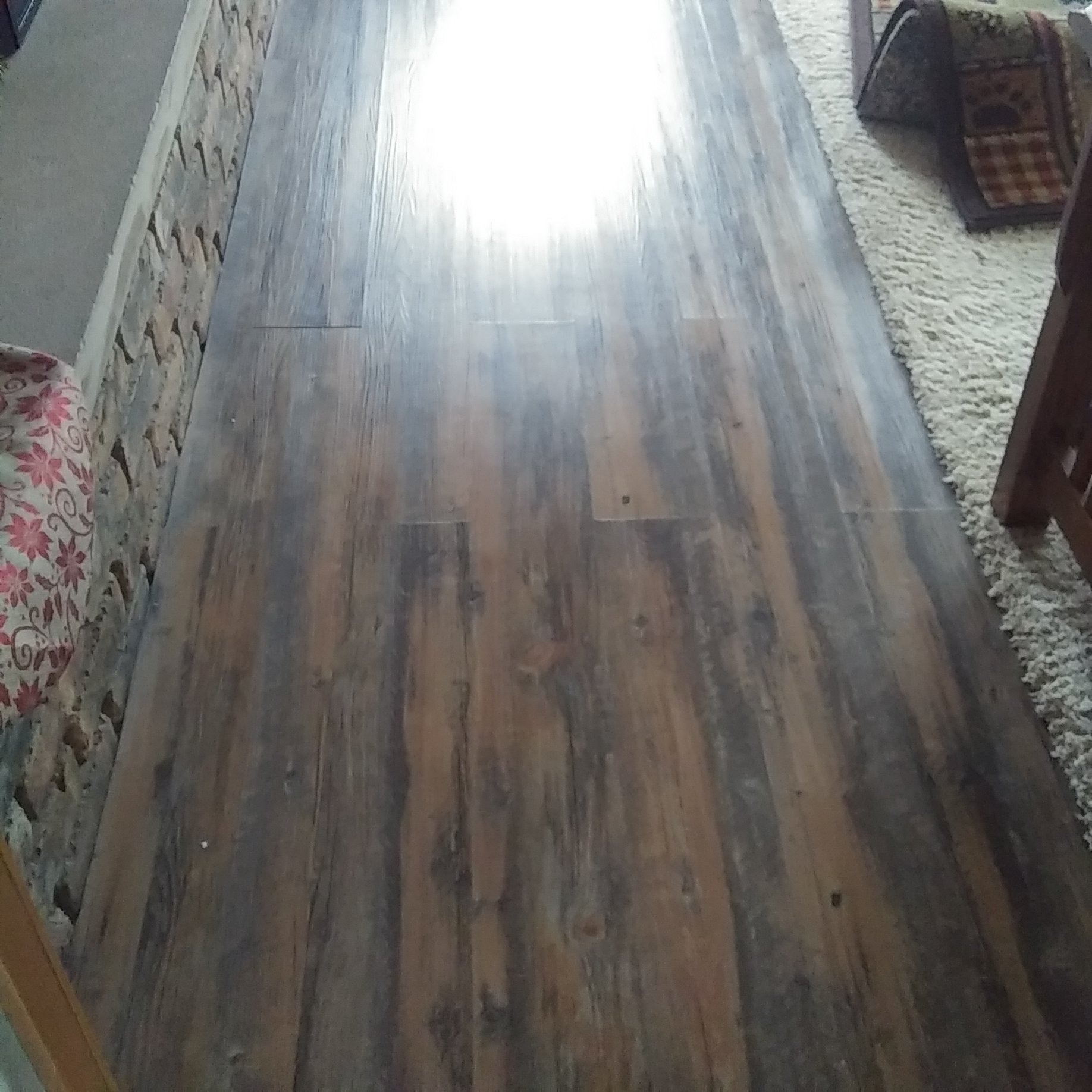

Sounds like a poor install
I’ve seen 10s of thousands of sq feet and haven’t seen what you are referring to, they snap together. There should be zero gaps

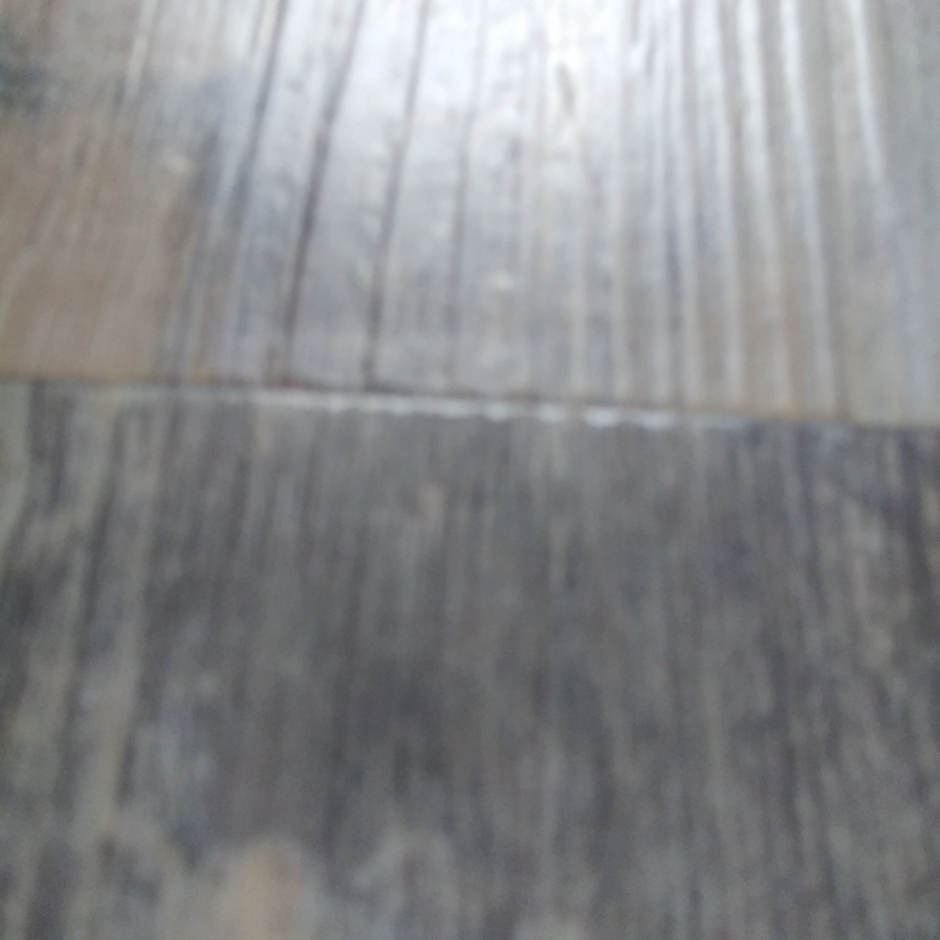

I'll take pictures today. I'm going clean a new condo. Probably not explaining it right but yes these guys use cheap stuff. But still want top dollar on the sale.
This is my poor install. On the left is the gap and I don't like how the seams kinda peel up neither. It's hard to get the picture to show what I mean. 158022472976789269025994049242.jpg15802248201718198526891532401488.jpg
