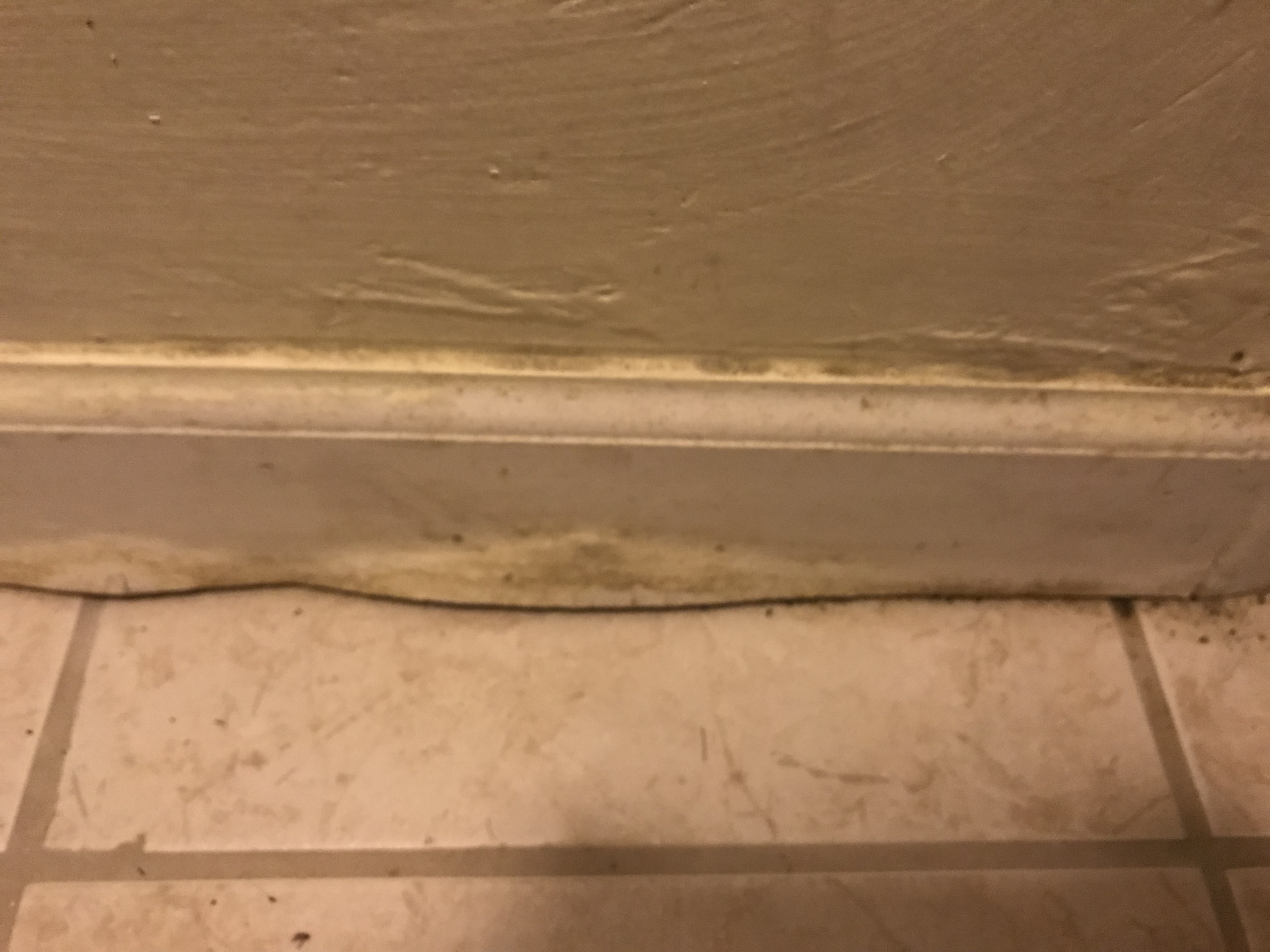

One of my rental properties....
Yeah, its my fault. Years ago, but mine. I never looked for it until I stopped by there today.
Reactions: J Scott W
12,567
Screw loose behind the SX12.
Seriously, had to strip off layers of vct finish from prior owner when I bought it in 2003. I just didn’t pay attention. Will be replacing these and sealing after this oinker moves out.
Not easy to confess, but a cautionary tale for cleaners who ignore the issue.
