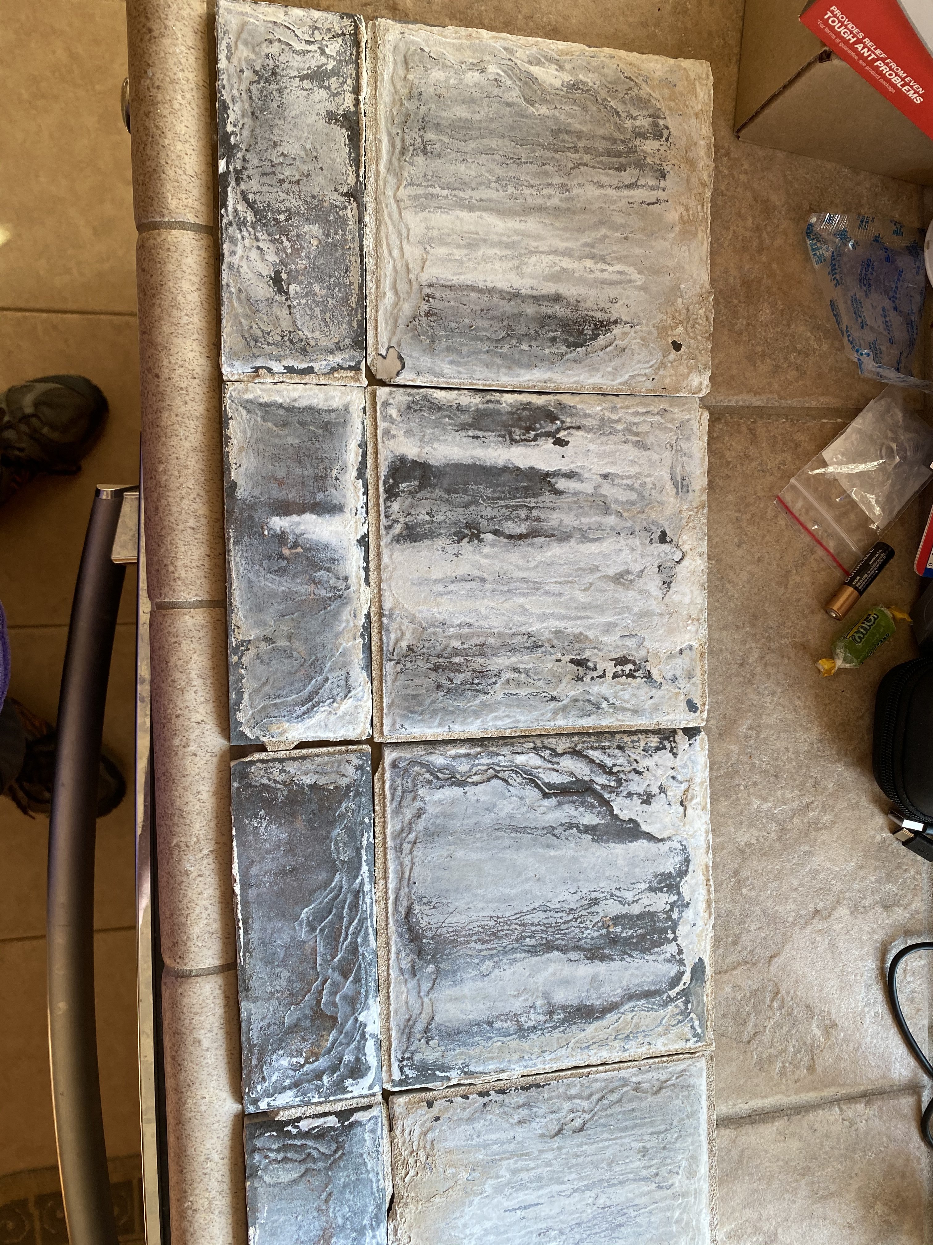

Today I’m repairing my pool. Some tiles under the waterfall came off. Before I put them back, how do I clean them up? Soak in muriatic acid?

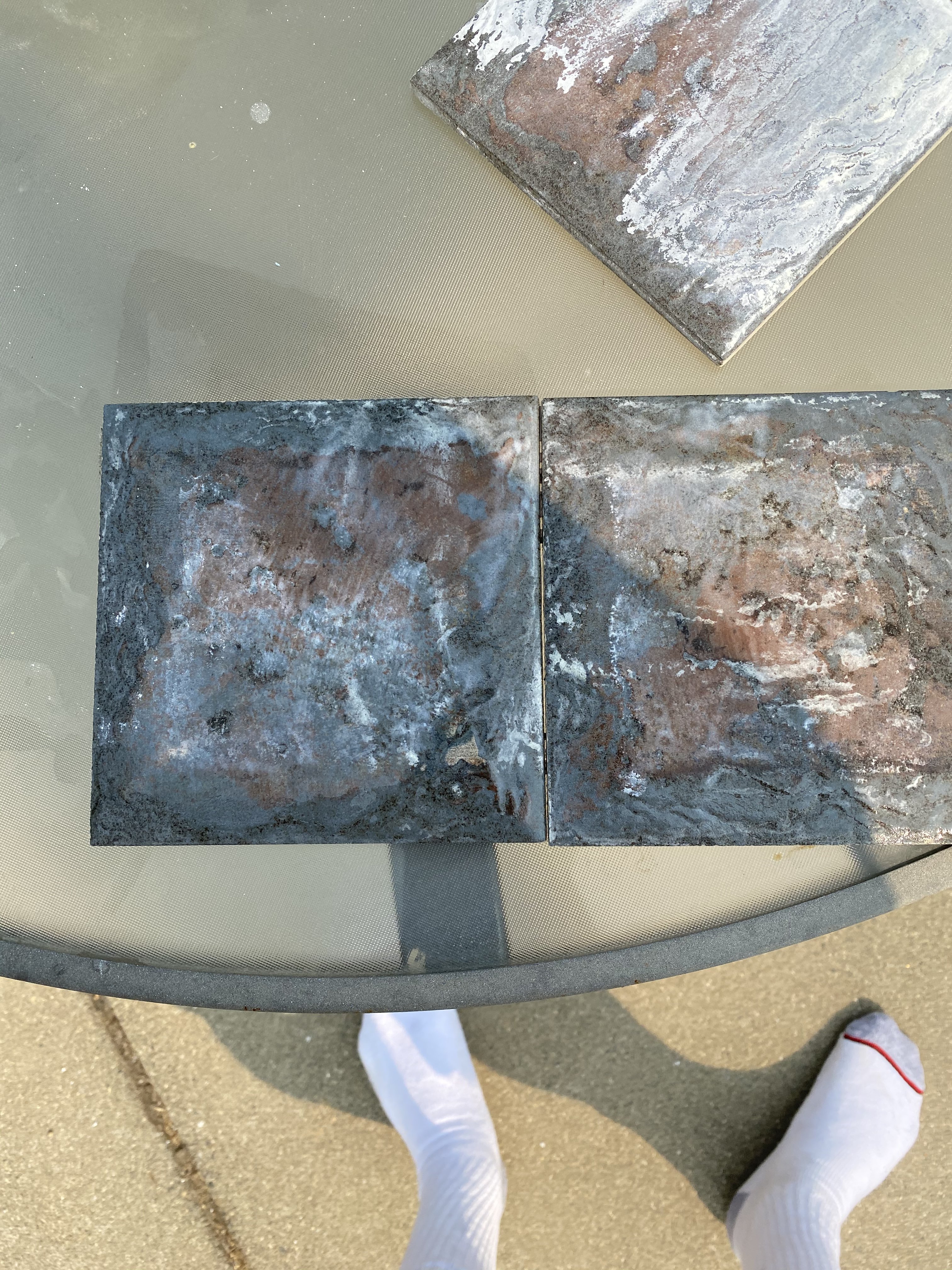

They’re getting better but not perfect yet. I soaked the tiles overnight in the acid. It ate through a bit of the deposits but not all. I’ll soak them in CLR next.
What I’ve learned so far. Muriatic acid is some nasty stuff. Wear breathing and skin protection. Also I learned this stuff is great for releasing grout. It made all the grout turn into sand and just fall apart off the tile. So, if you guys have a job with porcelain tile with grout haze everywhere, clean it with muriatic acid. Wear protection and ventilation is a must.

Isnt CLR just sulphamic (sp?) acid? How strong did you mix your MA? Maybe mix lil bit stronger
