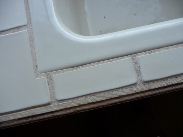

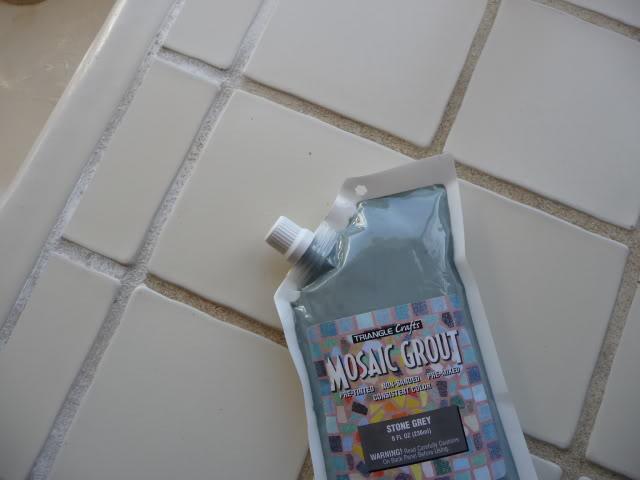

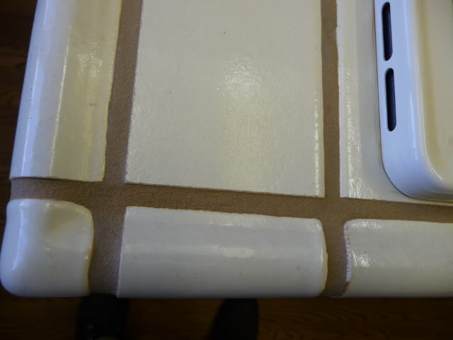

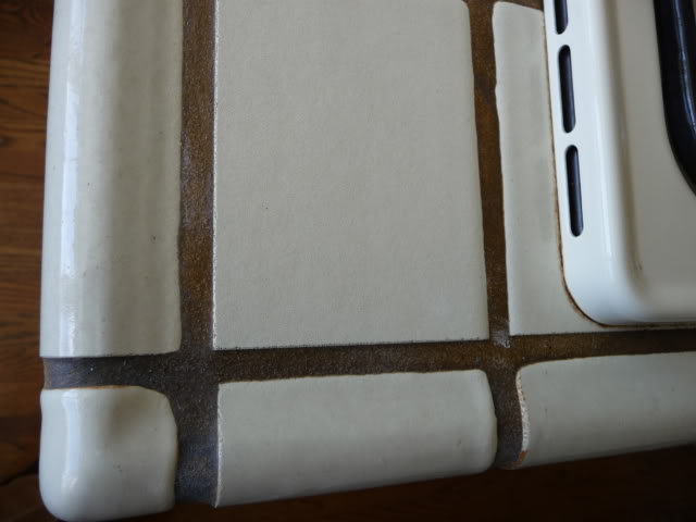

This lady though using some premix grout to cover her stained counter top.
Not only did she goop it up real bad but she used the wrong color.

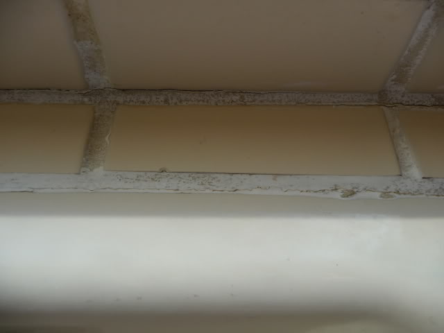

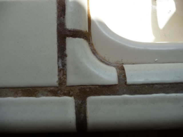

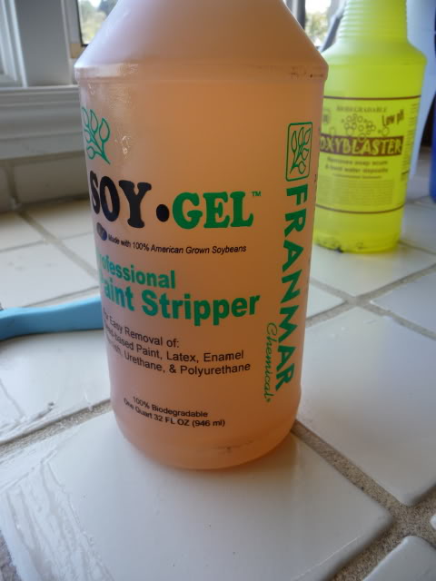

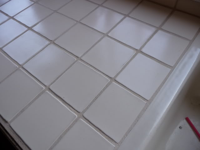

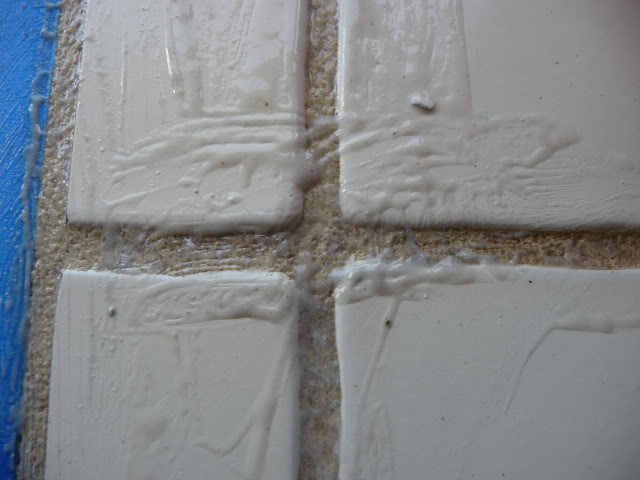

I used Franmar Soy Gel stripper. Nice safe stuff. No odour and not skin burns.

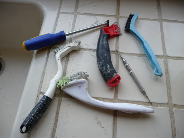

and a few tools..

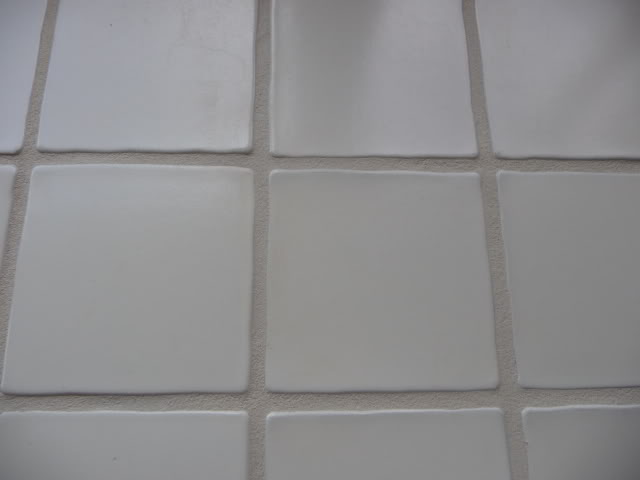

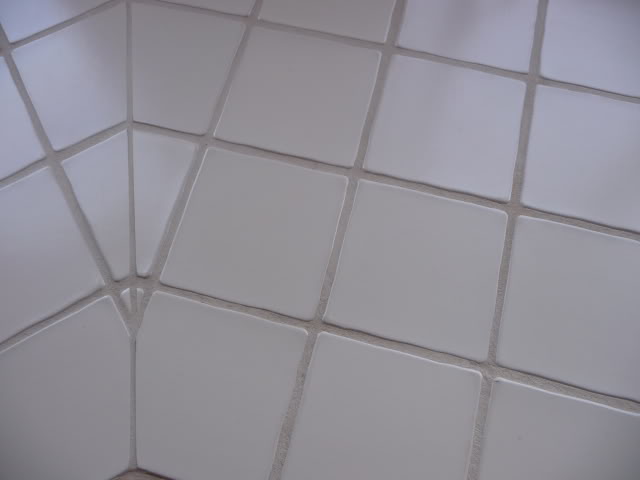

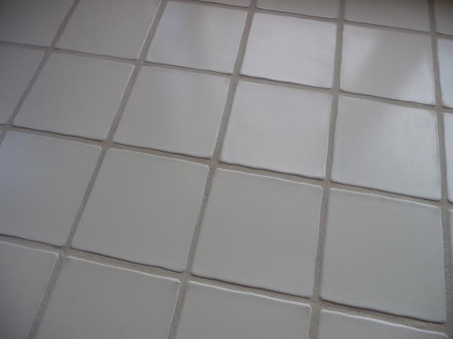

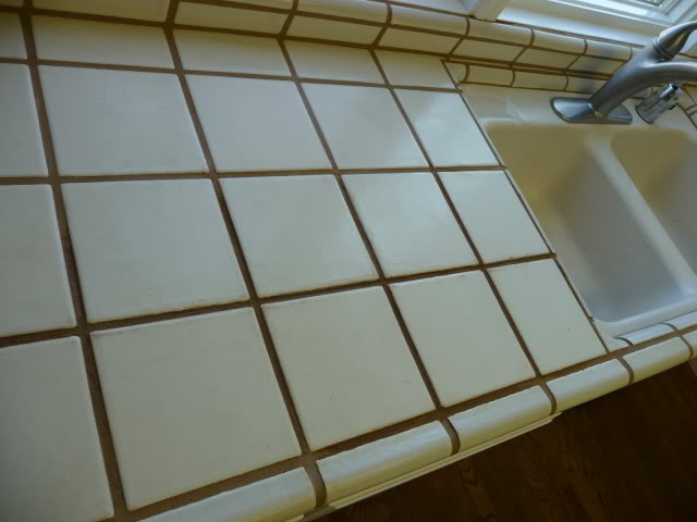

Power washed it off, color sealed it with Grout Perfect and voila!

Have you ever used that Soy Gel stripper before? And is that a Magic Wand product I see in the background there? :shock:

Hey Molley,its me again,I was just wondering,did you have to use all the tools,or could you have gotten away with a strong batch of that acid?Its OK if you didnt Mike cause I know you gotta pay for that baby in the driveway. :D

Do you always use those dental instruments. I just realized I have boxes and bags and more boxes of them
that my wife has used/autoclaved/retired over the years. Now I have some Ideas!
