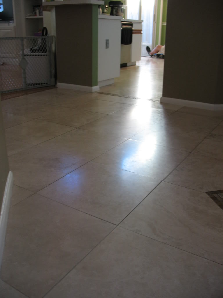

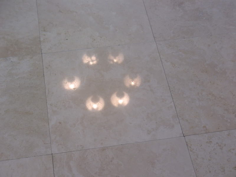

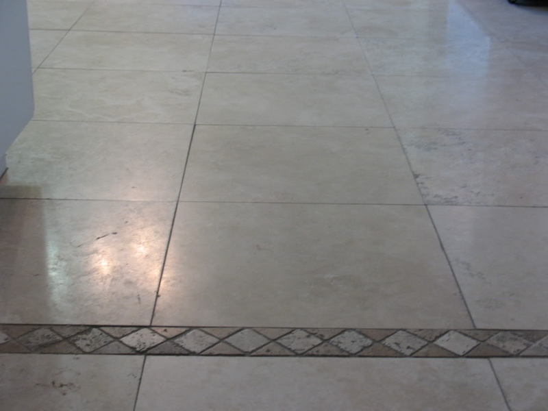

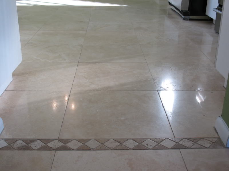

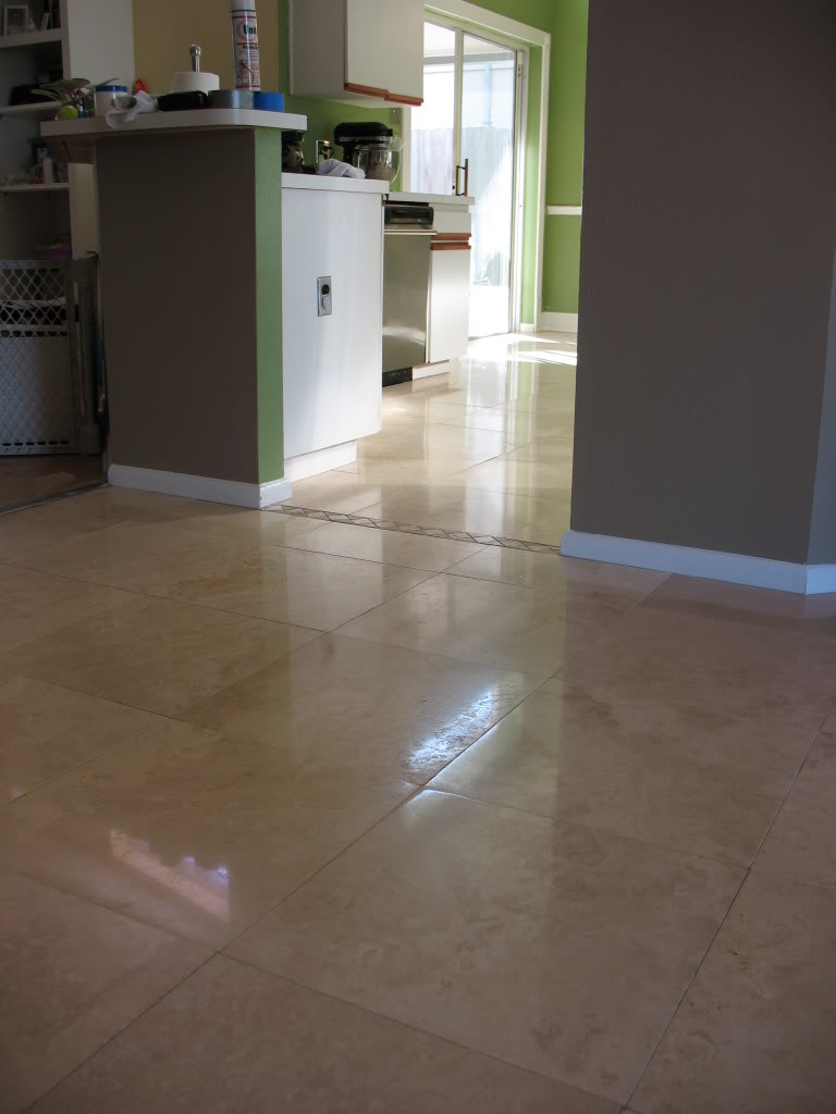

I didn't take any pics actually doing it. I do not own diamonds or even have a 175 to powder polish. This is my first job done with an OP and orbital sander.
Before
after
before
after
Just bought them this week, and went to work. Even filled some holes, no pics of that as I forgot. Not perfect, but maybe I will be half as good as my teacher one day.

Pretty good there Bryan. Looks like you got rid of the "orange peel" and replaced it with a nice smooth polish.
boazcan
Jan 11, 2007
1,522
Tampa Bay/Central Florida
Bryan C
Thanks Mark. Good to have you over here. You will be a great asset in the Hard Surface area for sure. Looking forward to your advice and comments.
There was a slight orange peel look but minimal. It came out pretty nice.

Very nice job for working with a fiber based diamond. I’ve also been doing some testing and in some applications they’ve been working pretty well. What grits did you use, how long did it take and how many square feet was it? Also – most importantly – who’s sexy leg is that? No just kidding, can you try reposting that last picture, it looks like only the top of it posted and I was hoping to compare the bottom part with the before picture? Thanks.
