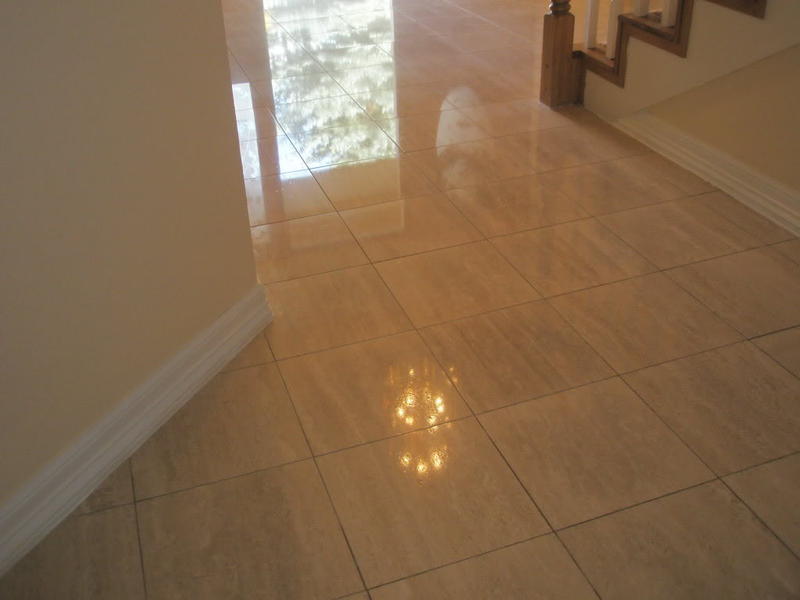

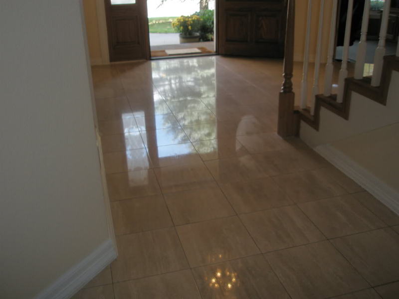

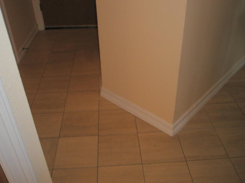

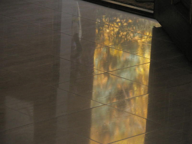

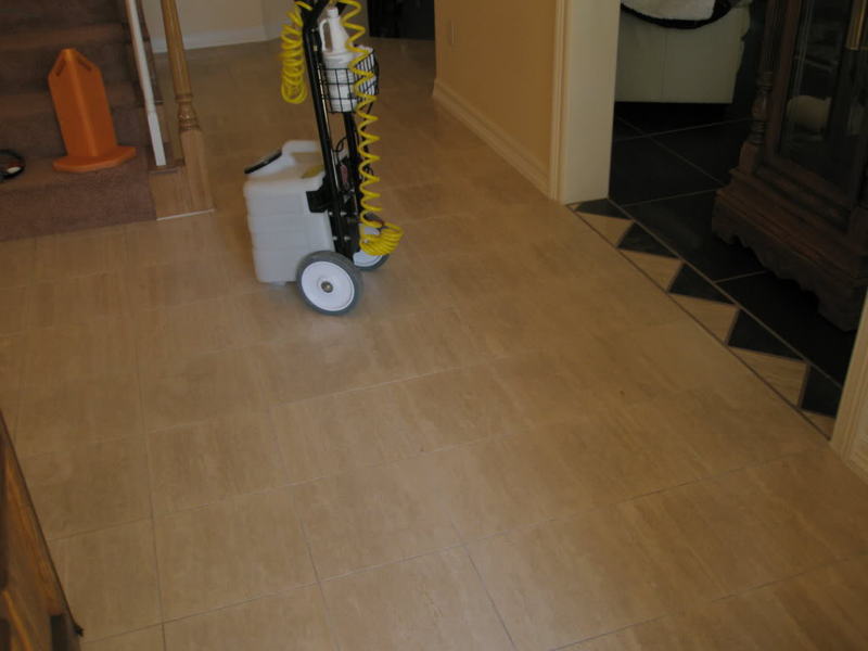

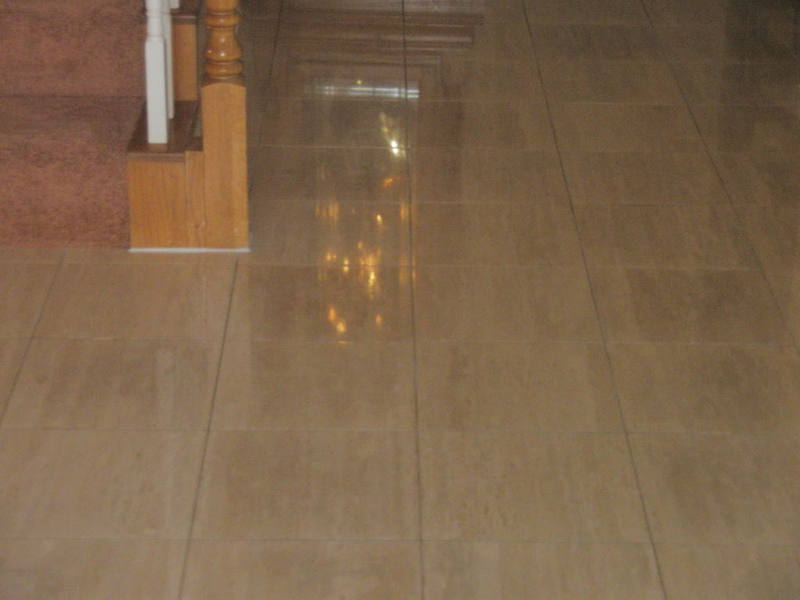

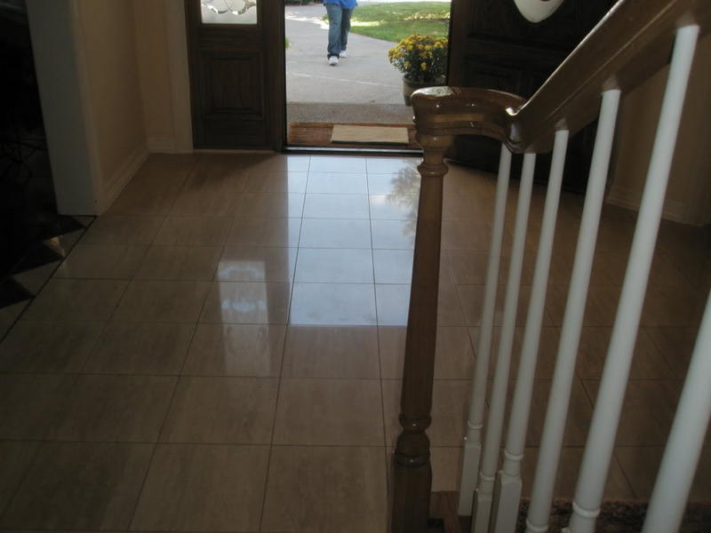

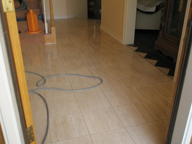

Nov 3, 2008 #1 Ron Lippold RIP Joined Nov 8, 2006 Messages 3,373 Location Albuquerque Name Ron lippold It just keeps getting easier Before after

Nov 3, 2008 #4 TimP Member Joined May 19, 2007 Messages 4,055 Looks like that one was done by a pro before to not have any lipage like that. You did a good job shining it up....however I think that's an ugly floor.

Nov 3, 2008 #13 P Phoenix Phil Guest Nice work! I see your fine new Mytee sprayer! How's the sprayer working?
Nov 4, 2008 #14 floorguy Supportive Member Joined Nov 7, 2006 Messages 6,948 Location Utah Name Doug Not to down grade the job.... but why are all the before pics not in a lighted area??? Either from above or a door open?? Because all the after pics have lights shining on them...
