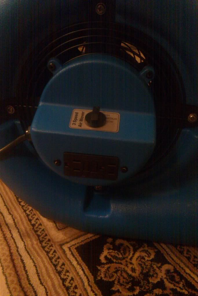

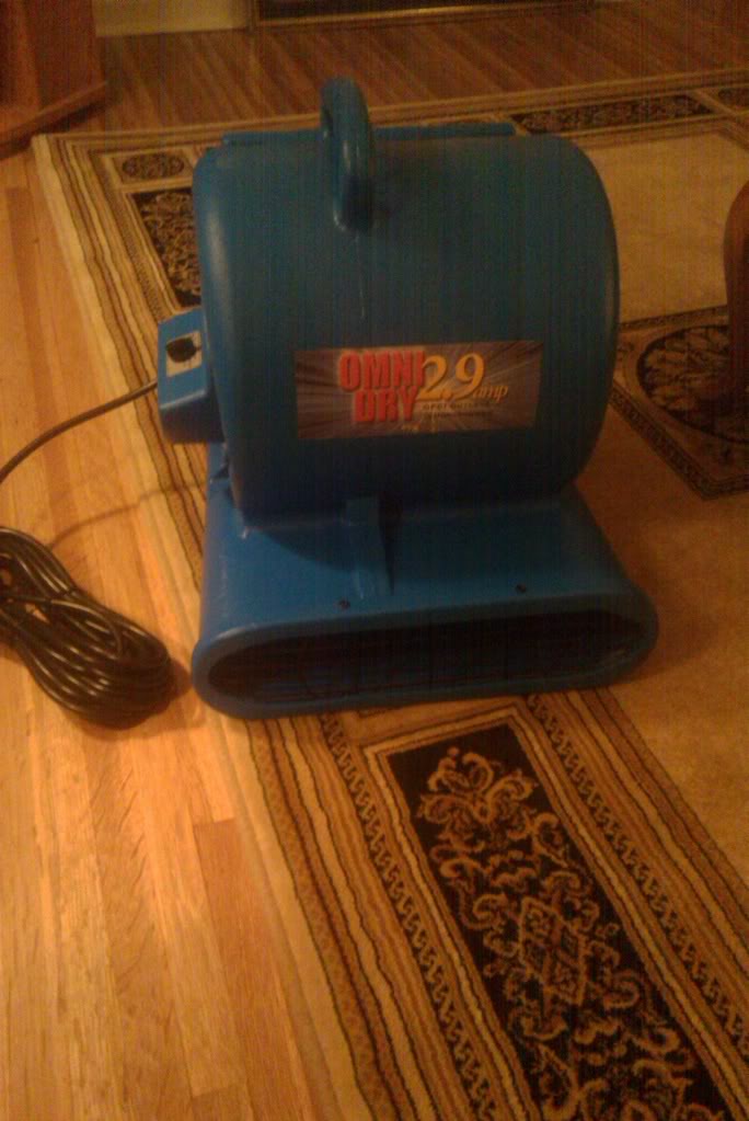

I like my new air movers. I picked up 10 for 169 each with free shipping. They only draw 2.9 amps and can be linked together. They are also half the weight of my other air movers, smaller, and more than enough cfm. I am more inclined to take a few of these in on residential jobs than a 50 pound blower.
